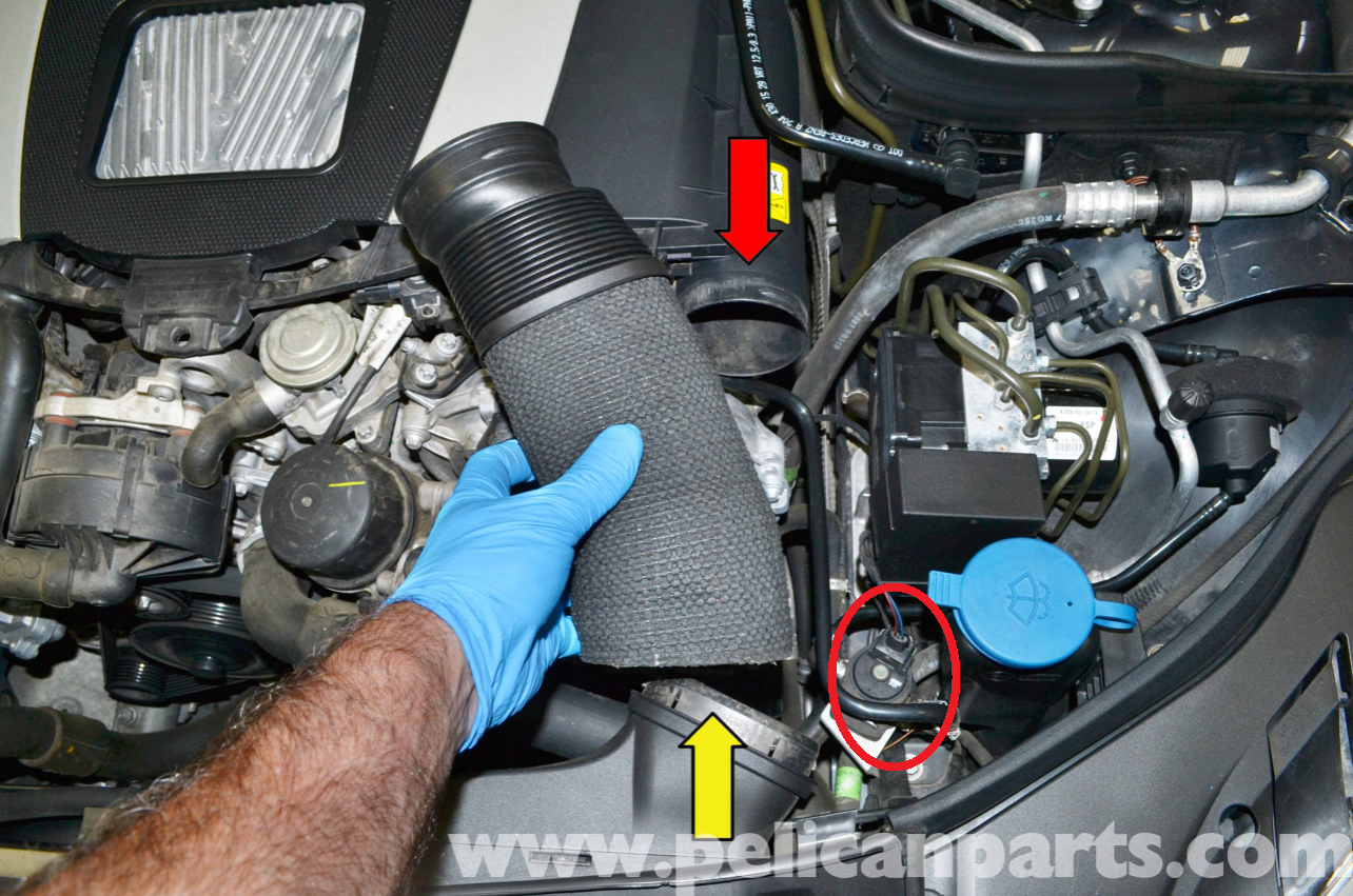

and there is also another clicking valve next to driver side headlight that clicks all the time. wtf lol why is everything clicking everywhere. it drives me nuts

Behind the drivers headlight is the purge valve (circled in red) on some engines. This makes a clicking noise when it is operating, so it means it is working and nothing bad. If it wasnt ticking you would have an issue. It should start ticking shortly after starting the car.
