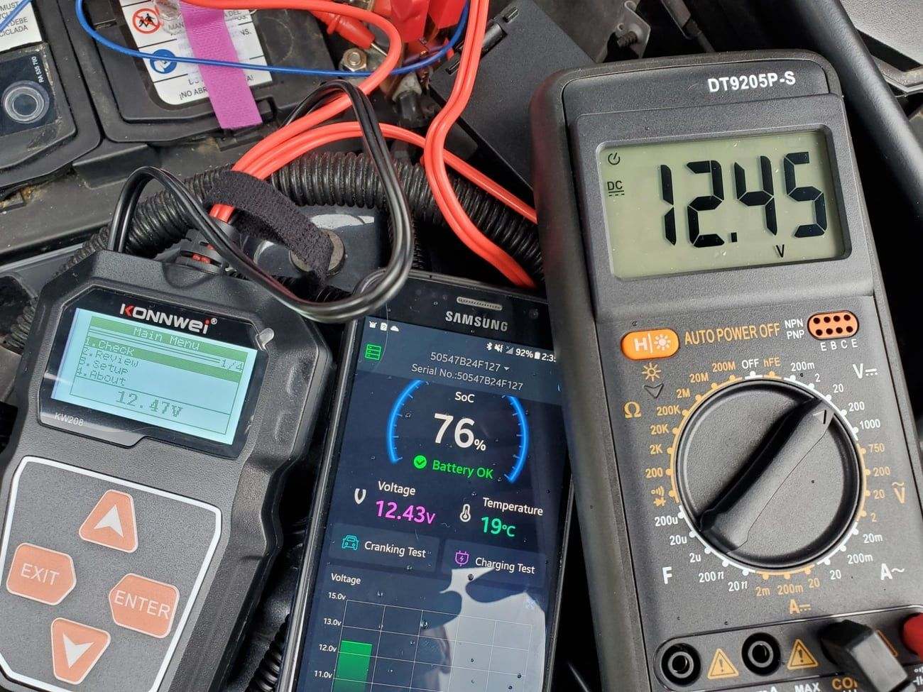

Ok guys so this was very odd. I brought a multimeter as well as a booster pump to see if the battery would go ahead and give me the specification voltage. It would read 12V which meant it isn’t fully charged but at least 90 percent capacity. Yesterday I went ahead and just bought a new battery for the sake of elimination process. The car in fact turned on and running good.

Yes sir, I did the exact same procedure as given in the pictures as well as your instructions. Interestingly enough the battery would read me 12V when connected to the battery tester yet as soon as the tester was disconnected no signs of life from the car. I honestly just thought of going ahead and buying a new battery and sure enough the car turned back on… the headlight though is not turning on yet- I’ll be taking off again and check the factory harness pin points for current see if maybe the harness itself is done. I’ll update you guys on this as well !! Thank you guys I appreciate your suggestions !!

The instructions with the battery testers I have say to turn the headlights on for a a few seconds prior to testing. This will get rid of any surface charge.
