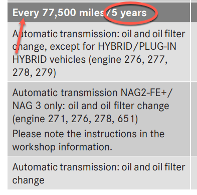

If mileage and time duration are both given, then by definition, you use whichever one occurs first. For example, brake fluid change is recommended at two years with no mileage specified. The two-year interval is pretty much universal because of the tendency for brake fluid to absorb moisture (water) which leads to corrosion. To give you a reference, see below.

Do what you want, but every 5 years means every 5 years. Apparently, fluids degrade with time once they are installed in the vehicle.
Page 18 of the attached document.

Side note - This is why the MB maintenance guides are ridiculously confusing. If you follow that chart literally (the one you included above) notice the box is not checked (a dot actually) for the transmission service. So the 2015 service booklet is literally saying you don't ever need to change your ATF for any 2015 C-class. (And that 2015 booklet doesn't even distinguish anywhere between a W204 Coupe and W205). But if you look at a 2014 maintenance manual, it says 70,000 miles/7years for C-class W204/M271 vehicle. But apparently my vehicle computer must have been using a 5 year interval.
Again TLDR - a good interval for the blue fluid ATF (and filter) is 50k-60k miles. The "official" interval is 70k-77.5k miles.
