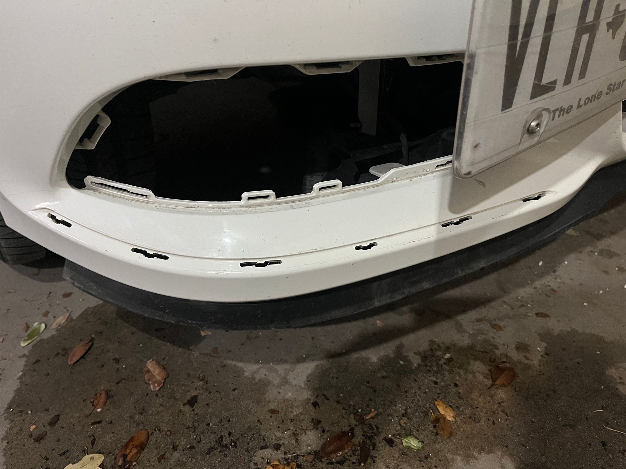

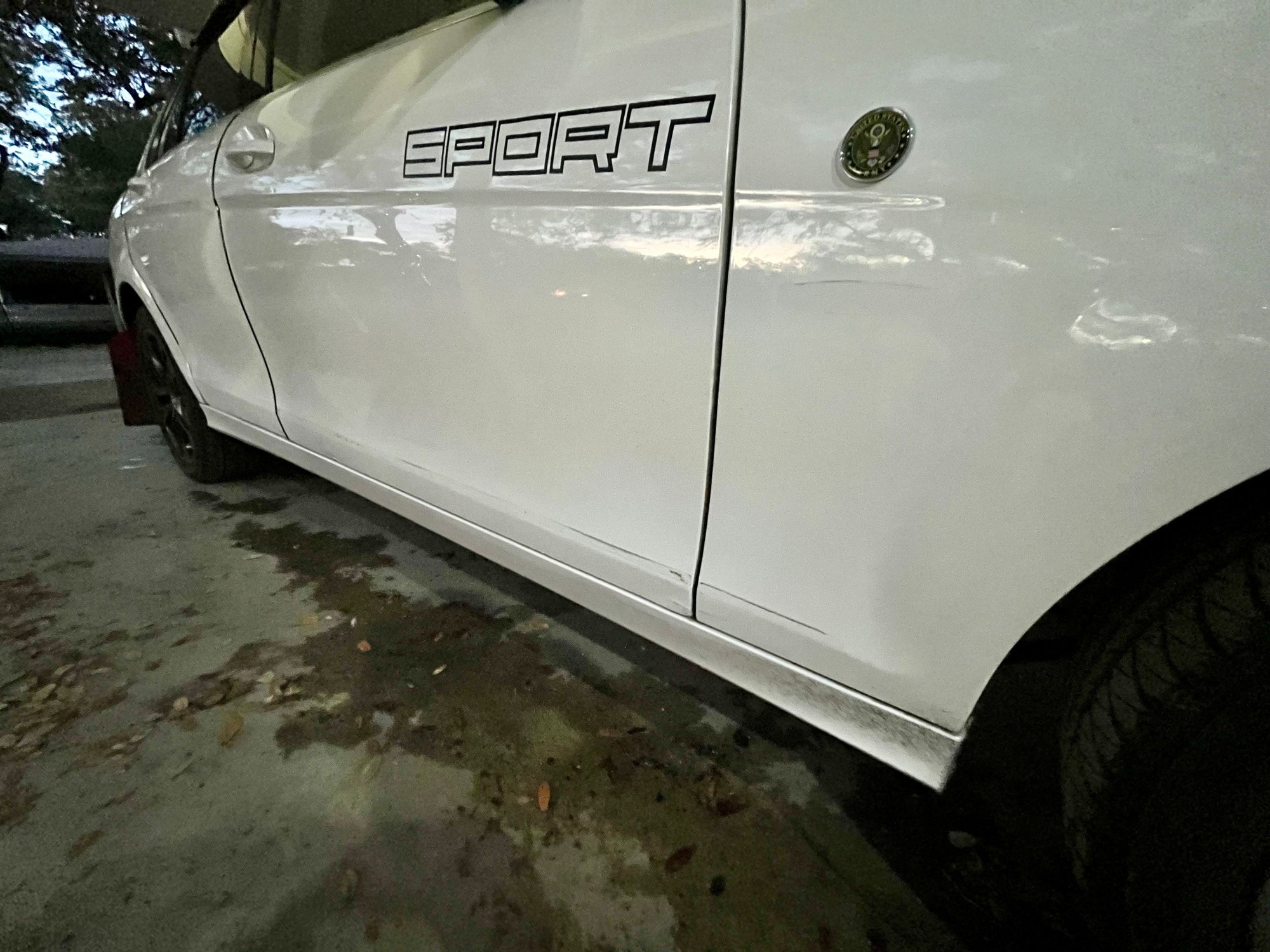

If you're curious if it's okay to remove those annoying chromes all over your W204, you CAN! The side strips/liners along the doors are just adhesives or glue, just use a plastic pry tool (what I used) & slowly force it off your car. The strips in front/rear are attached by built-in tabs behind it so use two pry tools to slowly pry from a corner, & then use the other to pull the strip that'll reveal the tab plugged into the car (there's at least 3x tabs). Finally, if you have Goo Gone, a micro-fabric cloth, & patience, you'll need to put some "elbow grease" to remove all the left over adhesives/dirt. Good luck! Look at my pics for proof.

*Correction: 6x tabs!
