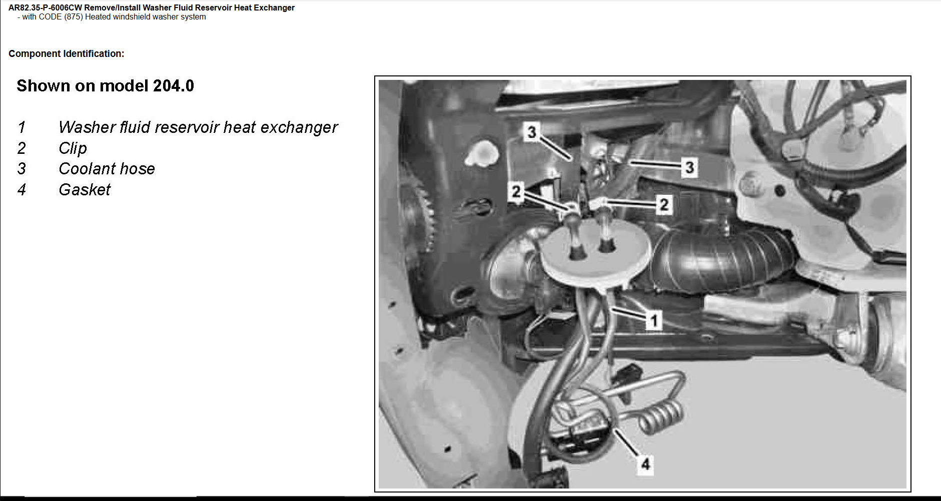

I know with option code 875 Heated Windshield Washing System there are small heating elements at the wiper nozzles but the wiring runs along the hose on the outside, not inside the hose.
Im not sure what those wires are. The heating element that heats the fluid is a large metal coil with coolant flowing through it in the reservoir.

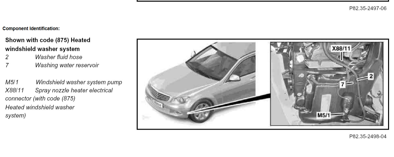

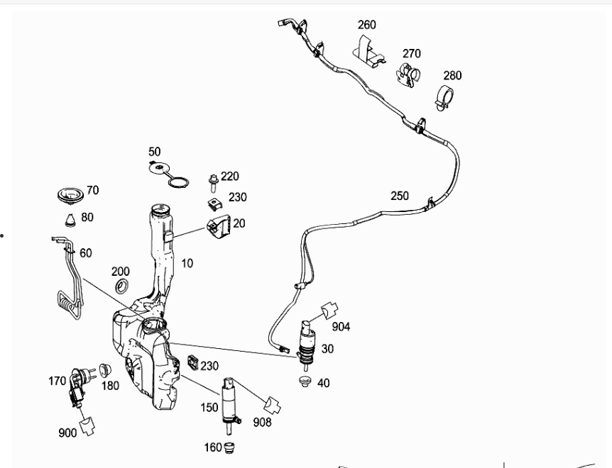

Whats your vin? Maybe you have a different type nozzle system. Heres a 204.054 parts diagram, shows the hose then the wiring separate.
Where does the other end of that hose connect to, the reservoir?

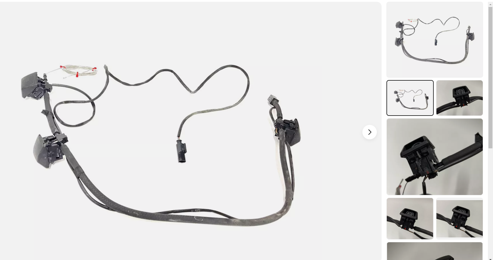

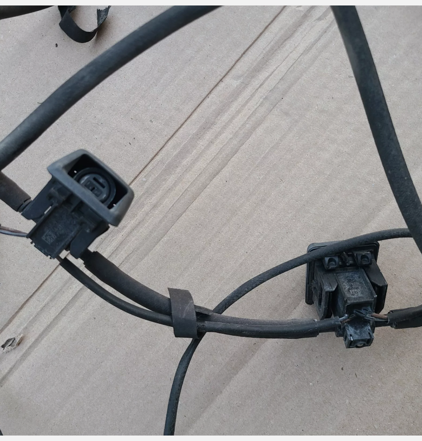

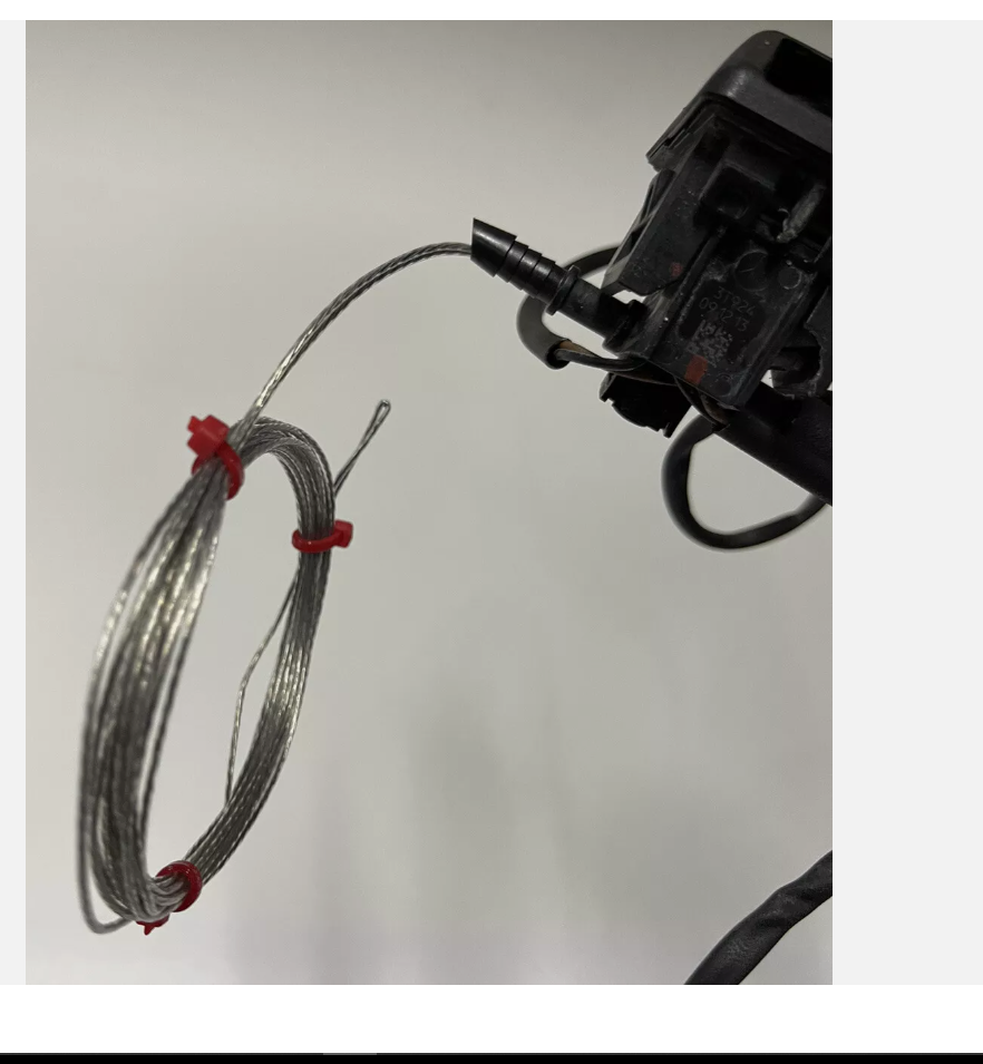

I searched around online for "Mercedes washer fluid hose with wire" and came up with some info. Im guessing that wire is part of the heating for inside the hose.
