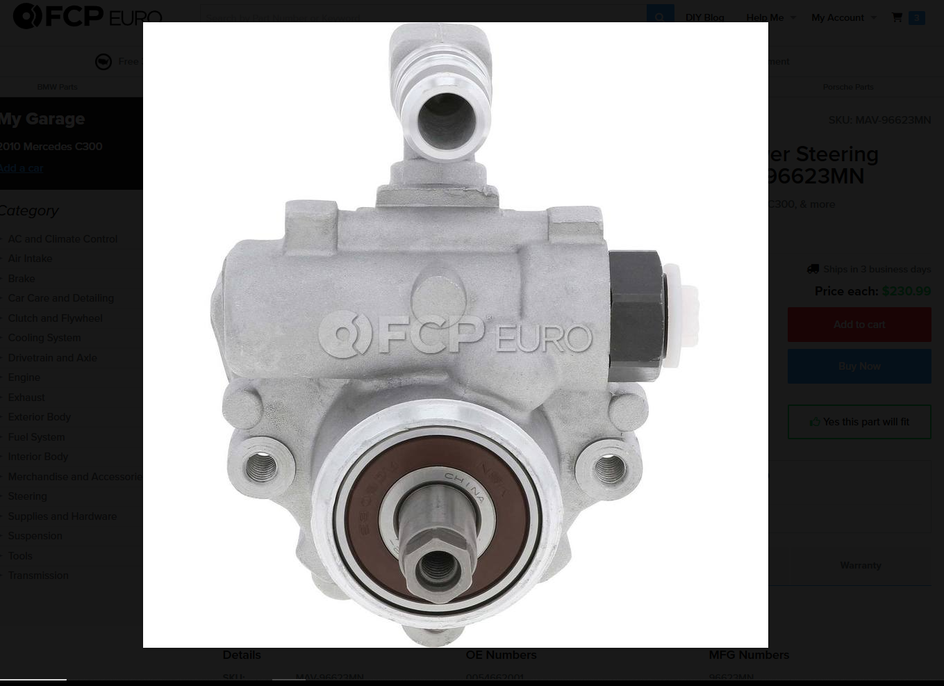

Found a photo of a power steering pump without the pulley on it. Looks like the bearing is pressed into the pump itself.
Alternator pulley/clutch removal is in the manual under Starting and Charging>Alternator.
