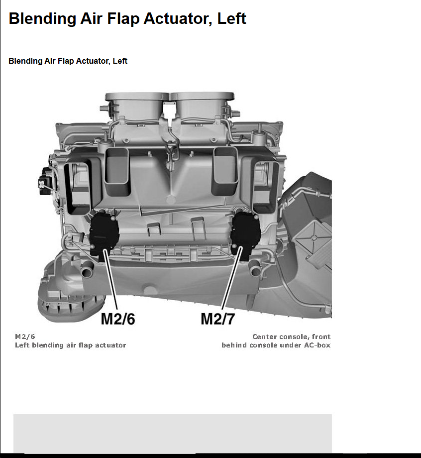

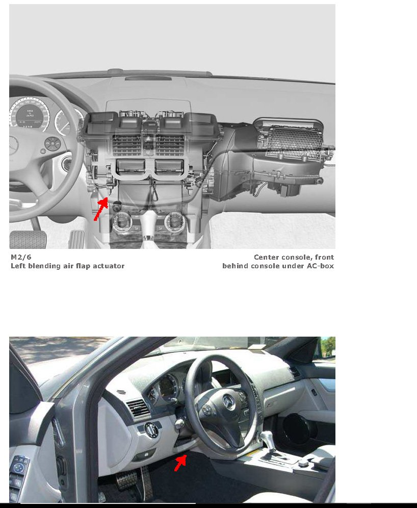

Maybe one of the air flaps is staying open. I would scan the car and see if any specific codes pop up leading you in the right direction.
Maybe the blend air flap motor? Im speculating.
