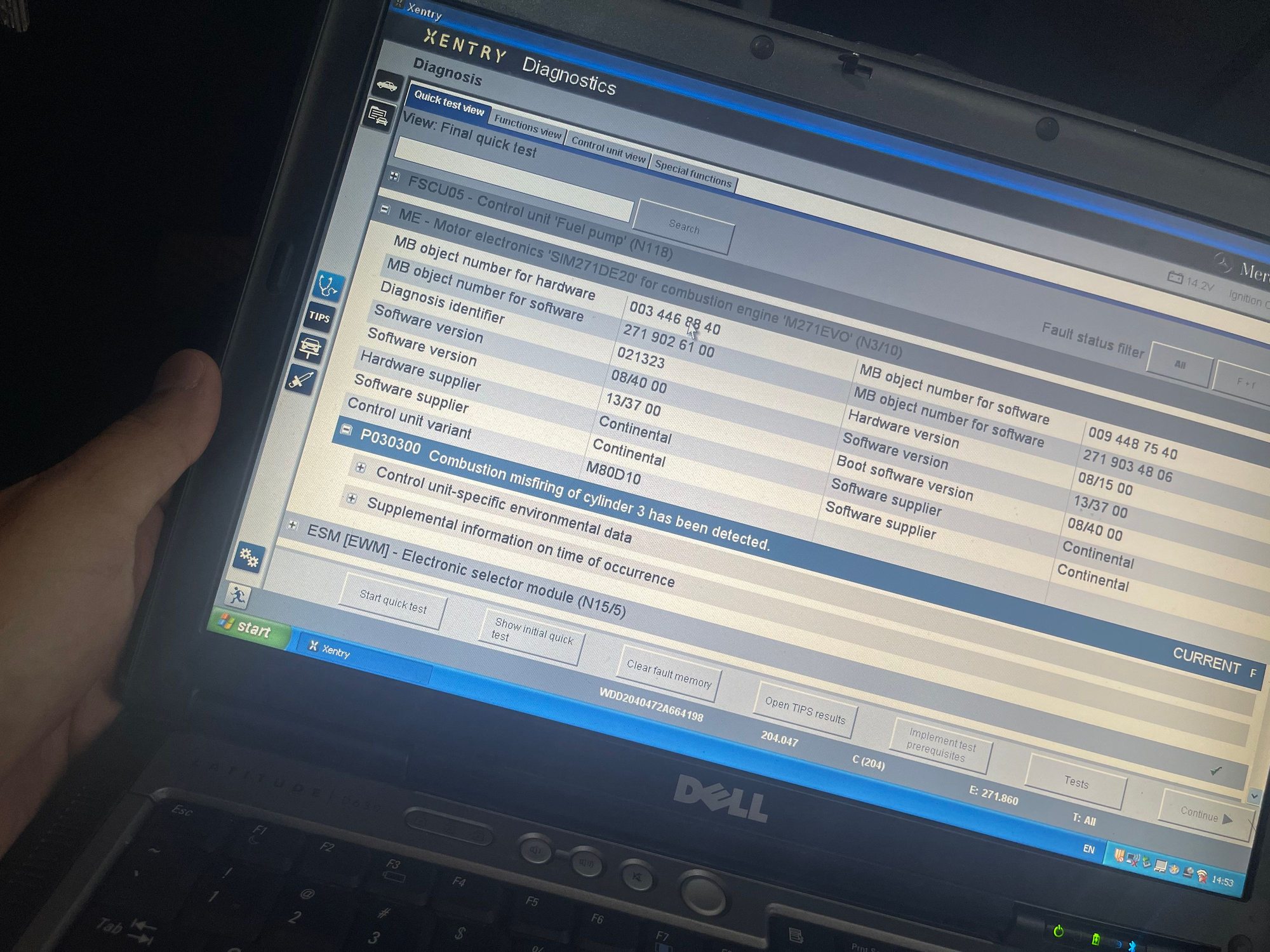

Attached
VIN: WDD2040472A664198
Originally Posted by JettaRed
I cannot find any DTC 415000 in XENTRY under motor electronics (ME), your fuel pump (FSCU), or parking (PTS). Of course, without your VIN or full model number, I could be looking at the wrong car. Are you sure that is the code?

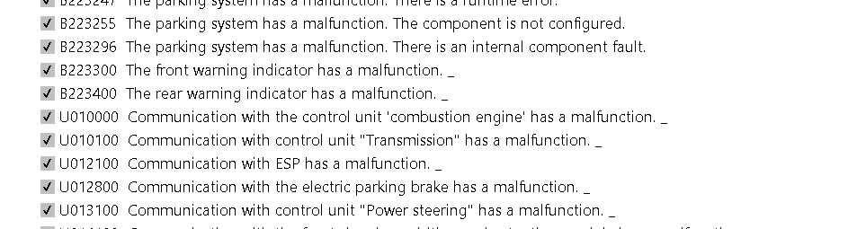

Is this correct?

Interesting, there is no fault for the PTS listed as C41500 in XENTRY Simulation mode. It skips from "B" (body) codes to "U" (network & vehicle integration) codes. There are no "C" (chassis) codes.
The problem does seem to be with the ESP module. But there is not trouble code there either.

Since your misfire seems to be limited to Cylinder 3, I would focus on trying to solve that problem first. Look at the info under the P030300 code. The supplemental information may provide a clue. Otherwise, I would first move the coil and then the spark plug to see if the problem moves or stays on cylinder 3.

happens on cylinder 2 too. I can put up pdf data here after a scan if that helps.
have tried the moving of the coils and plugs even put brand new ones in but no luck in solving this
