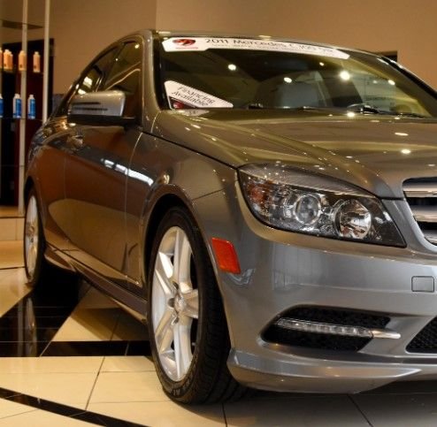

The bumper has to be removed for a respray and I always liked the dark housing headlights (similar to a prefacelift C63 AMG) that were introduced for the US market only between 2010-2011 (Sport Package AMG models), see attached image for information.
I was wondering if I could install these on my car and whether any modifications to the harness or the front SAM coding would be required. Has anyone fitted W204 US halogen headlights on an EU car or vice versa?
The headlights look identical, the only visible difference is the background colour.

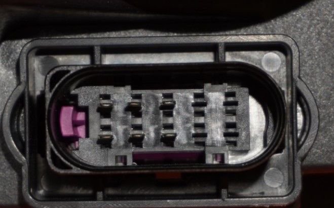

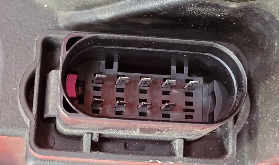

I have also noticed that the US headlight sockets have 6 pins while the EU ones 9 pins. Does anyone know why? The part number of the harness seems to be identical (and the socket shape seems identical too). Refer to image below for information (US socket top - EU socket bottom).

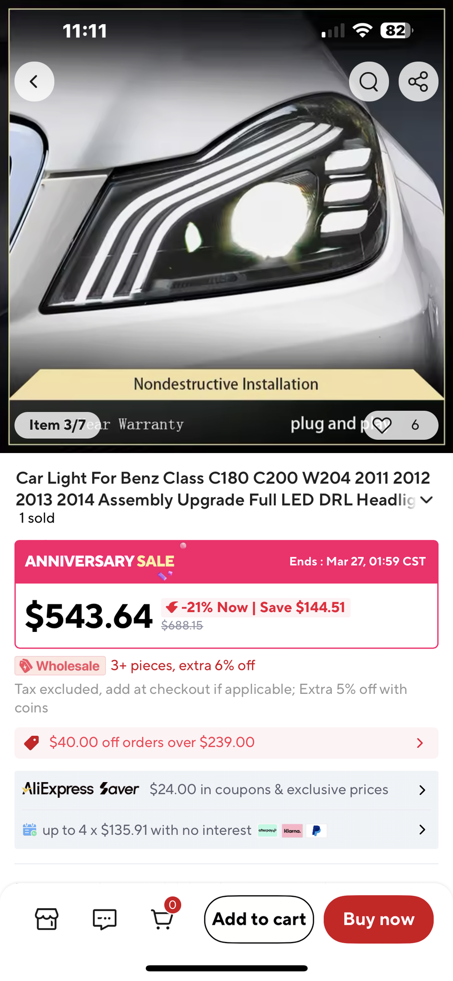

I would suggest you get aftermarket headlights maybe. I have these and they are beautiful. Butt they have many others.
I just found this on AliExpress: $688.15 | Car Light For Benz Class C180 C200 W204 2011 2012 2013 2014 Assembly Upgrade Full LED DRL Headlight Automotive Accessories
https://a.aliexpress.com/_mtDyC0R

The number of pins in the connector goes with the number of features in the headlight module. A wiring diagram may be available in the WIS for this.
Your VIN and the VIN of the donor car would be needed to get the specifics, however:
-Some have auto dimming;
-Some change aim when oncoming traffic is detected;
​​​​-Some turn when cornering;
-Some may adjust aim when the car is loaded.

Thank you for responding. These particular headlights are the bog standard ones without any of the features mentioned above. The bi-xenon ones have these features and these would require a significant amount of work (so not even thinking about it).
My EU car that has the basic headlights has 9 pins while the US car (which I believe has the 'basic' headlight but with the black surround) has 6 pins and cannot really understand why.
Unfortunately, I do not have access to WIS but can provide my VIN and the one of a US car with those headlights if someone is willing to download these diagrams and shed some light on why there is a difference in the wiring.

Please watch the video linked below at around 4:50 onwards. You will see that the harness has 9 wires but the headlight only has 6 pins:
You can also take a look at this eBay listing for the number of pins on the US headlight (EU/UK headlights have 9 pins, matching the number of wires of the harness...):
https://www.ebay.com/itm/326481909102?_skw=2009+Mercedes-Benz+C350&itmmeta=01JPKAGS49NQ3TAZDDP6AE7SVK&hash= item4c03d6956e:gN4AAeSwL61n0GJn&itmprp=enc%3AAQA KAAAA8MHg7L1Zz0LA5DYYmRTS30mKNBjQS7qsa%2B5OL2hAPml P1A%2Byd%2FxmIg4yiU%2FN9BhoBOUyE%2FNJ5LxoZV2jkbFek kLM0C%2BJrBU0ah8hDKB0t4KwNq5m8W%2BsH2wlJDzKOPzoIUC 4x8TdR1L8ZAgdmzIy7VRlobDmhFFRc1eCgidGXCLddIzw1s17l z8EhP7eICD3Eh9nSzYU90L1dprTJ%2BMAlW9gE1c%2FPjQHa1T PdasRYn7vWZVvOOPxiOPOHmnfz2D8GOc9%2FxMIz6t7oIhHf5z aHAjqm6EZitDXDq4rv5YWLY2j4QjOfTMWxm8BxSp0Xi8x%2FQ% 3D%3D%7Ctkp%3ABFBMopLD6rRl

An update on this after reviewing the wiring diagrams provided by TimC300.
The US version of the W204 does not have an electric headlight adjustment function like the EU cars do. See image below for info:
That is what the additional 3 pins do.
Not sure why this is not offered on US cars as I do believe it is quite useful when the car is fully loaded.
In summary, the swap is not possible if someone wants to ensure the headlights are fully functional.
