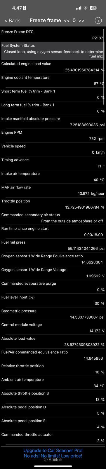

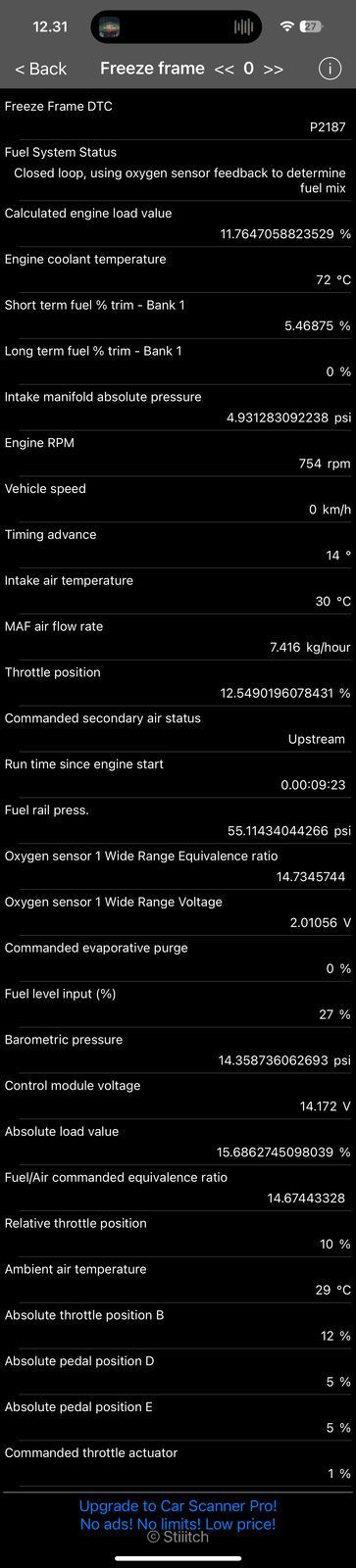

Here’s the freeze frame data from the latest scan:
  • Short-term fuel trim (STFT): 5.47%
  • Long-term fuel trim (LTFT): 0%
  • Intake manifold absolute pressure (MAP): 4.93 psi
  • MAF air flow rate: 7.41 kg/h
  • Throttle position: 12.5%
  • O2 Sensor 1 Wide Range Voltage: 2.01V
  • O2 Sensor 1 Equivalence Ratio: 14.73
  • Fuel rail pressure: 55.1 psi
