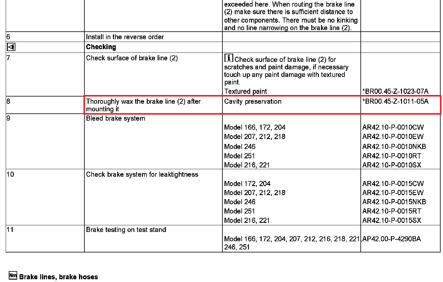

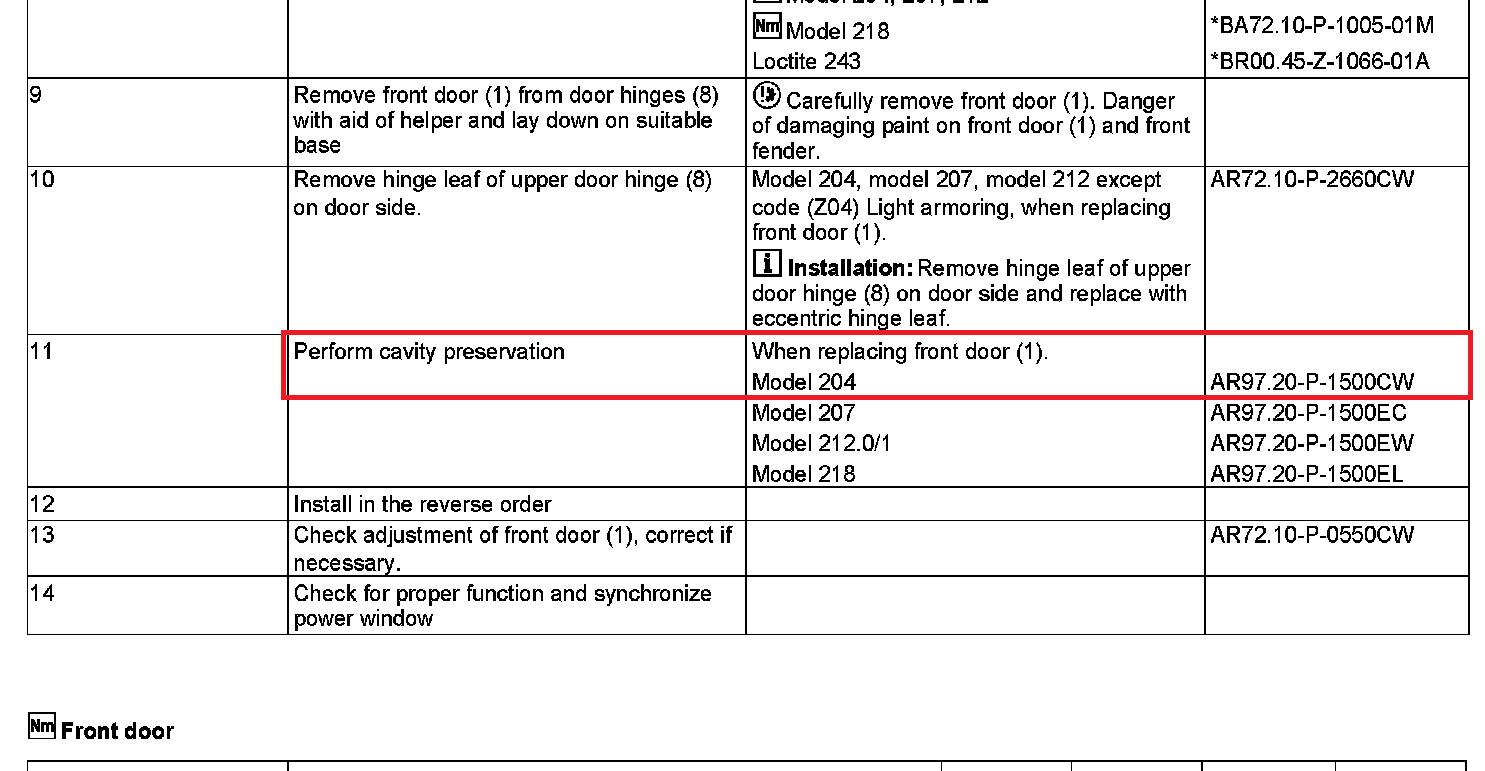

In the manual there is a procedure for cavity protection in the doors but it says if they have been replaced. I cant seem to find that specific AR97.20-P-1500CW procedure they mention. Im thinking at the factory they do all the cavity protection. They also mention coating replacement brake lines.

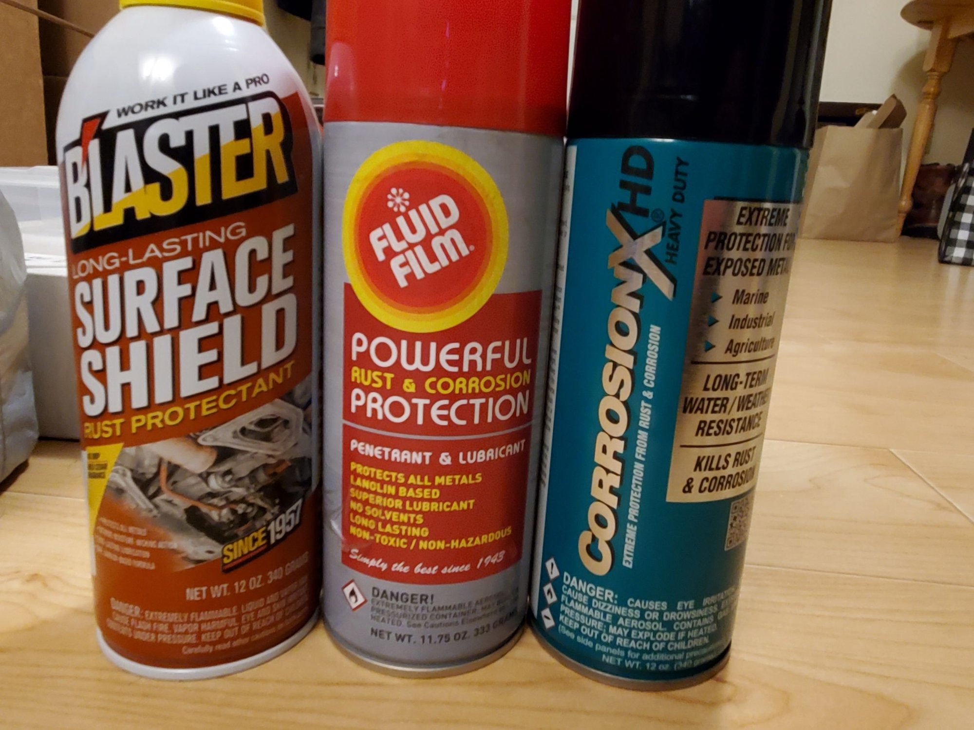

What products are you using? I have tried 3 so far, Fluid Film, Surface Shield and CorrossionX HD. They all seem good except the CorrossionX HD is really thick stuff and probably should have tried the XD instead.
CorrossionX HD on the Transmission pan. Stuff is thick but evens out after awhile.
