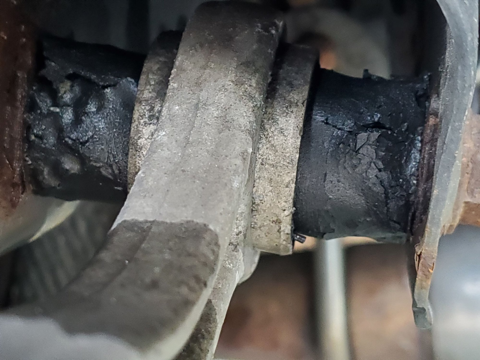

You have a new subframe so those bushings should be fine. You can inspect the 2 bushings in the wheel carrier, for the spring control arm and for the thrust arm. Those bushings on mine are pretty well worn looking, they look expanded and cracking. But the tread wear looks good and car handles fine.
Also inspect the control arms themselves. Few of mine need to be replaced.
