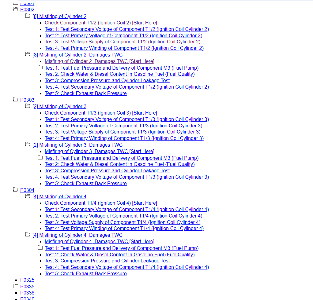

I looked up those codes for the M271 for ideas what it could be:
