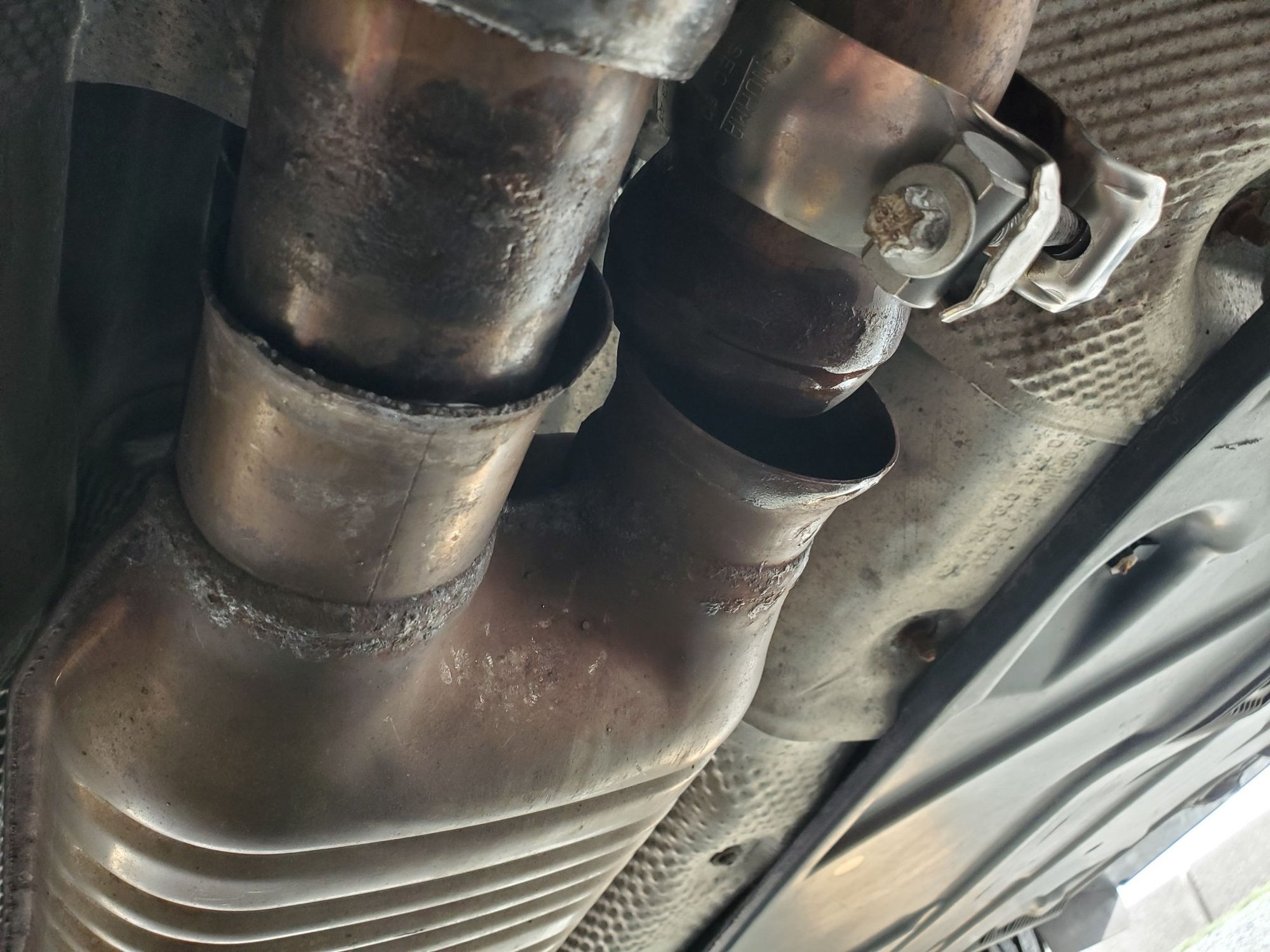

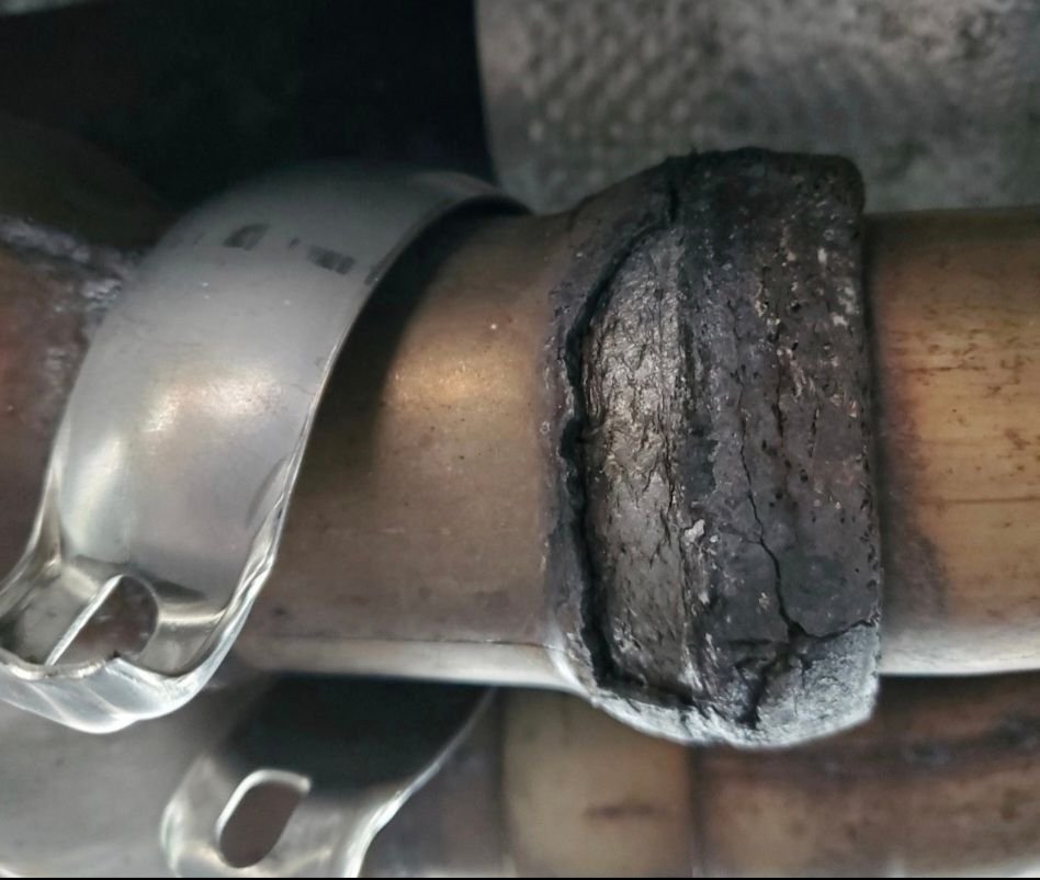

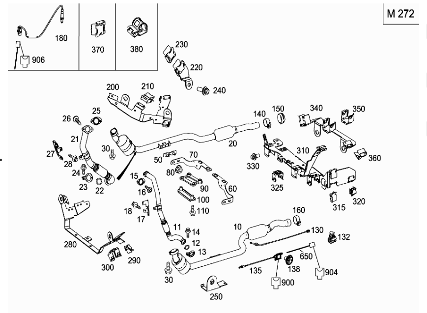

Interesting. From my understanding the exhaust is attached using rubber mounts that should remove all vibrations. Im assuming your exhaust is similar to mine, dual exhaust pipes connected together in the middle at the resonator. The two cat pipes have brackets on them that mount to the TC housing.
I replaced the two clamps leading to the resonator and the clamp attaching the drivers muffler because they were rusted and leaking.
The flange on my passenger side has disintegrated and needs to be replaced. I have seen this same condition on used resonators when searching on ebay for a replacement. Unfortunately MB will only sell the entire section with resonator and passenger muffler for around $950, they dont have just a replacement flange to slide or weld on.
I dont have any abnormal vibrations with my failing exhaust. I've even been under there disconnecting various pieces. I dont see much adjustment being possible.

That is correct. Same setup on my car but rust-free since the weather where I live is mild and no salt is used.
Thank you for posting the photos. They are helpful in visualizing things without having access to the car's undercarriage.
