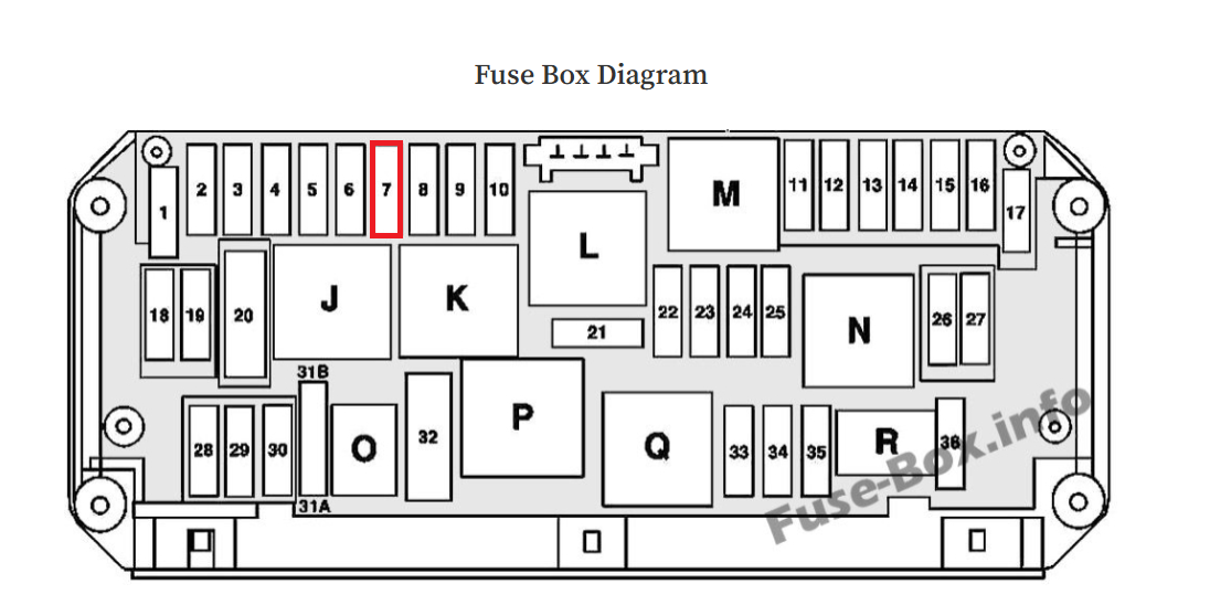

Did it smell like burning/melting electronics or burning oil?

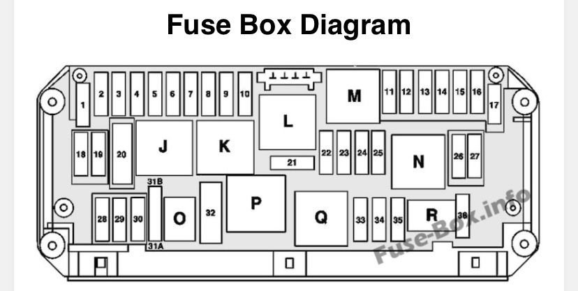

Fuse 7 is the starter fuse in the engine bay. But check them all while in there. https://fuse-box.info/mercedes-benz/...uses-and-relay
If I needed a scanner I would buy one of the Launch scanners.

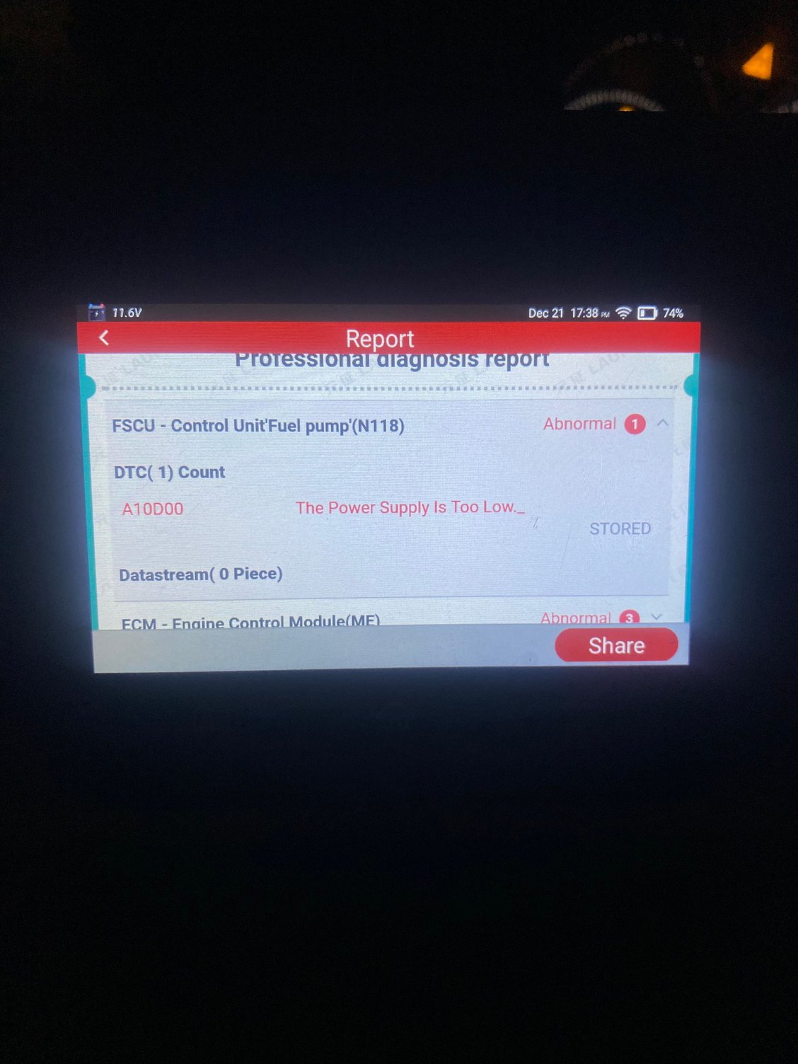

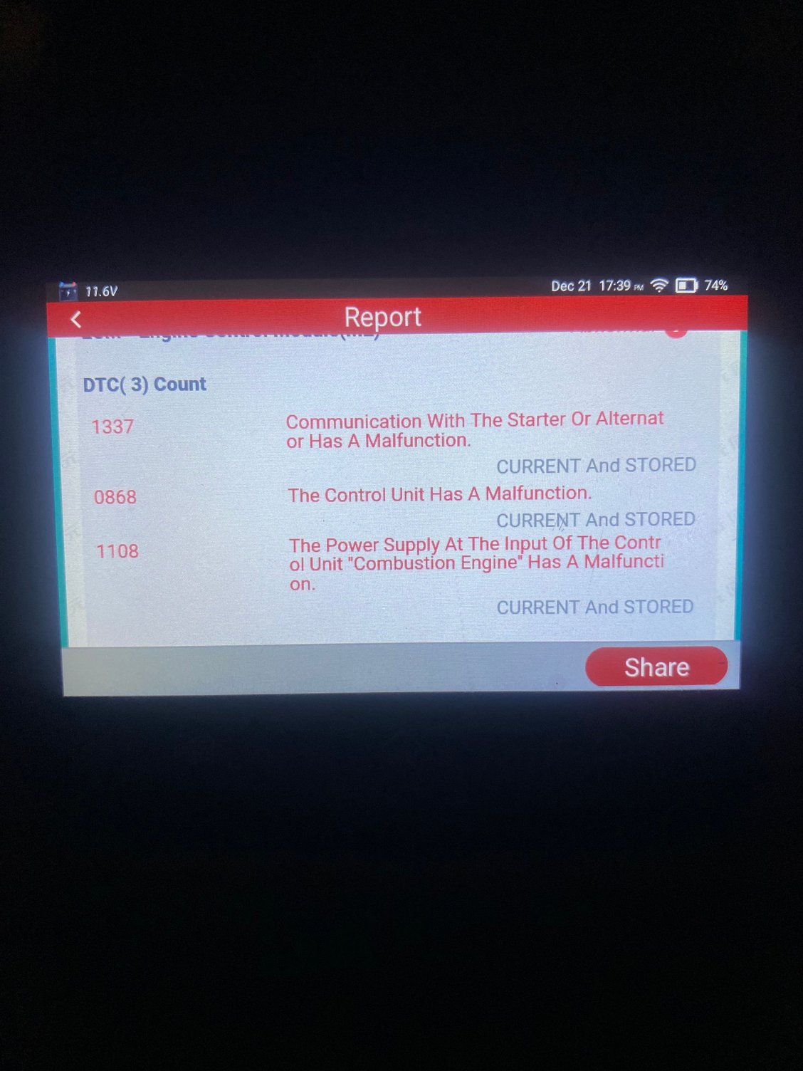

With 11.6Volt that is a low battery charge level.
The first screen showing 3 HARD FAULTS does not show what modules.
The second screen shows fuel code as STORED meaning not current.
So bottom line is aiming towards what... the ECU bad power supply relay ??
(not so much fuel pump here)

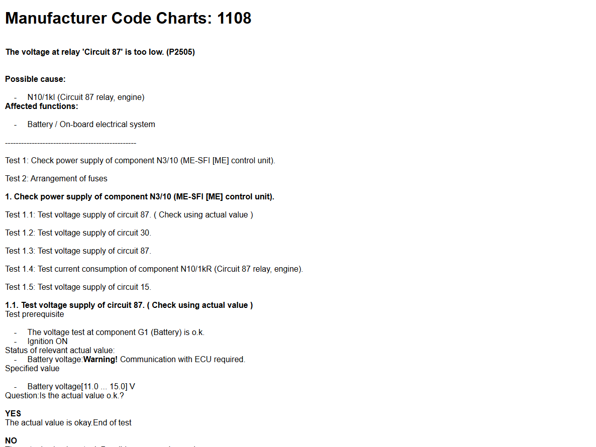

what does the codes mean ? The ones I showed on this post.

Charm code 1108 is low voltage at circuit 87 relay. It’s a fatal error. I think 87 is related to ECU power.
It’s a fatal error.
That means one of the F-SAM relay may have matured to require attention...
This undersized relay may become a staple maintenance item.

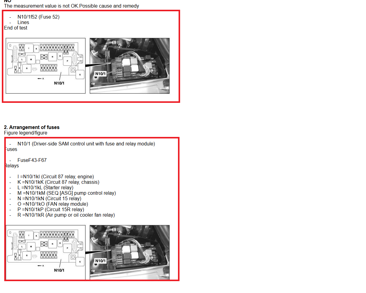

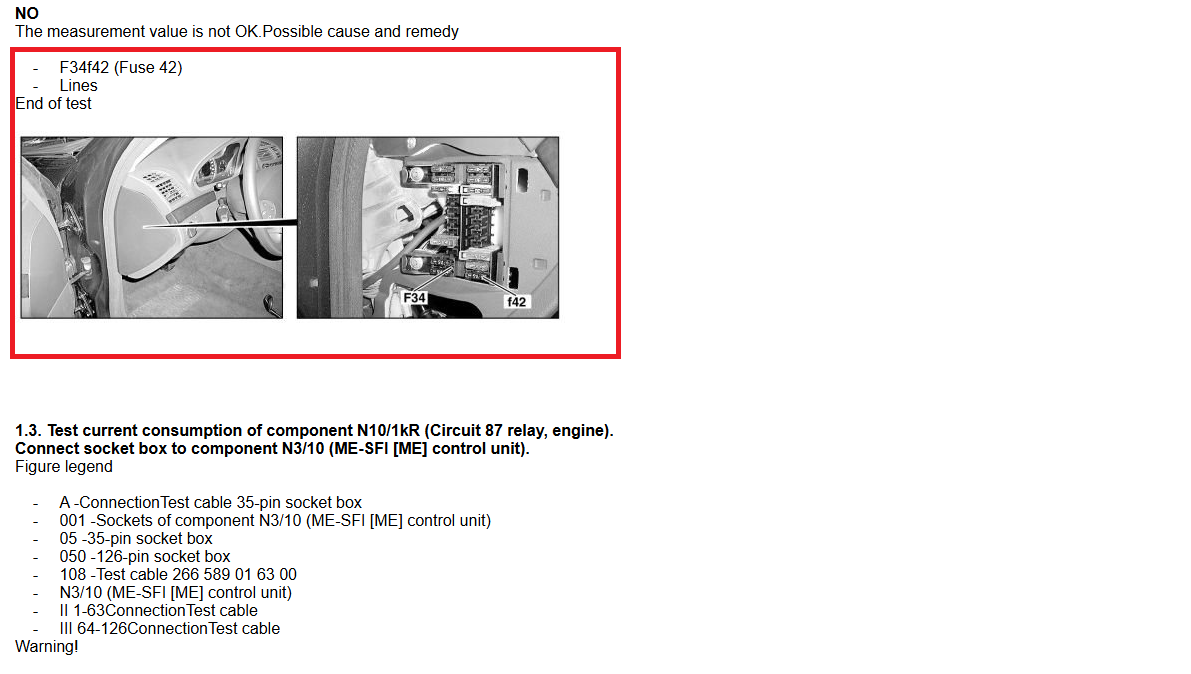

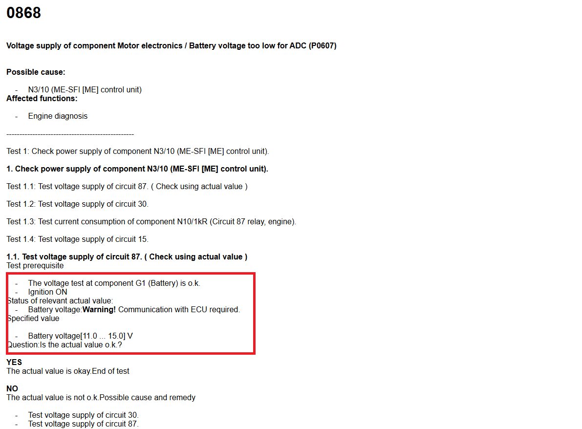

I looked up the codes and they show a few fuses to check. I just skimmed the codes quick since i dont have alot of time at the moment.
Heres a link to where i was finding the codes. They are mostly listed under the "Manufacturer Code Charts". Codes arent in order so have to look for them out of order. https://charm.li/Mercedes%20Benz/201...8%20DTC%20%29/

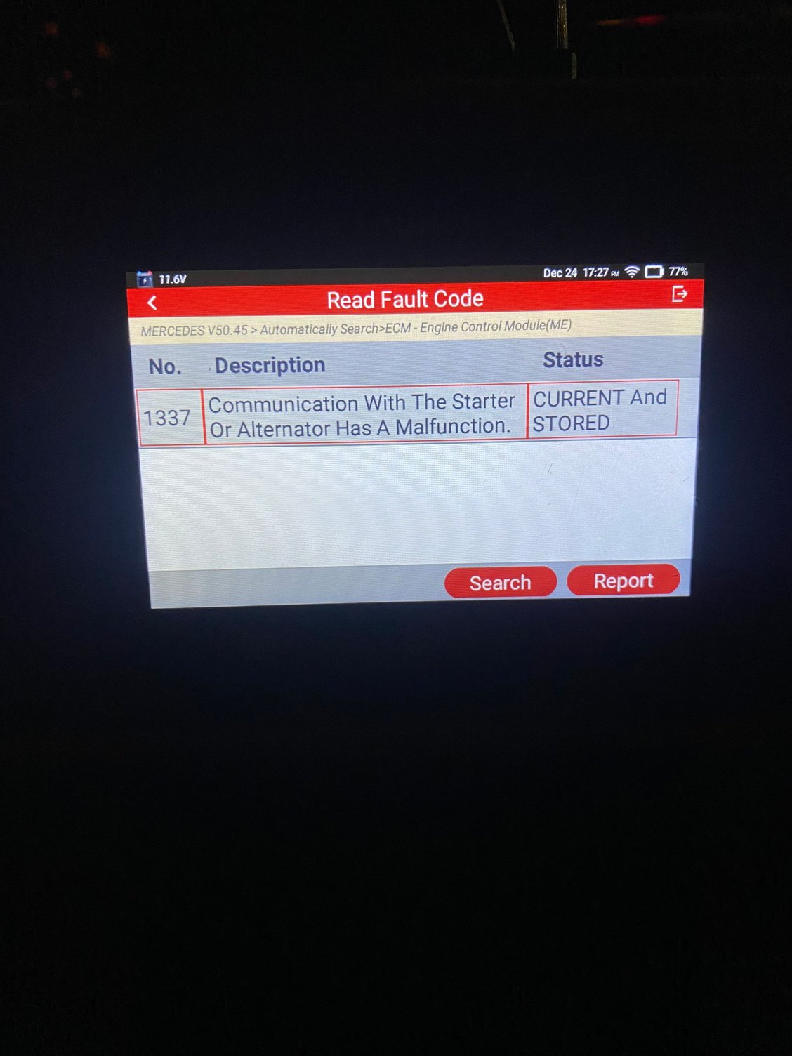

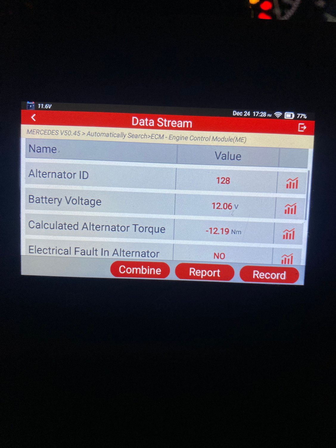

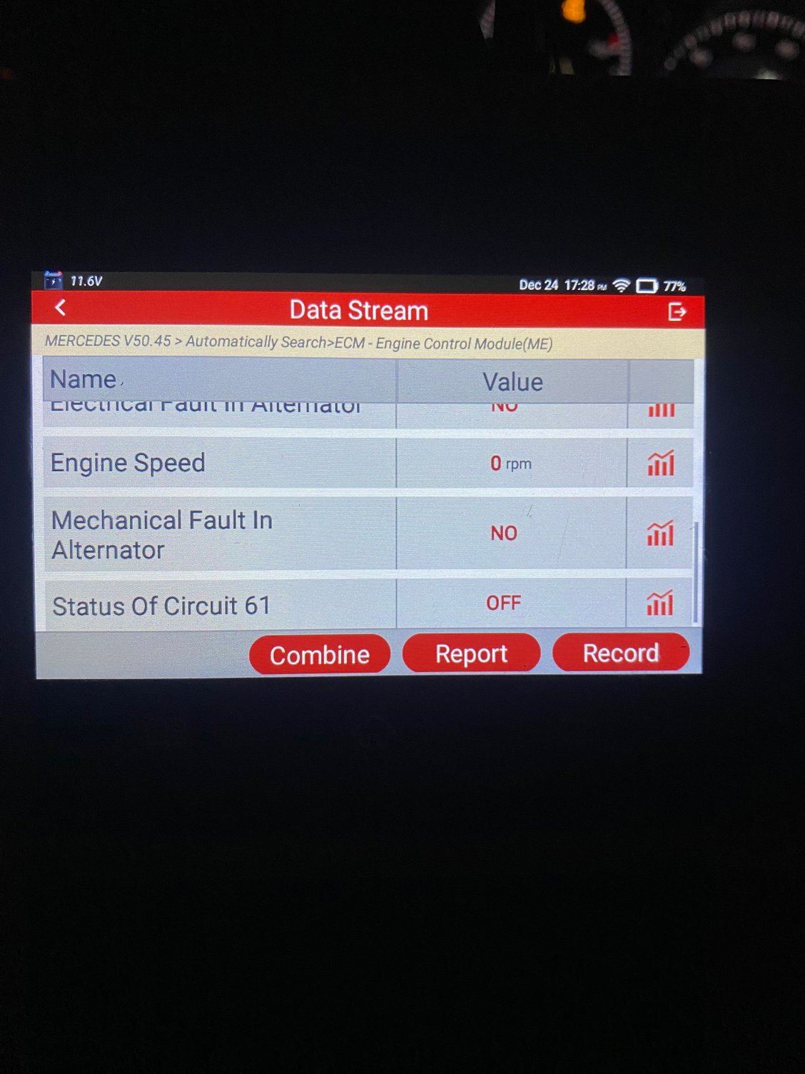

I replaced the battery for a better one recommended for my c300. It cleared most codes except the 1337 code . I tried to read the starter but I couldn’t find the data stream for it .

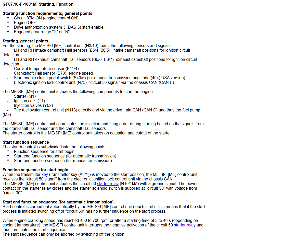

Im not sure what communication with the starter would even be. When I look up that code it just mentions the alternator, not the starter.
Is the car still not starting?
Heres what it says for the starting function:

yea car still won’t start . I’m thinking the starter is the problem . I changed my alternator a week ago . New and plugged in . Changed my battery , new belt . Still won’t start . I’m thinking the starter since that’s the only one I haven’t changed and I can’t read data stream to starter

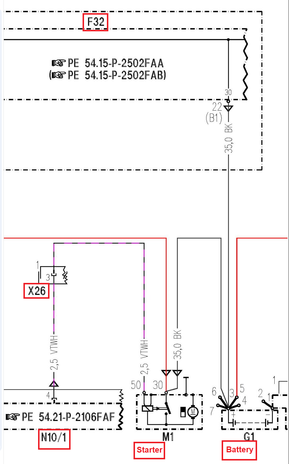

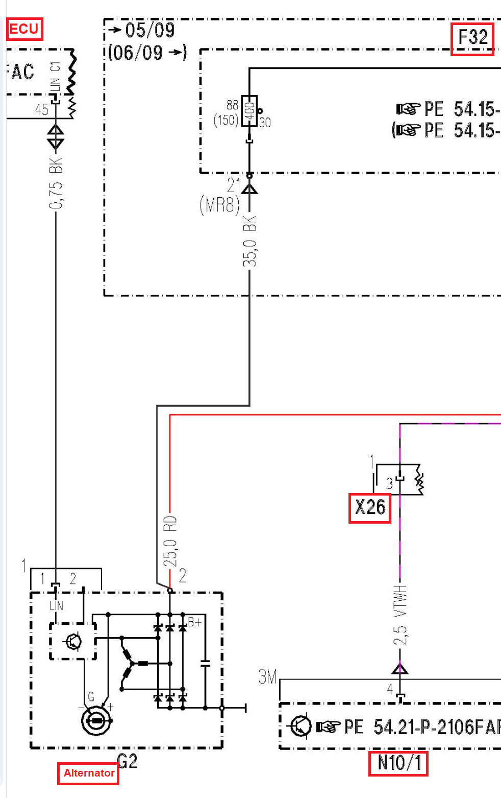

I was looking thru the electrical diagrams. It looks like the starter and the alternator are connected by + wire.
There is a LIN wire from the alternator to the ECU. LIN C1. Wonder if that has a faulty/loose connection. S-Prihadi knows alot about this stuff. Hes usually in the W212 section.
I cant post the full diagram due to its size. Heres a link to the diagram i was looking at: https://charm.li/Mercedes%20Benz/201...ging/Diagrams/

There isn’t much information that comes directly from the starting/charging circuit, but what info there should be seems to be absent. That LIN circuit is a low speed serial bus sending basic charging voltage information. Check the connections on the alternator. Since the alternator is new, make sure they are tight. If there is a separate ground for the alternator, pay special attention to it.
Two other ideas popped into my mind about this issue:
First is an open fuse in the prefuse box. Check the wiring diagram from @TimC300 to see if the alternator output even goes through the prefuse or if it’s only the battery.
Next, as a last thought, is the Drive Authorization System. You may need to scan that on a cold start attempt to see if it is blocking the starter. With the right scanner you can determine which component was not satisfied and go from there.
which fuses should I look at? 7? L? M? Or is this the wrong fuse box ?
You mentioned a “ separate ground for the alternator “ what would that look like? If I were to look under my car what would I have to look out for? Sorry if I’m asking a lot.
