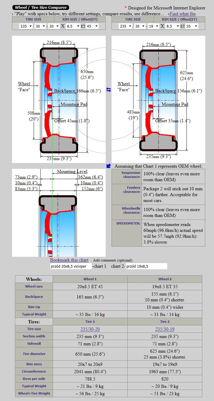

I've compared your front setup with the 19x8,5 ET35 and it seems it should work; it would stick out 10mm more. With a spring drop of ca. 30mm it should be fine, right?

S213
My setup rubs in front when turning on an uneven surface.
Old Jan 13, 2016 | 04:35 AM
beceen's Avatar
Joined: Jan 2016
Posts: 69
From: Warsaw, Poland
W205
but rubs due to sitting low or is rubbing not related to ride height?
