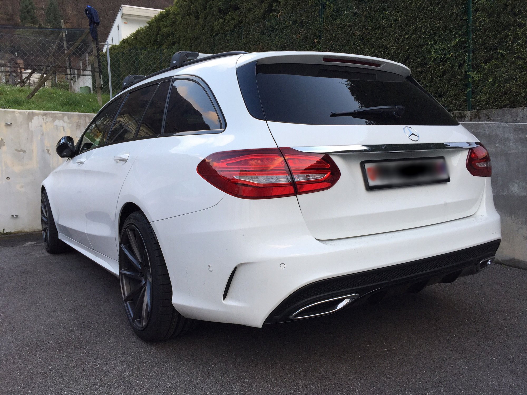

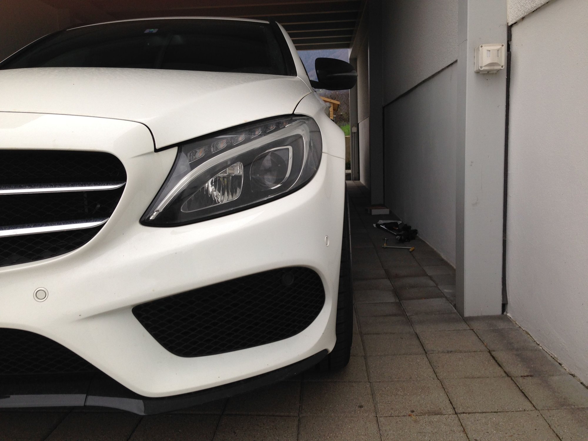

Here some pics of my new wheels Corniche Conquer 8,5x19 ET35 and 9,5x19 ET45
Tyres are 225/40 and 255/35

thanks for posting; any problems with fitting?
Do you have sport suspension?

Exacly I've AMG-Line suspension (-1,5mm).
Unfortunately I didn't had enough time to test them without spacers (currently installed 10mm per wheel) but I'll test them asap even if the wheels supplier told me that they probably don't fit due to brake system.
Next step will be lower the car and I want avoid any kind of rubbing.

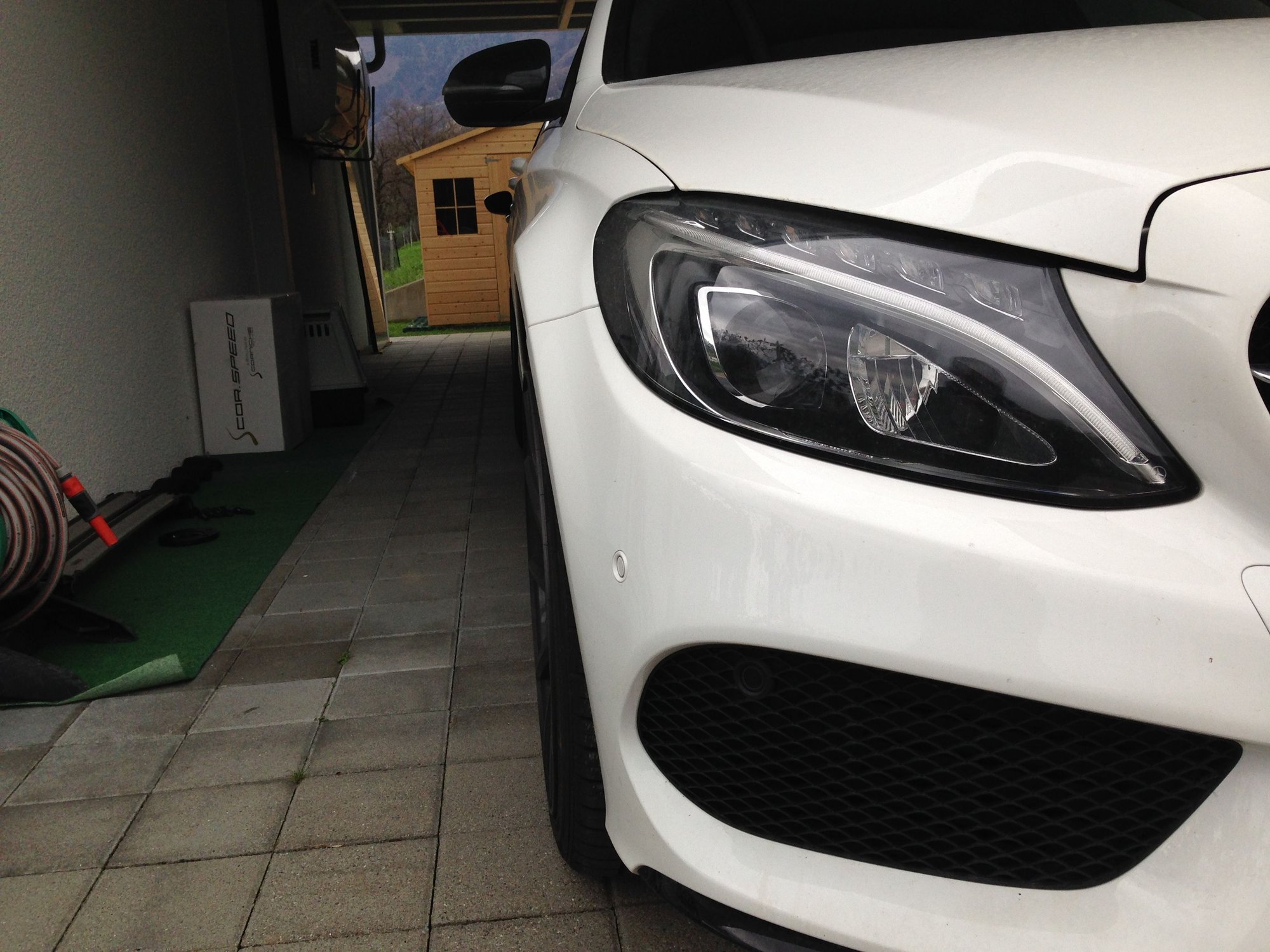

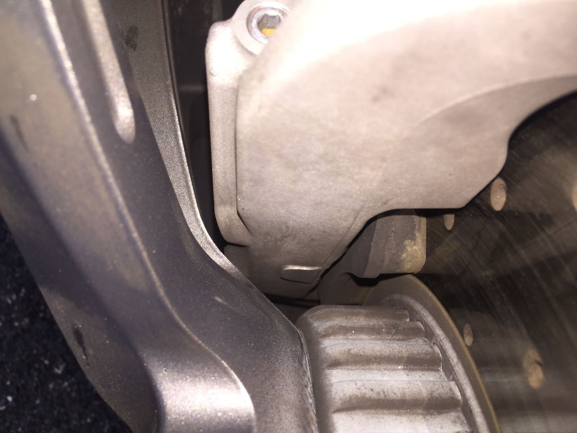

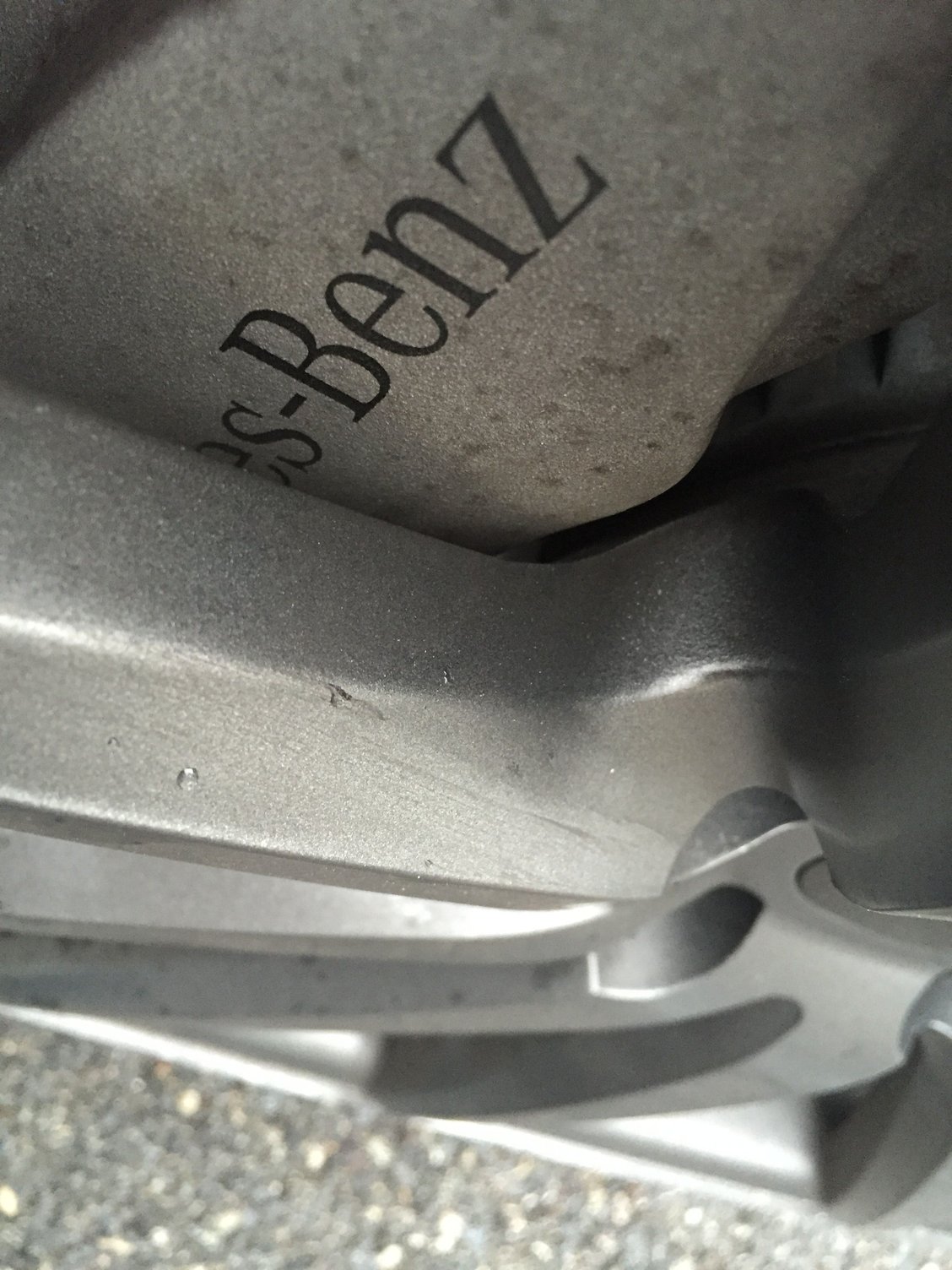

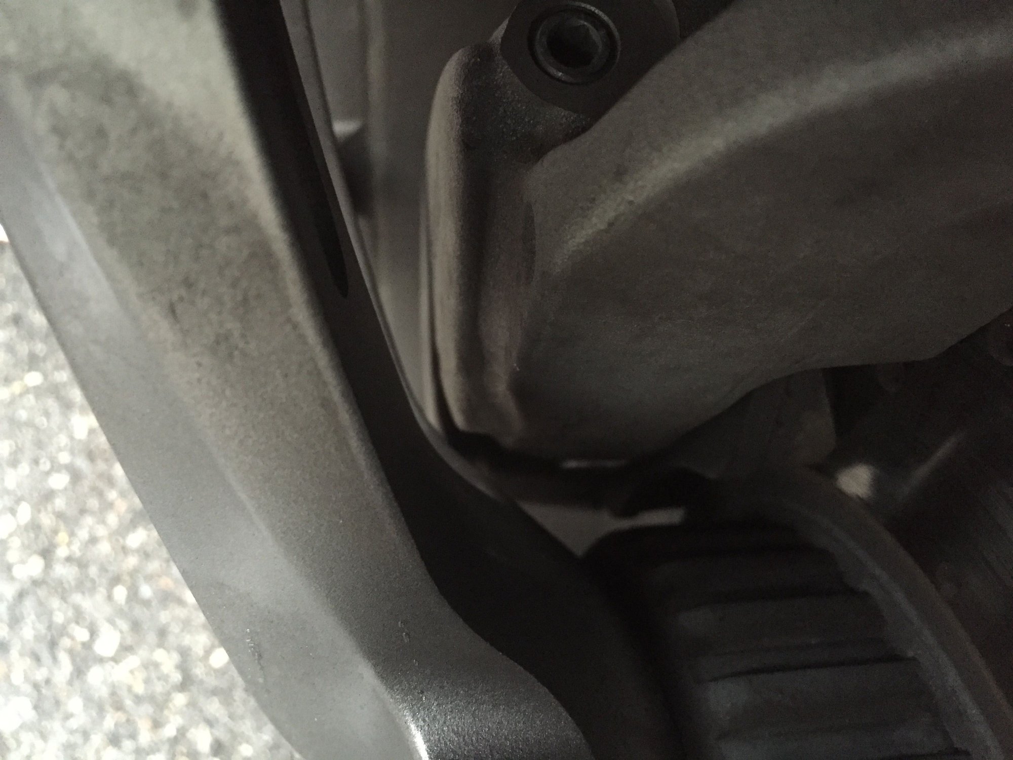

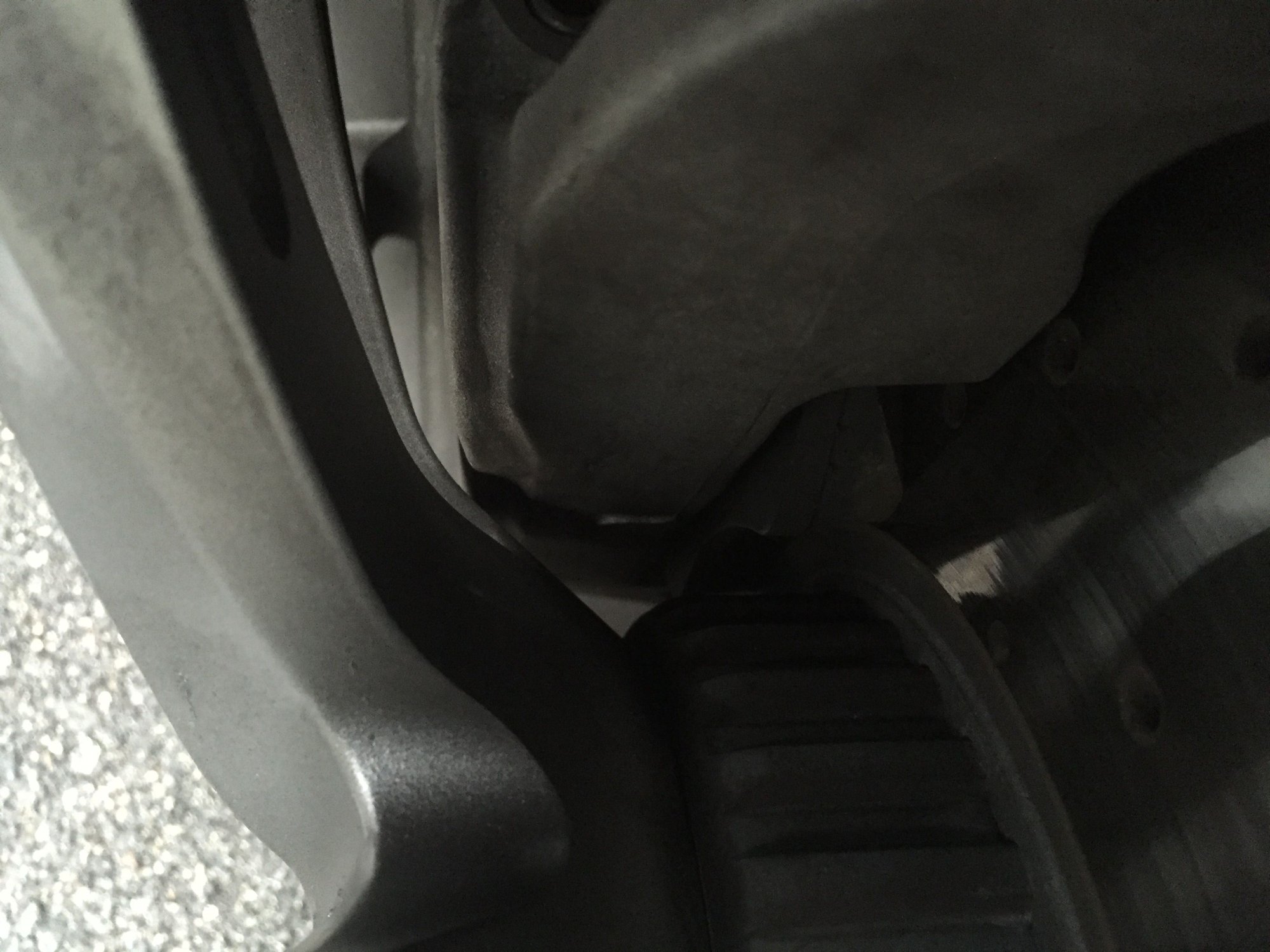

Yesterday I tried front wheels without spacers and they look really better.
Wheels don't hit calipers and they fit better related to fenders.
The distance between calipers and wheels can be enough in your opinion?

Yes, that's plenty of clearance to the caliper

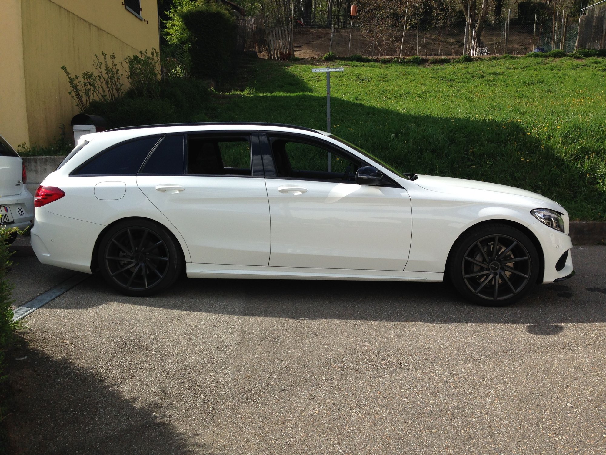

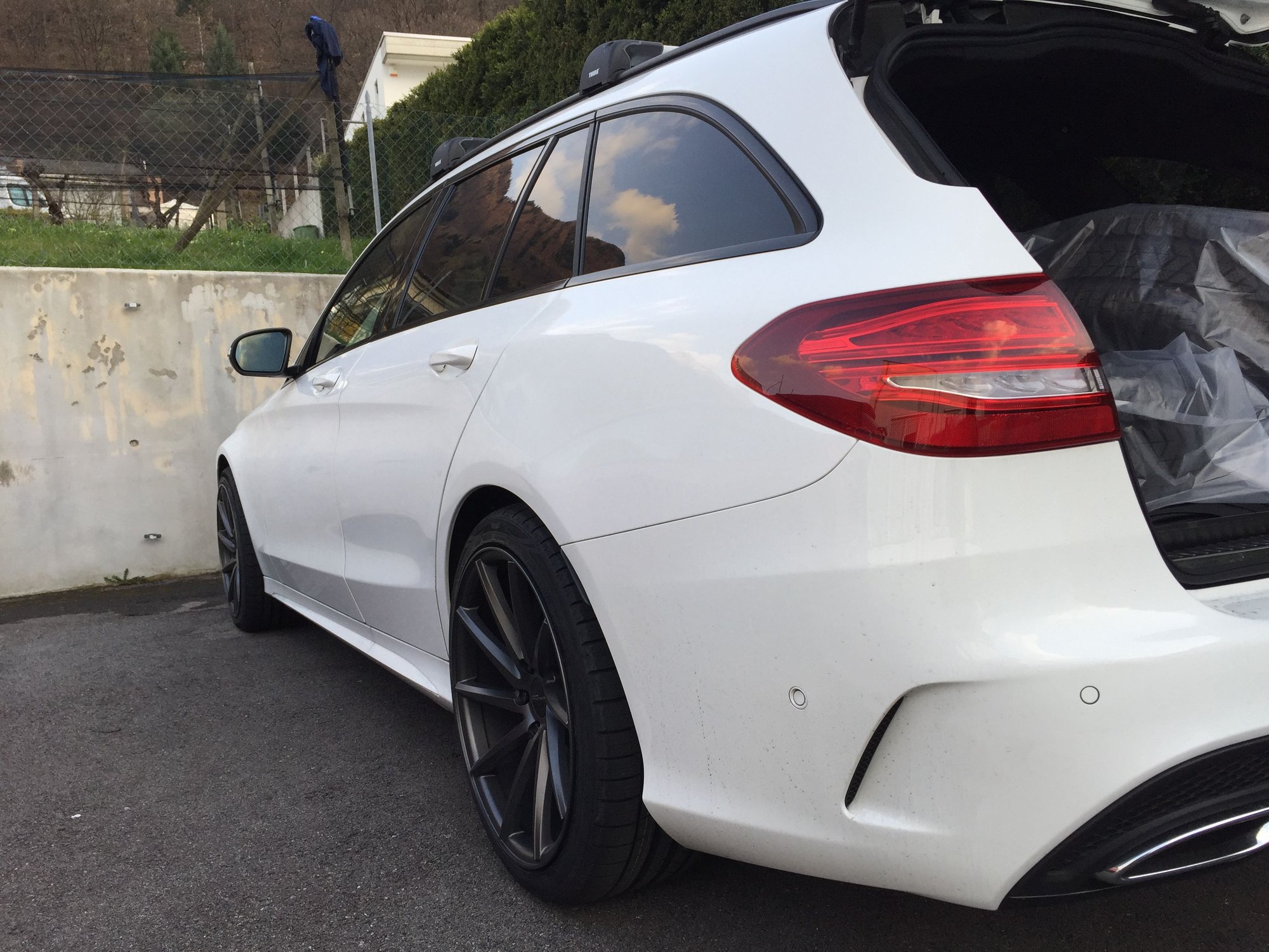

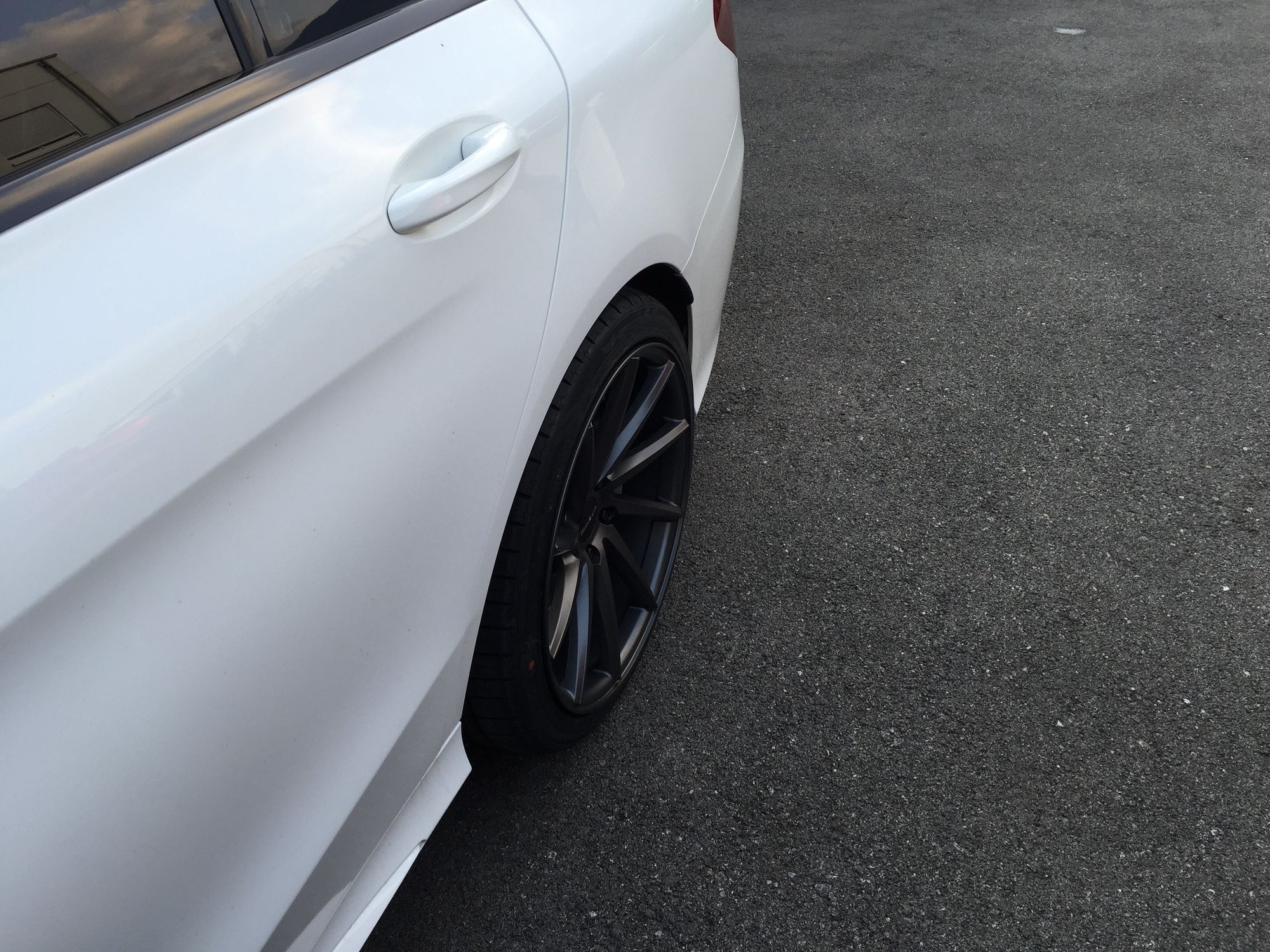

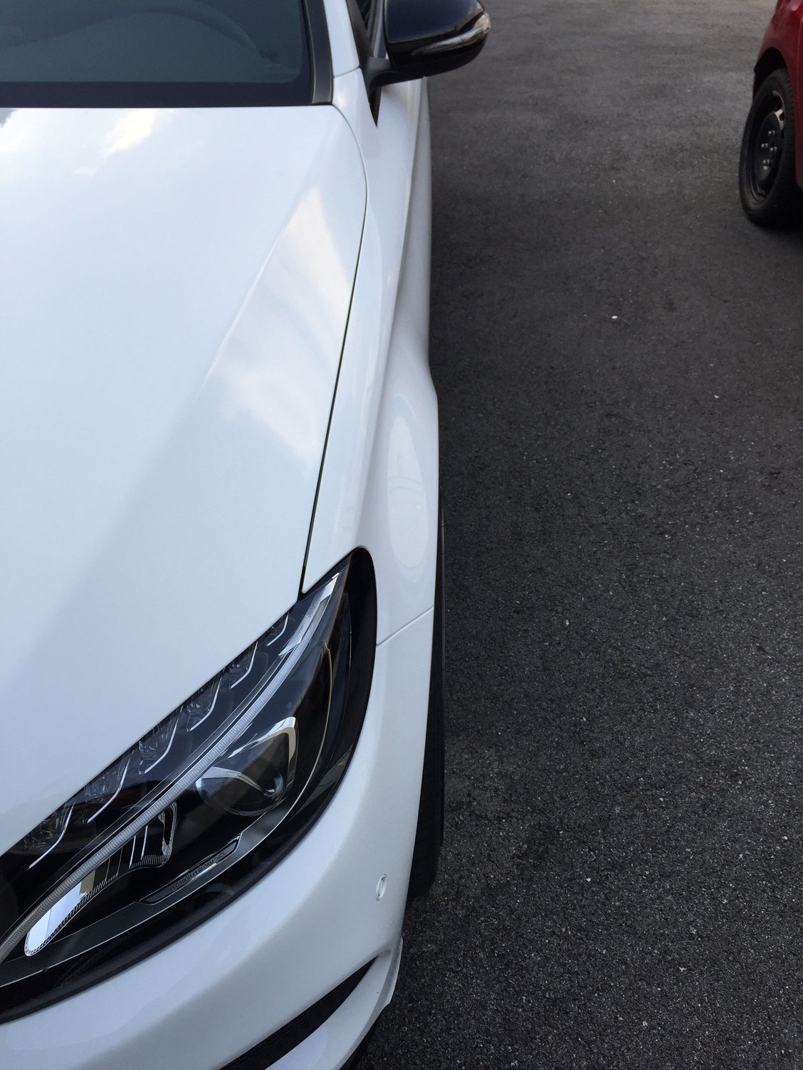

Finally I've found a nice set-up for my W205!
Some datas:
  • Model: Corniche Conquer by Cor.speed 19"
  • Front size: 8.5x19 ET45
  • Rear size: 9.5x19 ET45
  • Front tyre size: 225/40 R19 Kumho Ecsta LE Sport KU39
  • Rear tyre size: 255/35 R19 Kumho Ecsta LE Sport KU39

Some pics...

looks good; still running without spacers?
Old Apr 16, 2016 | 07:23 AM
  #43
Macks's Avatar
Joined: Jan 2016
Posts: 20
Mercedes C220d 4matic AMG Line
Exactly!
