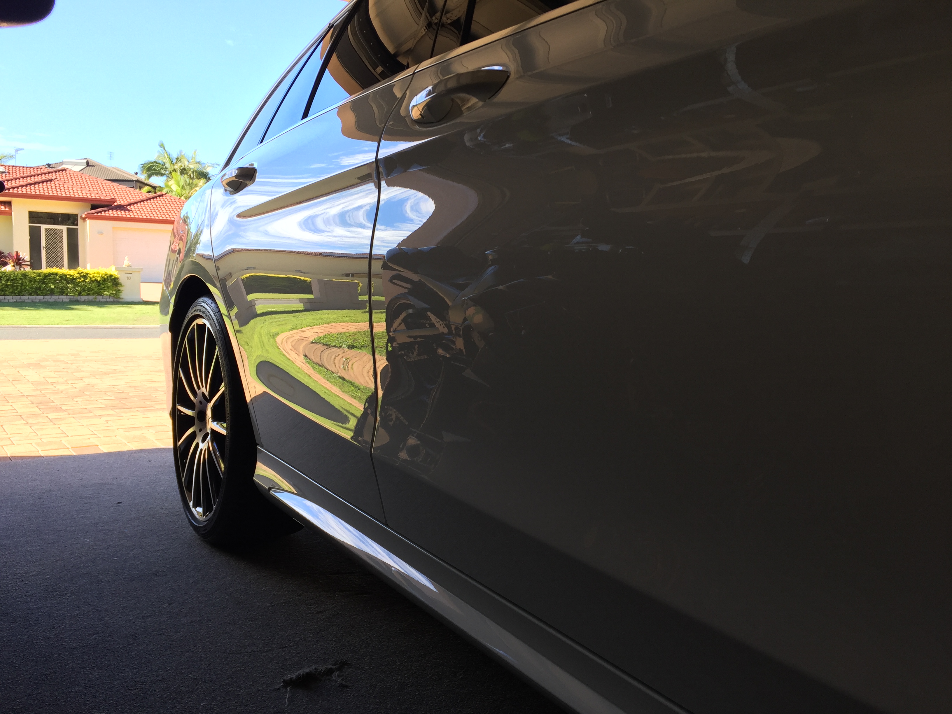

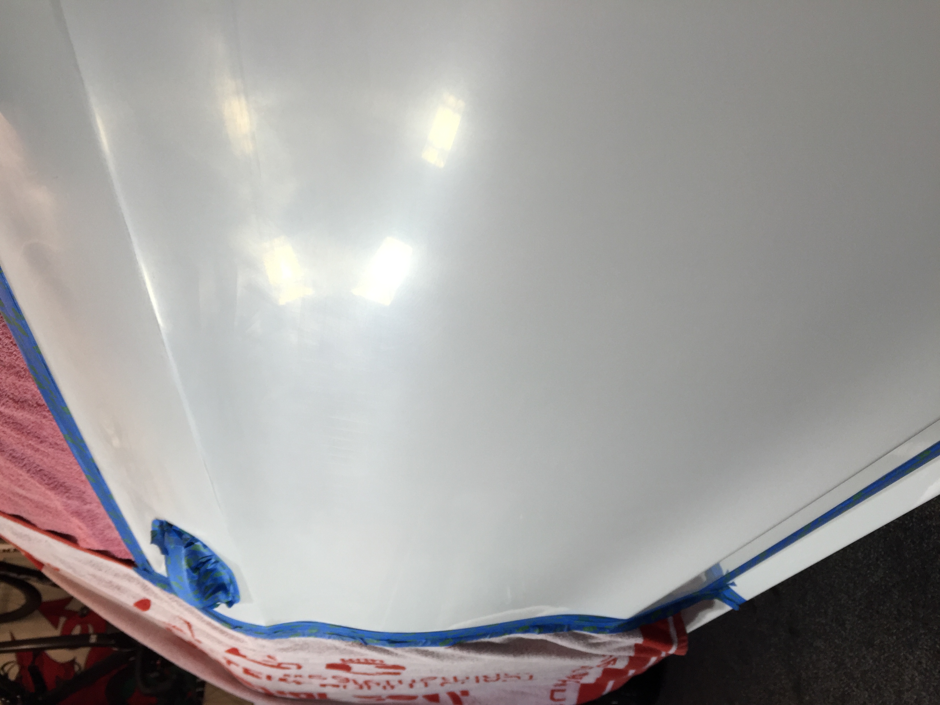

Aw c'mon,, its only a little wet sanding..
I did my S205... well worth the 50hrs, nerve damage and 2-300 dollars of materials it consumed.. ??????
Attached Thumbnails How do you clean your C-Class? Coatings?-img_1792-1-.jpg   How do you clean your C-Class? Coatings?-img_1733-1-.jpg   How do you clean your C-Class? Coatings?-img_1744-1-.jpg
