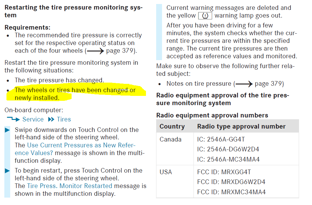

After changing wheels or tires you must restart the TPMS system as documented in the owners manual. This should detect the new sensors in their respective location and start reporting pressure and temperature correctly.
My TPMS started working after clearing the fault code C158100(Front or rear sensor localization was unsuccessful) and then immediately restarting the TPMS system. After driving for about 5-10 minutes the car picked up the new sensors.

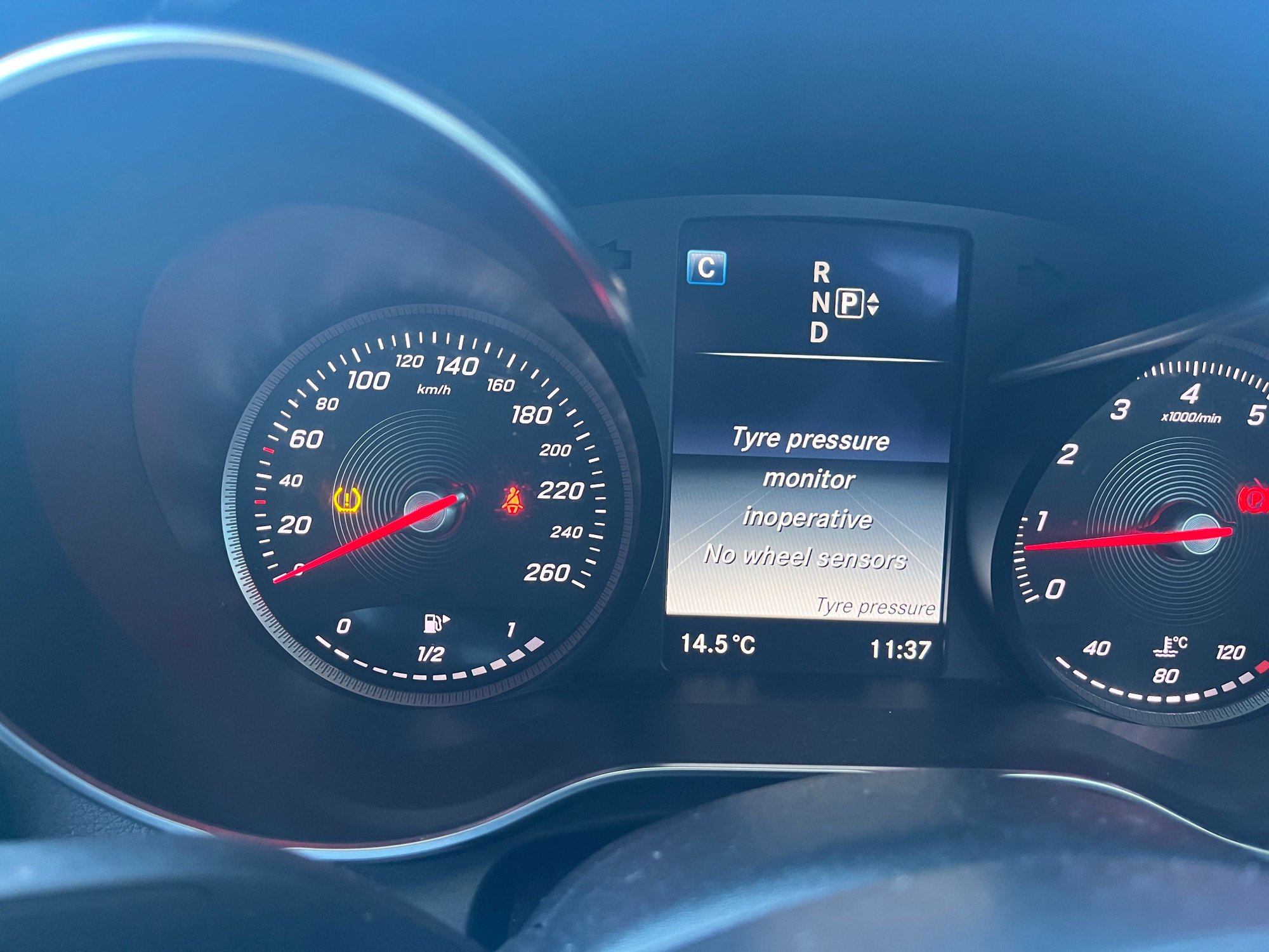

That’s for the response, unfortunately this doesn’t seem to work.
same issue, eBay sensors which the tire shop installed and seemed to read ok. The car can’t pick them up for some reason.
active for a few minutes while the orange light flashes, then “inoperative “ .
Any other suggestions?

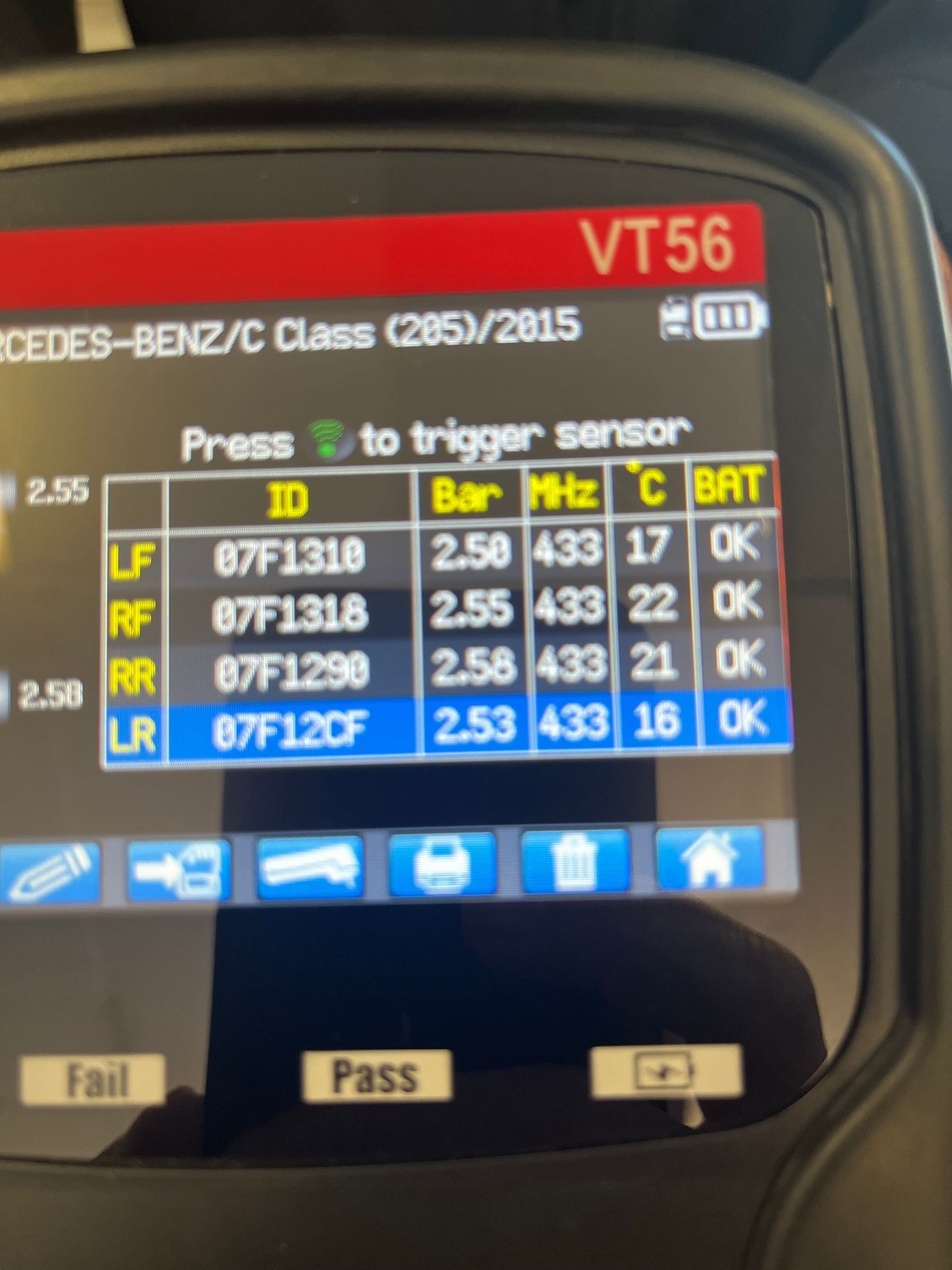

Hi guys, i bought a new tpms from merc but that damn thing still not registering after two days of driving. Sensor reset doesnt work even after accepting new pressure. Amber light is steady and every now and again states inoperative. Mercedes me app works fone though which is strange. Please help. What can i do to get the monitor working again?
