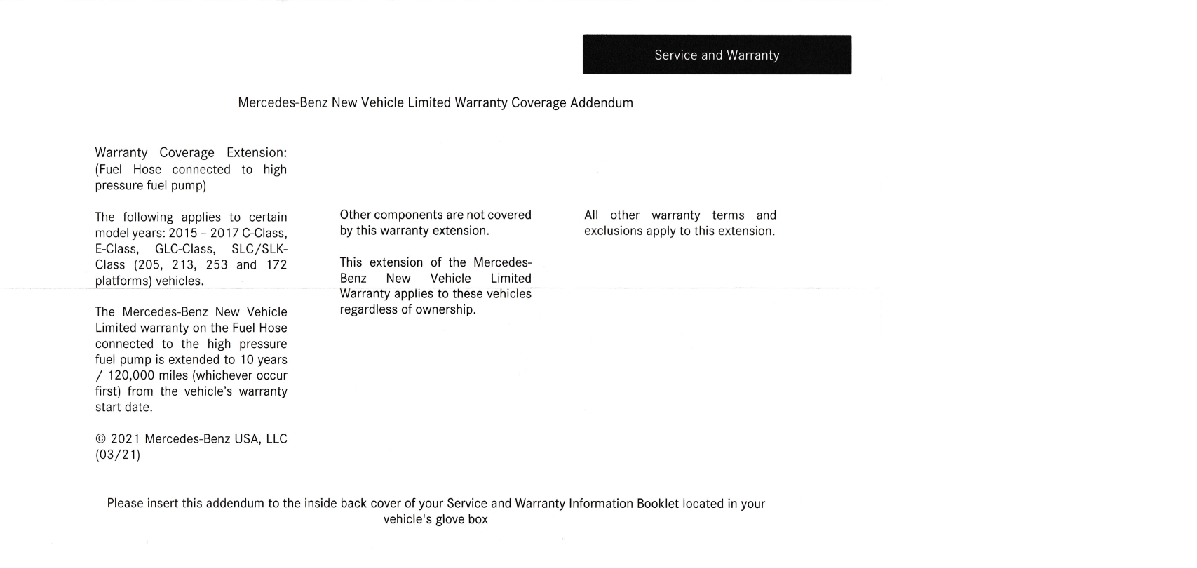

They do the recall. You don't need to do it by yourself. I did it on August 2021 for free instead of 600 USD by Dealer

I'm at 168,000 miles, I'm outside the warranty window
Old Dec 10, 2021 | 03:58 PM
ndr's Avatar
ndr
Posts: 16
Likes: 12
2016 C300 Sport
Scanned from my work order done at a Mercedes dealership. Hope this helps.
Old Dec 13, 2021 | 09:42 AM
mikec35's Avatar
Joined: Oct 2016
Posts: 169
Likes: 81
2016 C300 sedan
Thank you! That's the hose that runs up the firewall to the top of the engine. I wasn't sure if it was the hose under the car below the steering shaft of the one to the fuel pump. Now I know. I've been trying to catch it when it happens, even had my car on jack stands for 2 days with the plastic pans removed from under the engine/drivetrain waiting for the smell so I could see where it's leaking, of course it didn't happen for the 2 days I had it jacked up. I had to put it back together and drive it then it happened again.... It's been intermittent for me for about 2 years.
