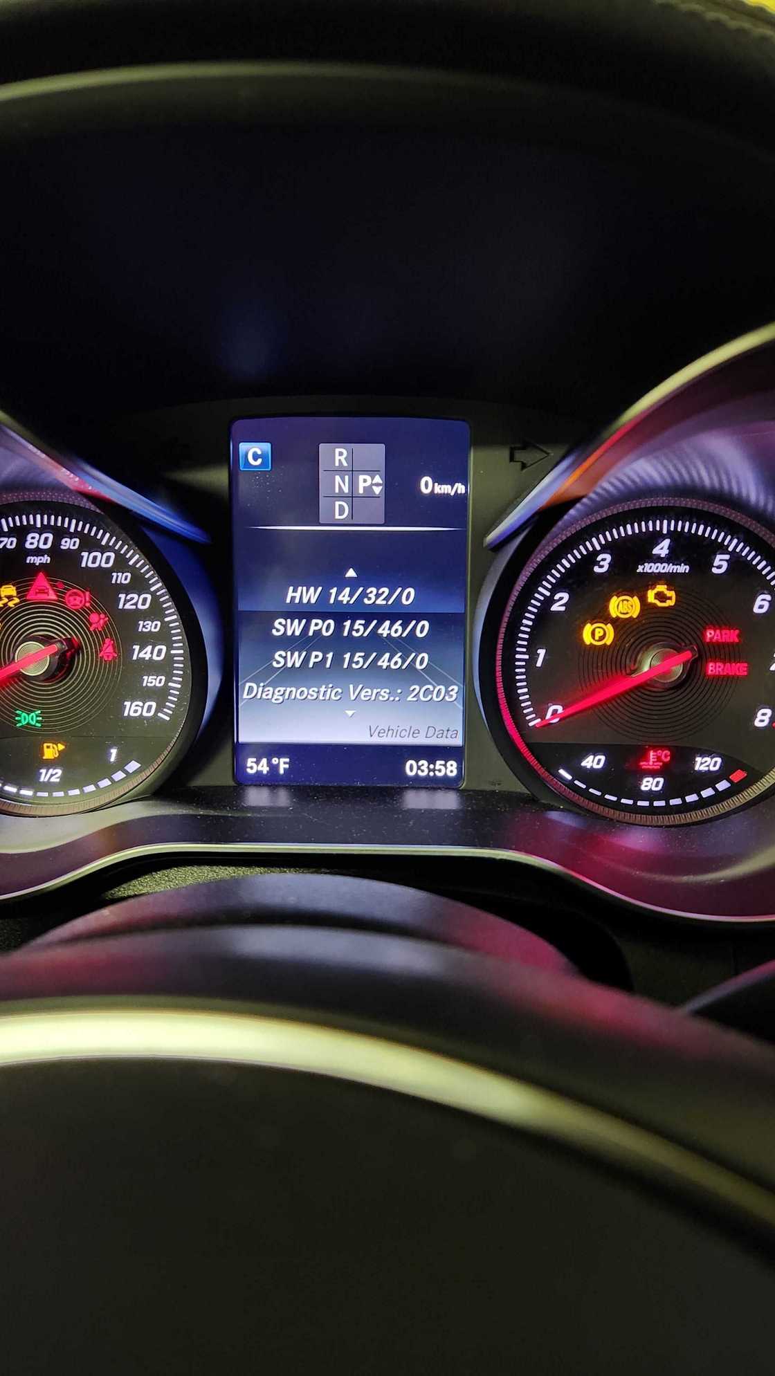

Hi
does anybody know what all the values showing in the Diagnostic screen mean? My start / stop function is not working anymore. No error or codes are displayed on my instrument panel. I have read that by replacing the battery it will fix the problem and there is also a unit under the glove compartment that is controlling that function. Battery has 12.5 V and when the car is running it shows 14,4V
Thank you
Thank you in advance for any response.
Massimo

Check your auxiliary battery as well.

I ended up changing my main battery and everything went back to normal. Start / Stop function is working again.
