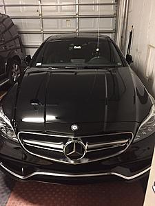

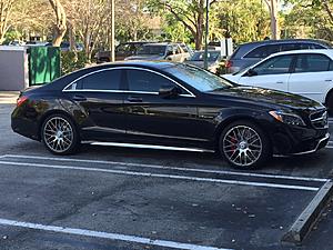

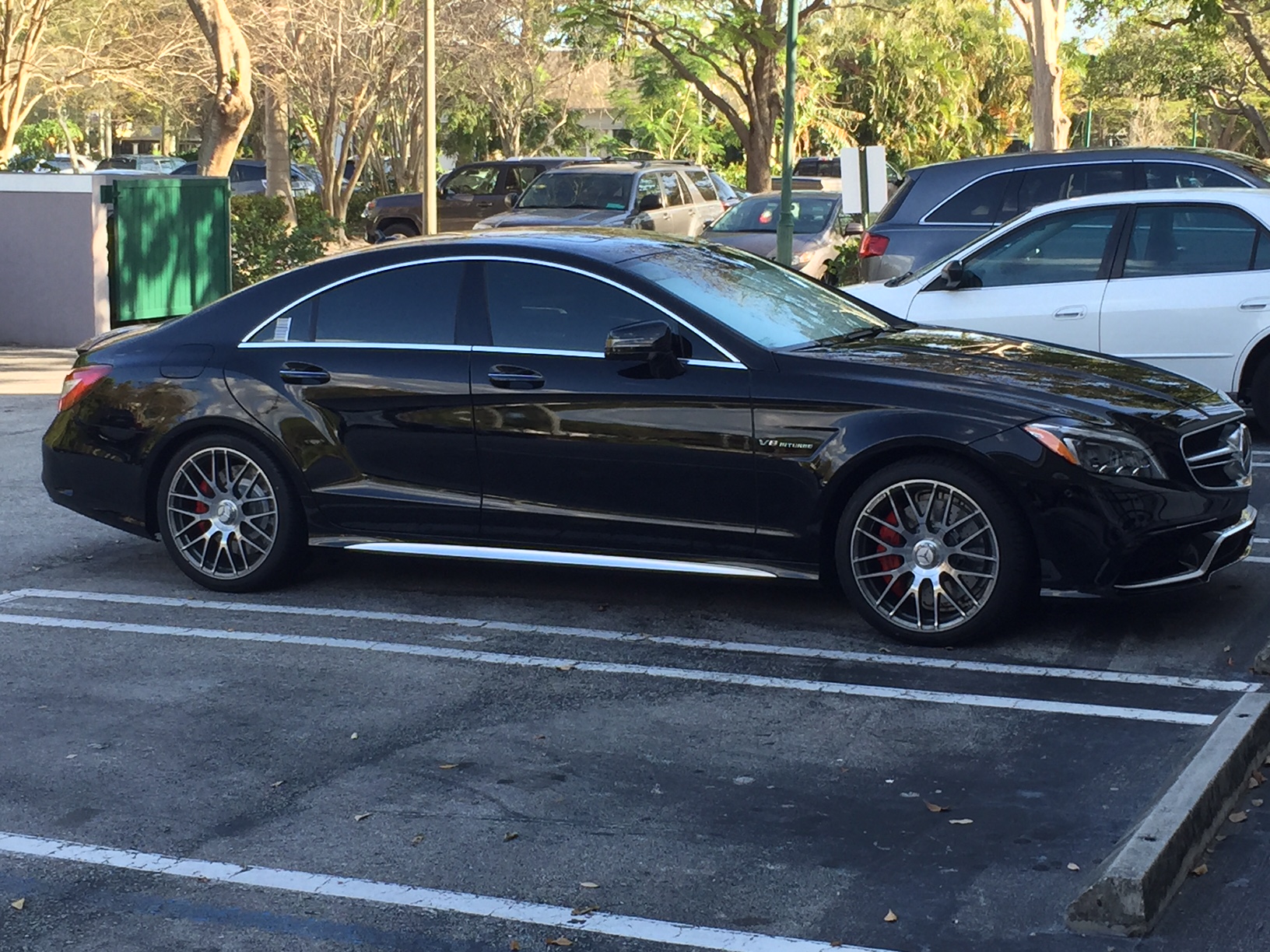

Some Pictures
Replaced my beloved PanameraGTS....but LOVE this CLS63. A quick parking lot pic to show the great wheels...and one pic from the garage to show off that aggressive front end!

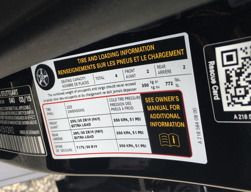

Wow, this explains why the car felt a bit like a boat!
Why the F*** does the label in the door jam say 51psi all around!

Here is the label in my door jam.

right.....mine says 51 too although I feel it's to high

Agreed for sure...the ideal pressure is listed inside the gas cap...
my car indicates 41/33, which I still think is a bit high I switched to 39/35 (cold) over the weekend and I like it much better.

While there is info in the door, there are more specific recommendations inside the gas door that take into consideration, number of passengers (weight) and top speed. With 2 people in the car and speeds under 155mph, the recommended pressure is in the mid 30's with a slight variance front to rear. I don't remember the specifics off hand, but check it out. 51psi should be for the vehicle at max gross vehicle weight, way too high for day to day.
