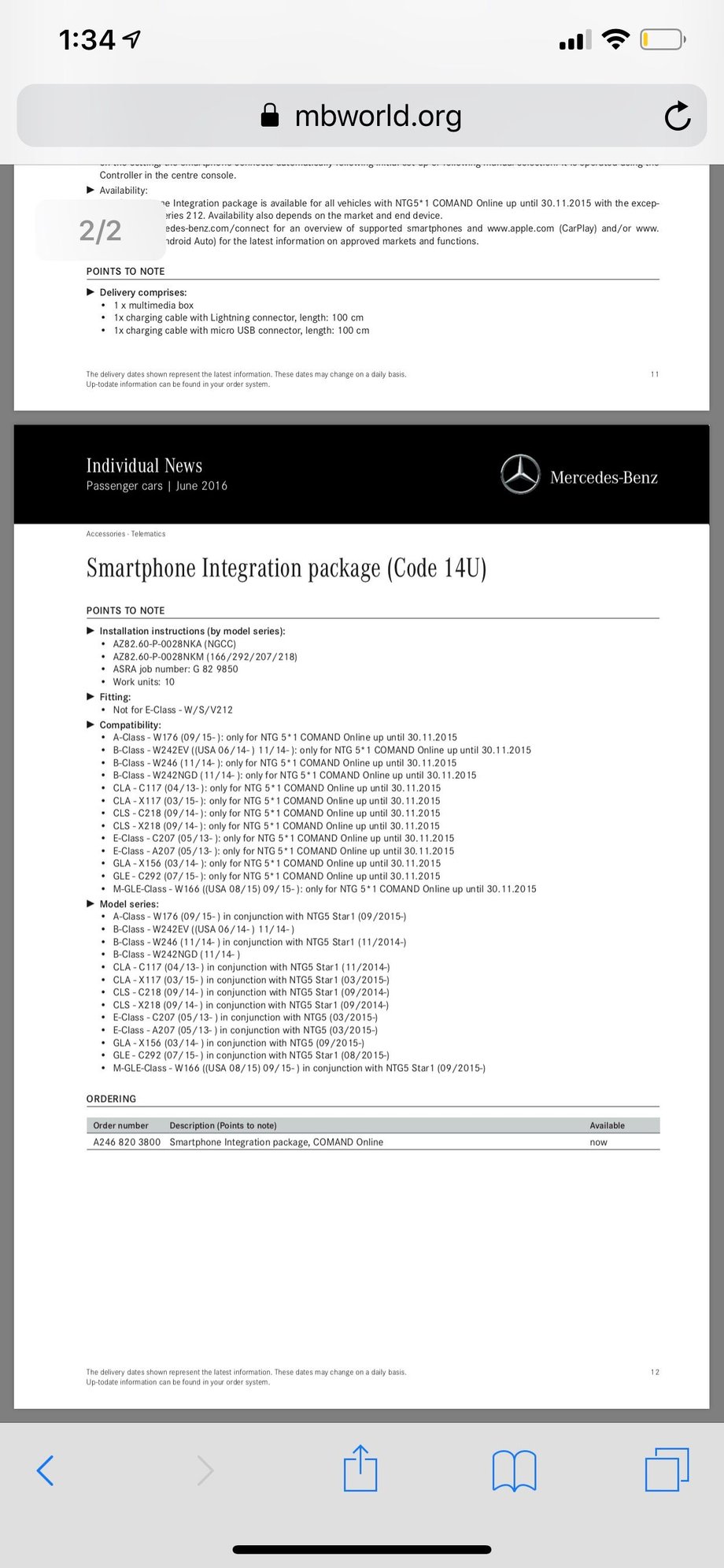

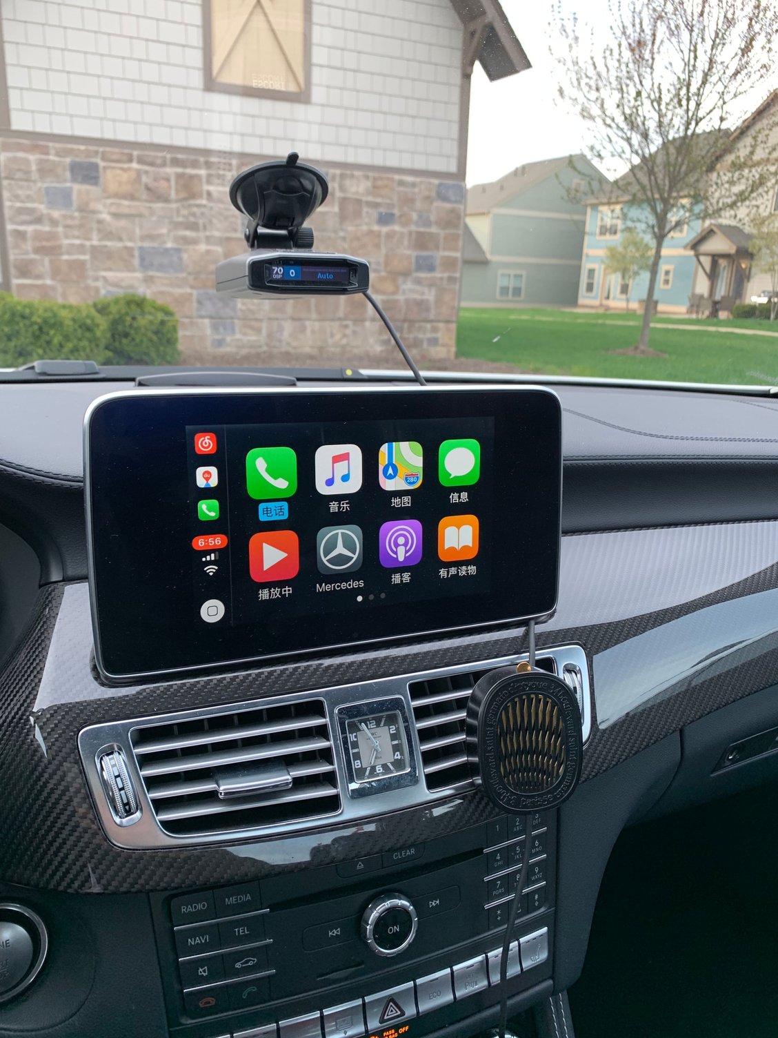

My car is 2015 version CLS63,car dont have CarPlay and android auto with it. I tried many ways to retrofit it. But i forget the easiest way—ask MB dealer . I saw an article said that smartphone integration package can retrofit by dealer,so i asked my dealer,give them part number tw,they checked said that is available! So ,$300,2 hours,CarPlay and android auto retrofitted!

I did the same, the problem is you can't adjust the equalizer sound for the music so it sounds like ****! If you bluetooth the music then you have access to the equalizer and the sound is much better. You can't even turn on the surround sound when using android auto or apple carplay. It really pissed me off when I found this out and Mercedes has no fix for it...ugh. I now just bluetooth my music and use android auto from my phone on a mobile mount rather than integrated to the car. Wish there was a fix for this...

What is the part number to share with the dealership, my car is in there now and I'd love to do this!

Thank you!
