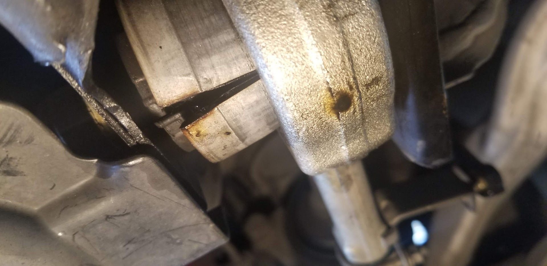

Okay the other day i decided to do a full inspection my car have only had it a month. love the car but I noticed that every time I went over bumps or made the sharp turn to enter the garage I would hear this noise. I thought it might be suspension related. Sometimes I would hear when the air shocks were raising the rear end. Well I think I found the problem. The bushing for the driver side control arm has a bushing migrating pretty bad. I started to remove it and press the the bushing back in then I thought that if it backed out once it may do it again. So I ordered a new one. I was wondering if anyone else has seen this problem

Happened to me as well. Same thing, suspension groaned when going over anything. Have them check your struts also.
