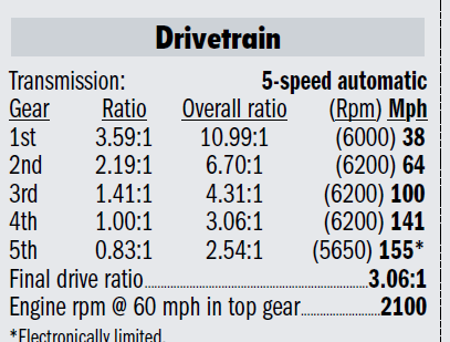

i mean what is the max for 1st gear , 2nd gear and etc.
For example: 0-40mph 1st gear 40-70 mph 2nd gear and etc.

I think you are looking for this:
Here is a full link. http://www.roadandtrack.com/cm/roada...2-AMG_data.pdf

Thanks a lot. Great.
