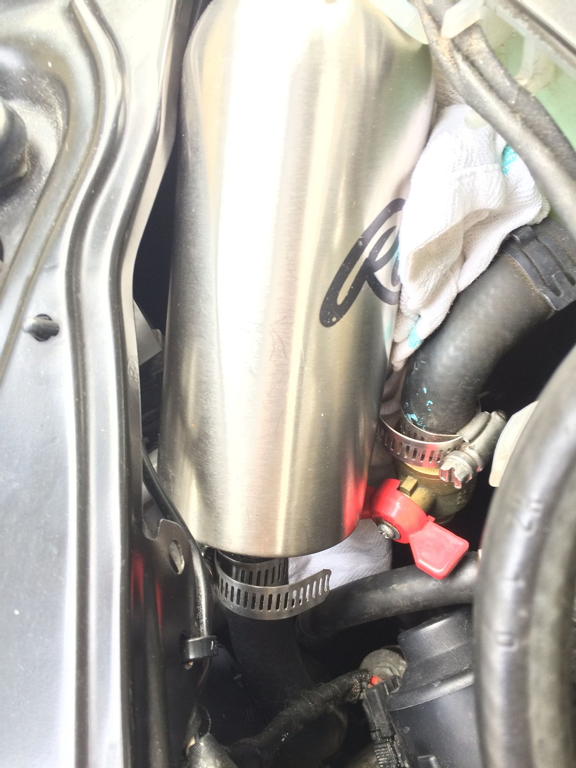

Just added IC reservoir and iat dropped by 5-7 degree f, I'm running 65mm sc pulley and tune,with stock intercooler, and split system. I ran split system for 9 months so I decided to add reservoir, the extra fluid which is 500ml more dropped iat temps.
57.4f outside normal driving and I hit as low as 68-75
Great mod for pple to do and very easy.

I can but don't laugh, I used aluminum water bottle cut hole in bottom, put barb then jb weld it in place so it was secure and waited 48hrs to dry, if ur running a split system it ties in to 1/4 inch pipe from coolant reservoir, I have not made a bracket yet, will wait for week make sure it does not leak so I just zip tied it for now, make sure u let IC bleed out bubbles.

Yes its roots water bottle, yes made my own split system

Its not bad! when you fix it firm, make another picture from above to see the overal look

It will be black, and it will sit straight, just making sure it not leak, it holds 500ml,

And cloth is there just in case it leaks, it doesn't look that good but it will when done
