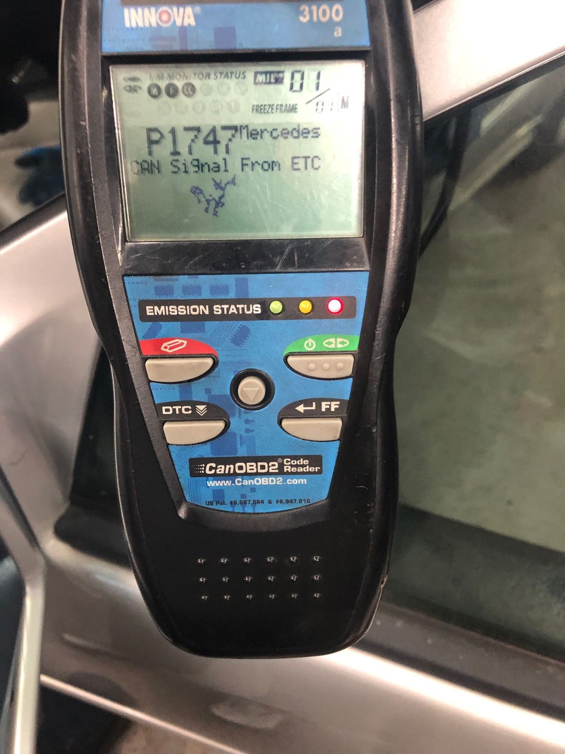

I have a transmission error read as p1747 on my c43 and i want to know if its related to the cluster (since a few bulbs aren't working on the left side), if its the valve body ( the fluid is slightly dark, car doesn't miss shift, but may shift a little slow), or a ETC solenoid?

Could be, but not sure. Check this list and the code description: https://mbworld.org/forums/c32-amg-c...ml#post3893891
P1747 Electronic Gear Selector Module: Defective Interaction of CAN with control unit A1 (instrument cluster)
