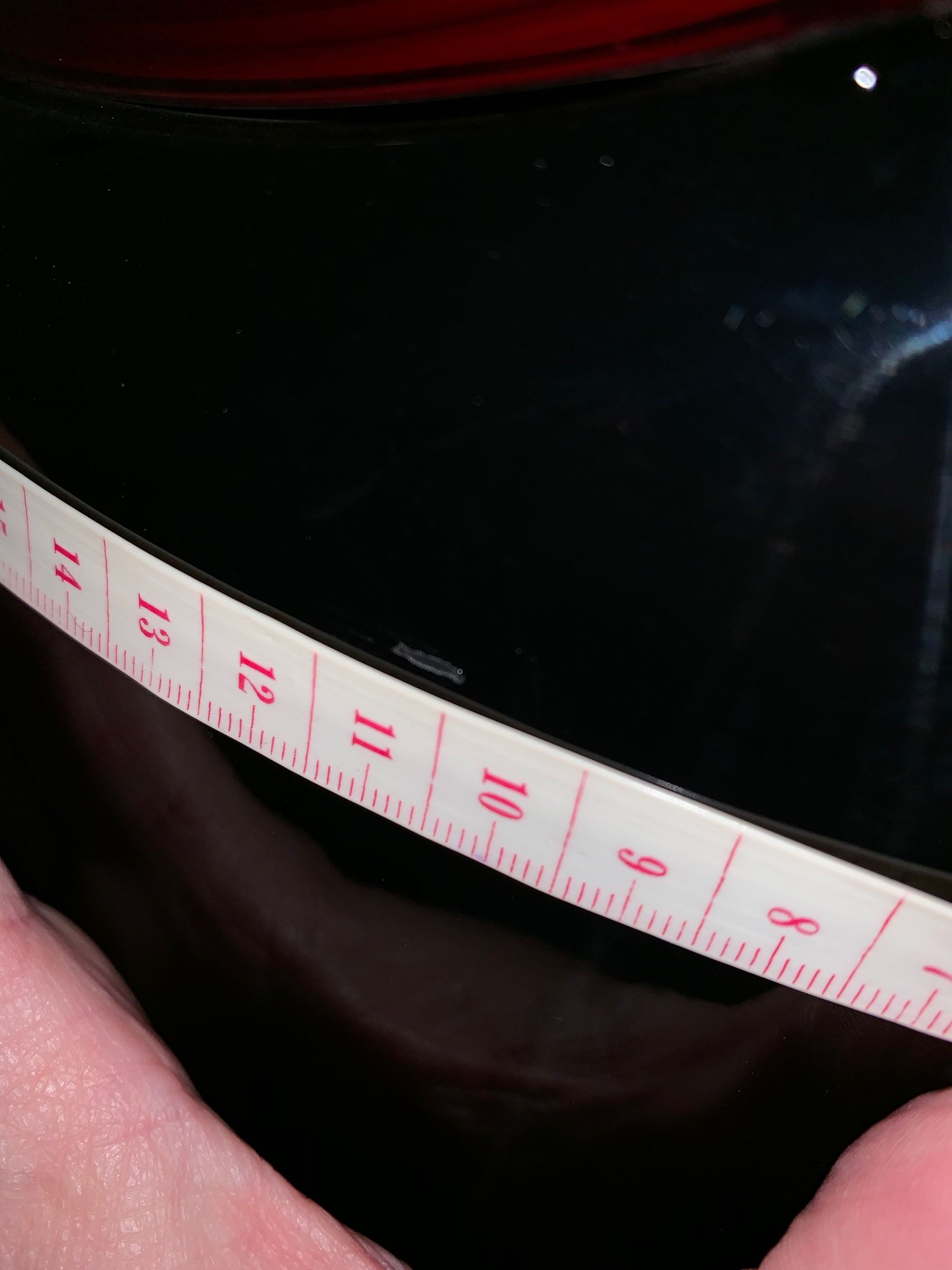

About four months ago our right blind spot sensor started going off on our 2017 C43 without a reason so we took the car into Mercedes. We were told the bracket that holds the sensor was broken due to "damage" however no visible damage could be seen nor had the car ever been in an accident. After doing some close looking we took the car back and said, we didn't see any damage and felt the weld must have been the problem. Again they said there was damage and point out a 4mm scratch (see attached) as proof and said it would be $3,500 to replace the bumper, labor, paint, etc. You could imagine my reaction given the car has never been repaired, nor could that small of a scratch cause a bracket to break. However they are holding firm and told me to file a claim with my insurance company. We took the car to another dealership who after inspection said there didn't see any damage and would look into the repair options. I received a call a short time later, I assume they looked up the service record and said the car had been damaged. When I asked what damage they saw, I was told there was "buffering" done to the bumper to remove what they felt was probably a scuff which is what caused the bracket to break. Neither dealership could answer, that if according to them this happened, how could such a minor incident cause a 5mph bumpers sensor bracket to break.

to be honest, that has been hit and there are buffer trials from machine polishing. The bracket would not just break by itself. Go to a panel beater and have them take off the bumper and fix the bracket.

No problem with honesty... The car has been buffed but that was done two weeks after we purchased it by the dealership (March 2017) and it is in the service record as proof. There has been no buffing since that and the problem appeared about six months ago. I suppose it is possible the car was "nudged" or something in that exact spot but I still struggle that a $50 plastic sensor the got "popped" on a 5mph bumper needs the entire thing replaced. Seem to really reduce the value of a 5mph bumper if a "nudge" could require it's whole replacement. Most body shops doesn't want to touch this because it is a safety part and Mercedes says entire bumper replacement is required.
