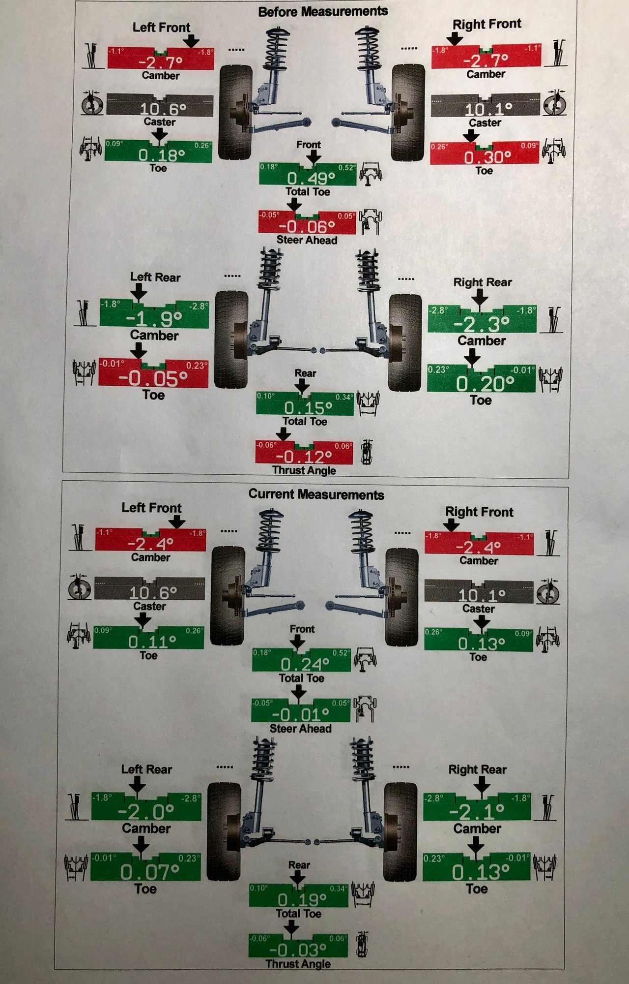

I just purchased K-Mac bushings for the front and rear that are being installed today. I’ve been wanting to correct my camber for a long time. However, looking at my alignment figures before this purchase, I noticed the manufacturer specified ranges are more aggressive in the rear than the front. This seems to go against my basic knowledge of alignment and camber. I would think it would be more beneficial to have a more aggressive range in the front than the rear. The recommended range for the front shows, (-1.1° - -1.8°) and (-1.8° - -2.8°) for the rear.
My goal is to get the fronts adjusted to (-1.5° - -1.8°), and (-1.0° - -1.5°) rears.
Any input would be much appreciated!
