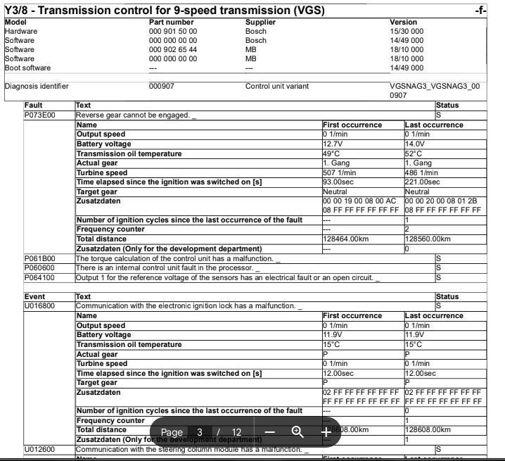

Here is a snippet of the scan data the dealer sent me. Funny that they also told me "both needed to be replaced" strictly based on the stored fault code from this scan. They did not bother to physically check the battery, or else they would have seen it was new. That makes me suspicious of their "diagnostic" capabilities. I hate to think this way but it seems like a tech has simply read some codes and guessed at what the problem could be.
the above Xentry does not read like a need to rush towards extensive repairs... let's not say dishonest, perhaps unexperienced factory trained technician.
Look closer at the report:
tranny is FREAKED OUT ON LOW VOLTAGE: 11.9Volts.
black on white report....
clear black on white report....
Unable to talk to CAN-Bus partners, it is unable to work and had to safely limp mode.
You have evidence it is not only the tranny module thats gone wild: the CAN-Bus network too.
This is an external issue caused by partners.
The solderless IGNITION SWITCH was reported nuts.
Tempering with tranny is mis-diagnosed.
The first fix is to correct the chassis LOW VOLTAGE soft-crashing VIP modules.
Your car may suffer from "drain by driving" regardless of once young battery.
