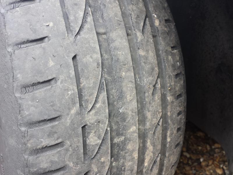

Try dedicated track tires like Michelin Pilot Sport Cup tires.
Pilot Super Sports are track-capable road tires whereas the Cup tires are meant for the track only.

I highly recommend the Michelin sport Cups or the Toyo R888
Agreed.
Or just buy a cheap 2nd hand set of track tyres for you to thrash around the track.
That's what I did and car was perfect.

Thanks for all the helpful info guys!
I'm going to get some dedicated track days, your right, no point messing about with street tires.
I'm currently running 235/35/19 at the front and 265/30/19 at the rear.
Was going to switch out to a 245/35/19 at the front, good move?

This is what my tires currently look like, I think I can kill them on the next track day before I swap, what do you reckon? Might get a bit of understeer lol they are bit on the edge. Will swap the fronts over as one seems to be worse than the other, probably due to mostly right hand bends:
Front left:
Front right:
Rear left (God I need an LSD!) - big chunking!
