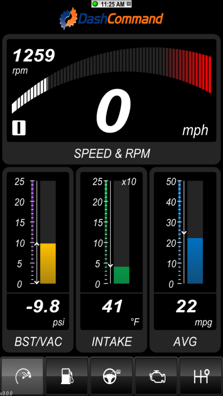

That is a nice option but if you don't have it as a original package it's my understanding that it is cost prohibitive to add it.
If you want something that is IMO just about as nice and has the ability to dump data to a spreadsheet get the DashCommand app for your iPhone/iPad or ? and add a wireless OBD2 reader.
That app provides very similar real time data that as mentioned can be data logged.
One note, if you use Apple products you'll need a bluetooth OBD2 reader. I use one called iCar.
Here are a few screenshots when I was testing it my Subie.
This app offers WAY more data than the AMG Performance Center.
For the best accelerometer data the phone needs to be firmly mounted.

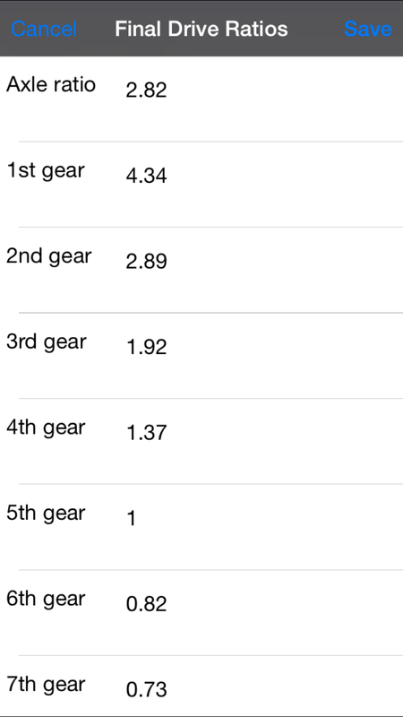

With a iPhone bluetooth is the way to collect data. With a Andriod I'm fairly sure both Bluetooth and Wifi work when paired with a wireless OBDII reader.
I use the iCar reader.
http://www.obdinnovations.com/vgate-...stics-scanner/
Also, if you haven't yet gotten the instructions.
Somewhat helpful.
http://www.palmerperformance.com/dow...ual.pdf#page15
Once set up enter transmission ratios and other vehicle specific data.
Your ratios should be.
