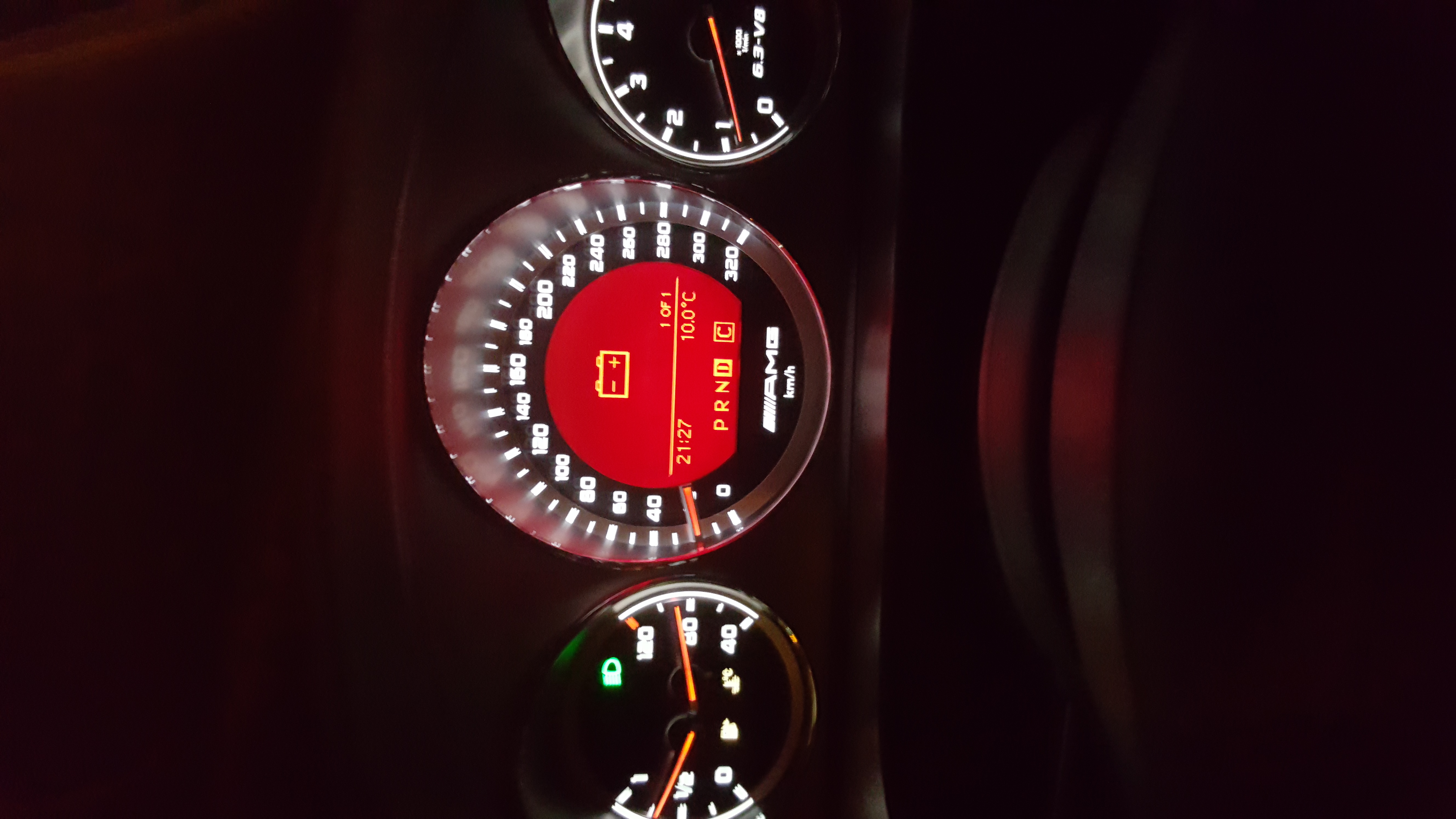

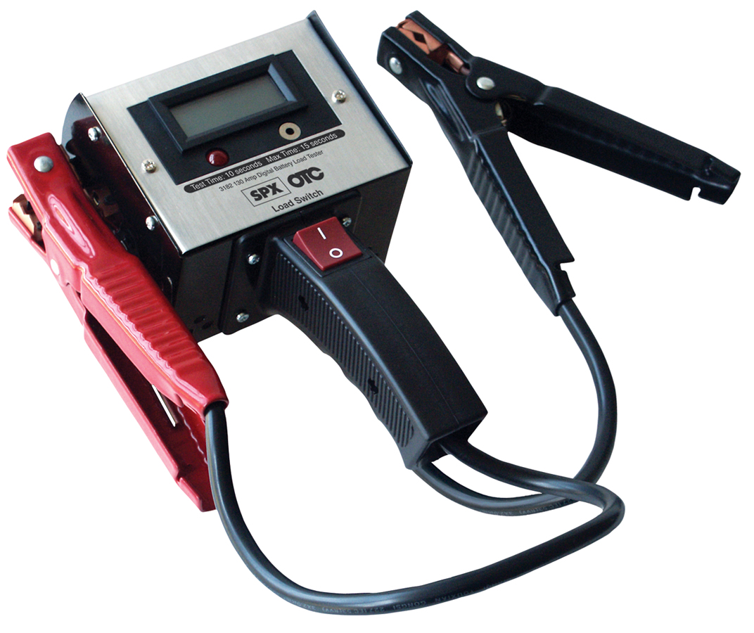

Help.....Cripes...
The car hadn't been started in a week and yet started up beautifully. After about 15 minutes of heavy traffic all at once my dash board light up red as seen in the diagram showing me the picture of a battery. I pushed the button "ok" and the red disappeared however was saved in the "service messages" section. My Bluetooth and radio LCD closed and the buttons surrounding the cd section turned off. I continued driving the car for another half hour until I returned home. I shut of the car and restarted. After 30 seconds the battery light lit up again. I have the tester seen below and the car tested as follows 1. The alternator tested ok (Diode Trio Functioning.) 2. Battery Load test was 11.3V (above 10V is good.) "Charging Test" after 10 seconds was 14.18V (between 13.5 and 15.5V is normal.) All of these readings look ok unless this is not applicable to Mercedes. I have had for the last two weeks a dash cam connected to the cigarette lighter even while the car is turned off; however, it shuts down when I turn off the engine. I was told that perhaps it is my secondary or auxiliary battery that caused this. Do I have one?
Guys my unit is stationed in the far east; dangerous to be stranded out. Please help
