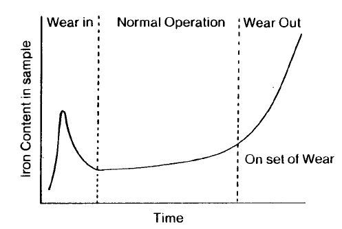

(A useful FYI from BobIsTheOilGuy forums). "It takes some amount of heat & pressure cycles to activate the anti-wear additives in the oil. The amount of wear has been quantified via radionuclide testing (RNT) while an engine is running. Until activation has taken place the wear rates go up. After the additives become active, wear rates decrease until the additives become depleted, as in this graph from an SAE paper on additive activation:
Prove it yourself: take an oil sample immediately after an oil change and every 500 miles afterwards. Dollars to doughnuts the UOAs will show wear rates (ppm/k mile) go up, then down & level off.
Changing your oil too frequently is a waste of money, resources, contributes to premature engine wear and is bad for the environment."
