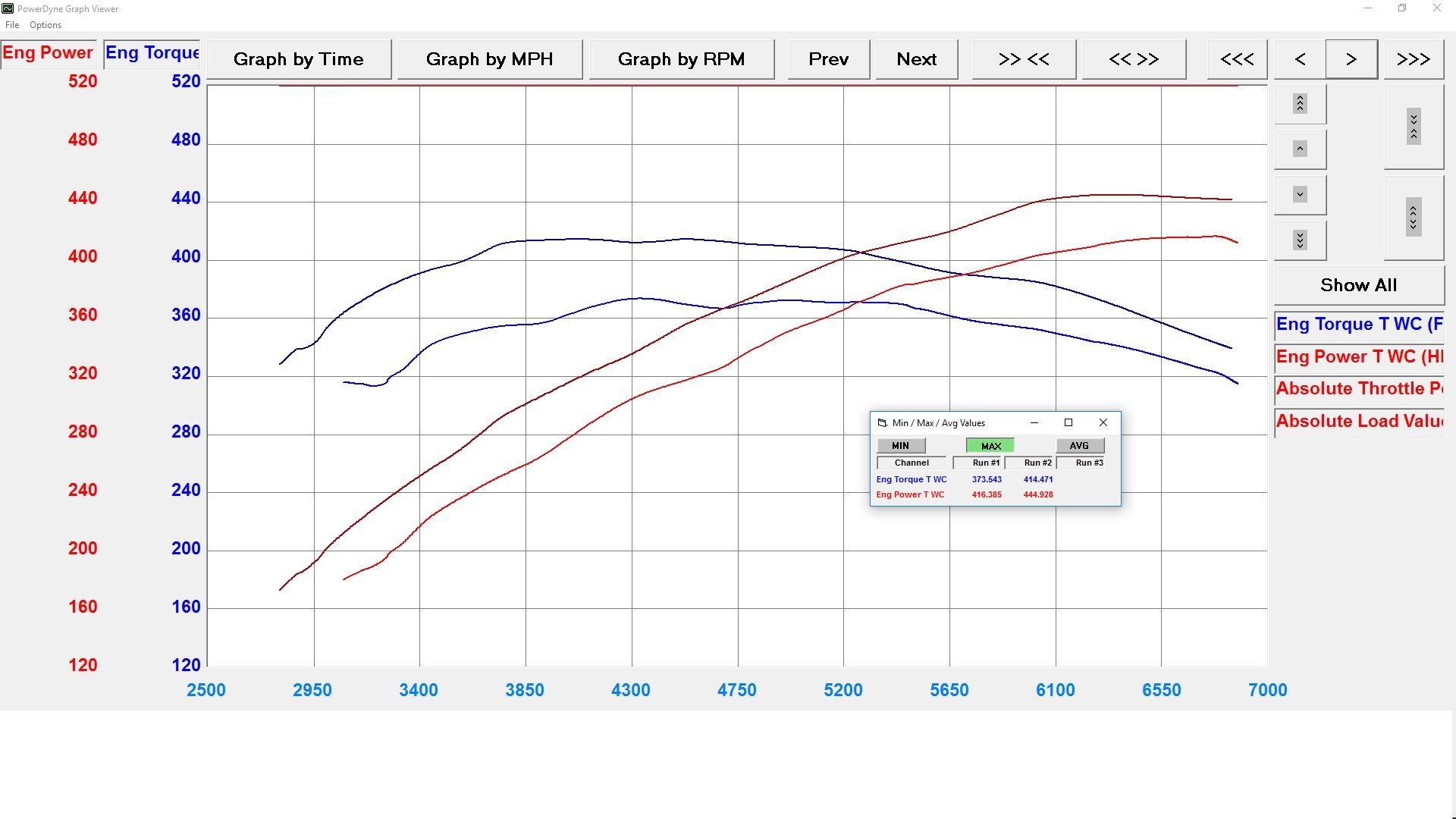

Not sure if pic is any good but dyno before header install was 416 whp 373 torque row boxes ,tune ,res delete sec cat delete ,with the headers installed went to 445 whp 414 torque gained 29 hp and 41 torque
car Def feels way more aggressive

Thats some crazy torque gains!

Gain all across the graph. Headers are def my next mod
