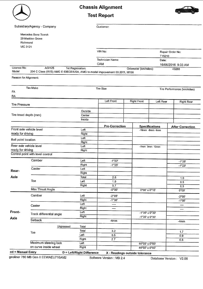

Hi guys,
Trying to resolve a slight vibration in the mornings under warranty, I've just recently had a wheel alignment done at my local Merc Dealer here in Australia.
After the alignment I asked for a printout of the results. Upon checking the results I found the Front Camber was not even from left to right .
The left reads -2.05 and the right reads -1.35.
How does the rest of the wheel alignment seem?
Any feedback is much appreciated as I want to research before going back to the dealership.
