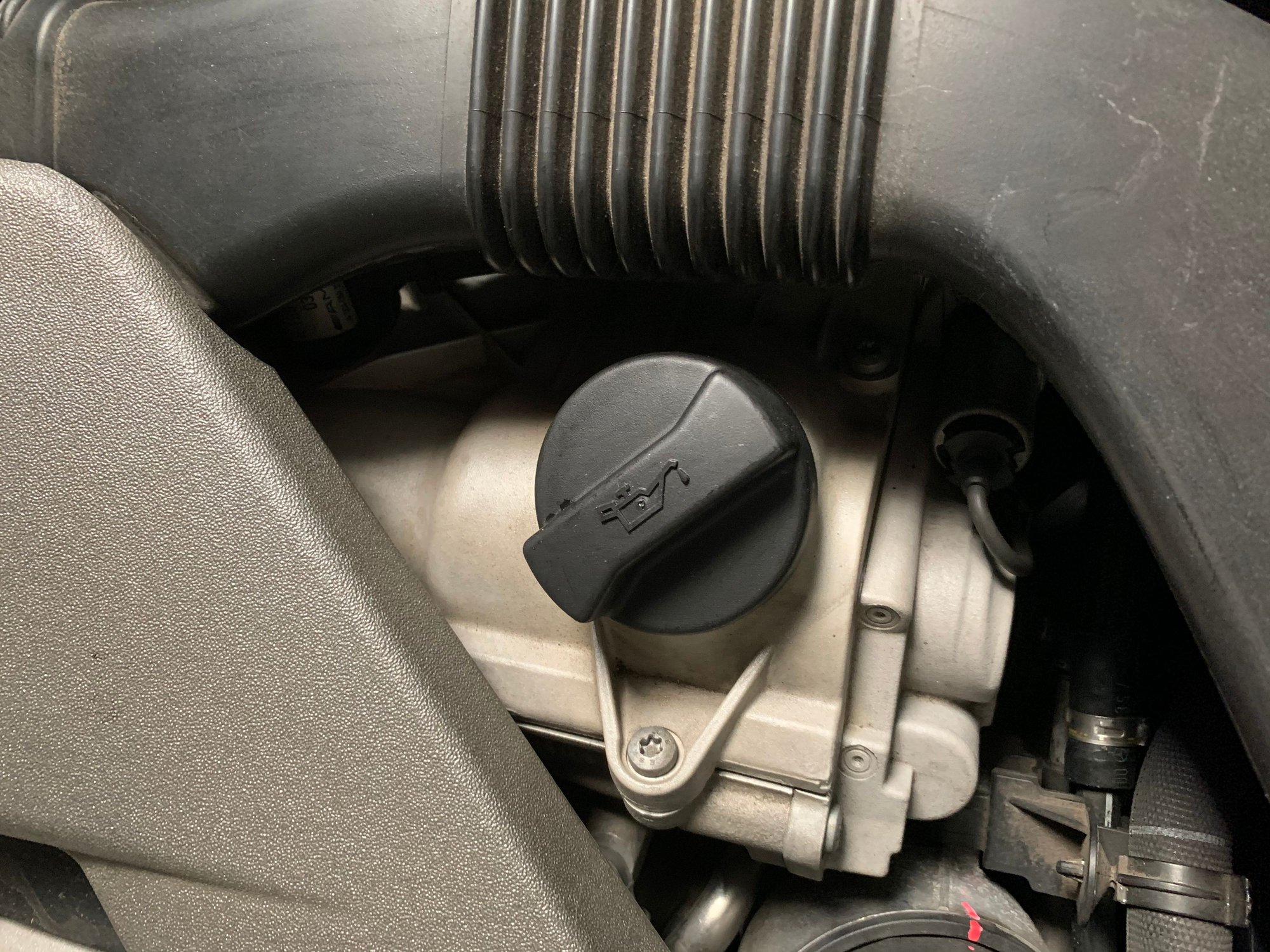

So, cold night, about to top off the oil and the cap broke in three like a cracker. One piece fill below, clear to the bottom.
I assume I can’t drive like this. Just put a rag and wrench on it to remove when I get a new cap? I clearly don’t want any plastic in there.

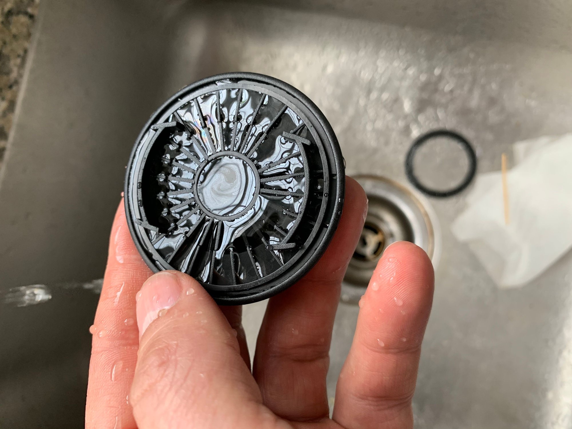

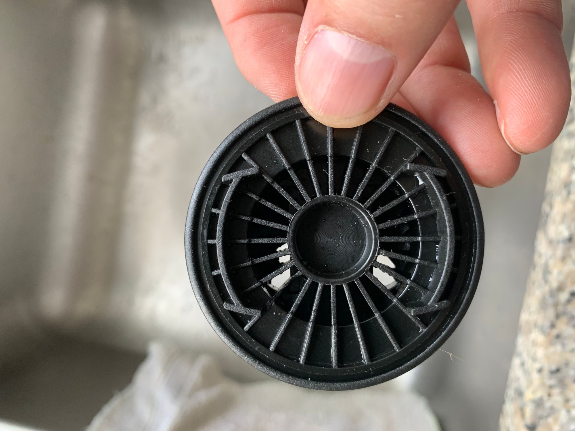

The edge of the cap is sealed with a rubber o ring, there is no hole in the plastic to vent or allow the engine to breathe. Doing so would make the car fail every emissions certification test in existence

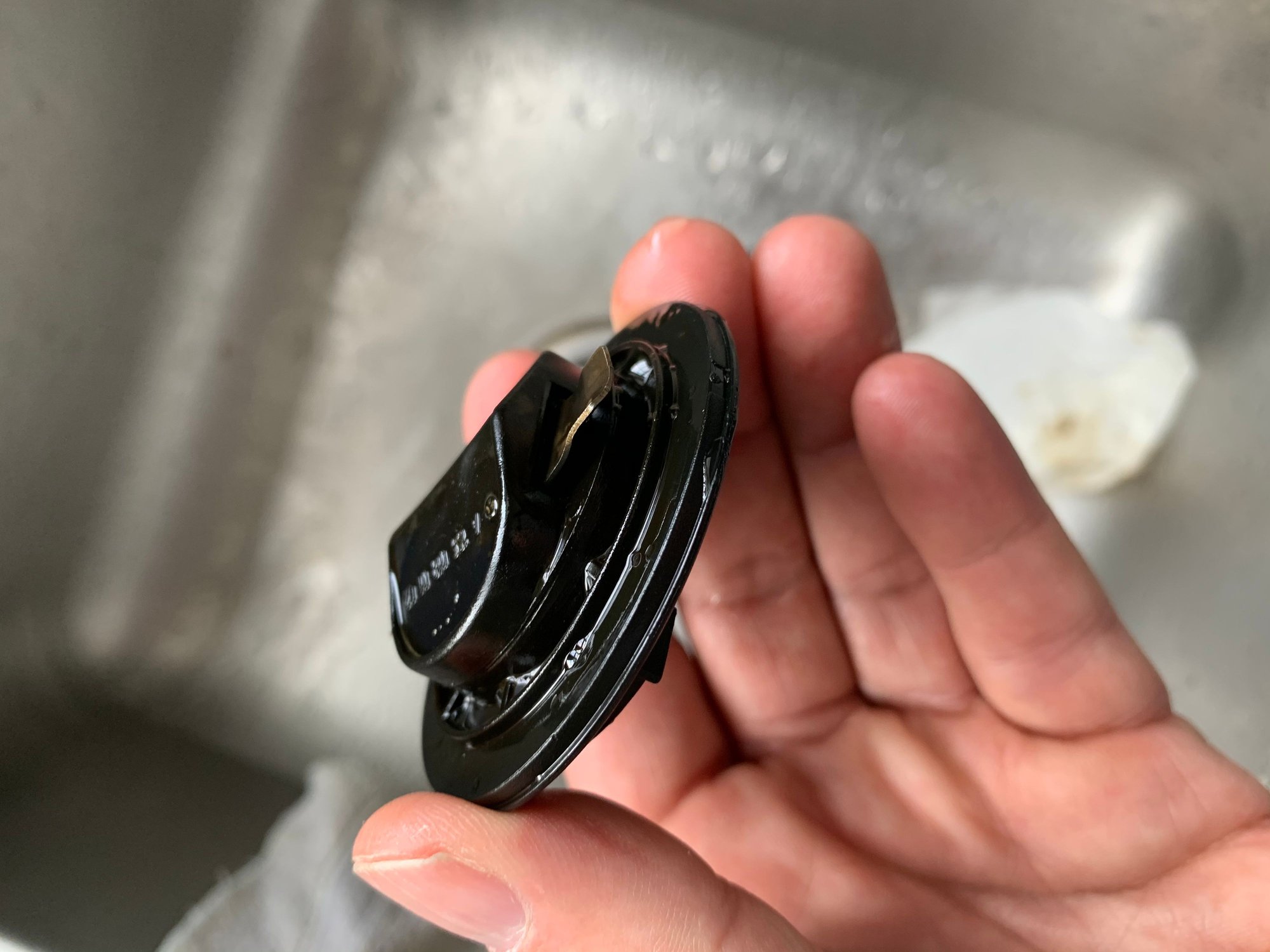

No holes... tested with water and ripped it apart. The holes you see in the one shot are only from the plastic I chiseled off the back.

If you had one with a hole, it was damaged.
