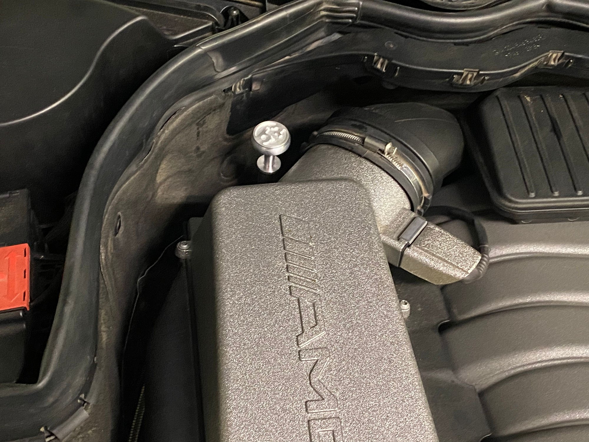

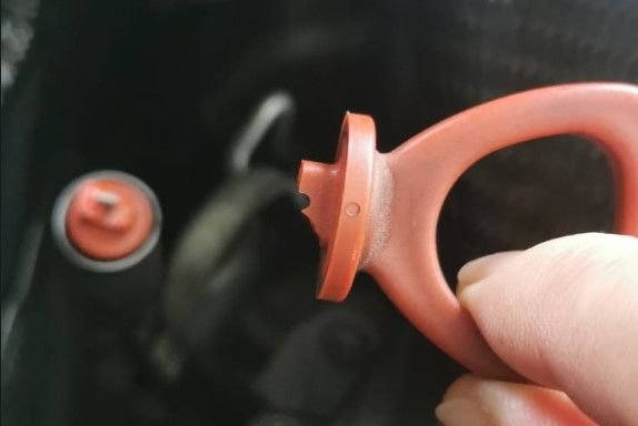

Here's the break of the plastic head of the dipstick.. i tried my luck to go to a local machine shop to replace the plastic top and get a weld on a custom ring as a replacement on top. Lets see how it is next week.

Wondering if the heat makes the plastic brittle over time and finally breaks when you grab the end.

Yeah, I wouldn't be surprised the accumulation of high heat for a decade in the engine bay have made the plastic brittle. Especially with yanking the dipstick out.
Anyways, here's what I managed to get done.. A custom metal weld replacement on the top of the dipstick and it works! A $15 job done.

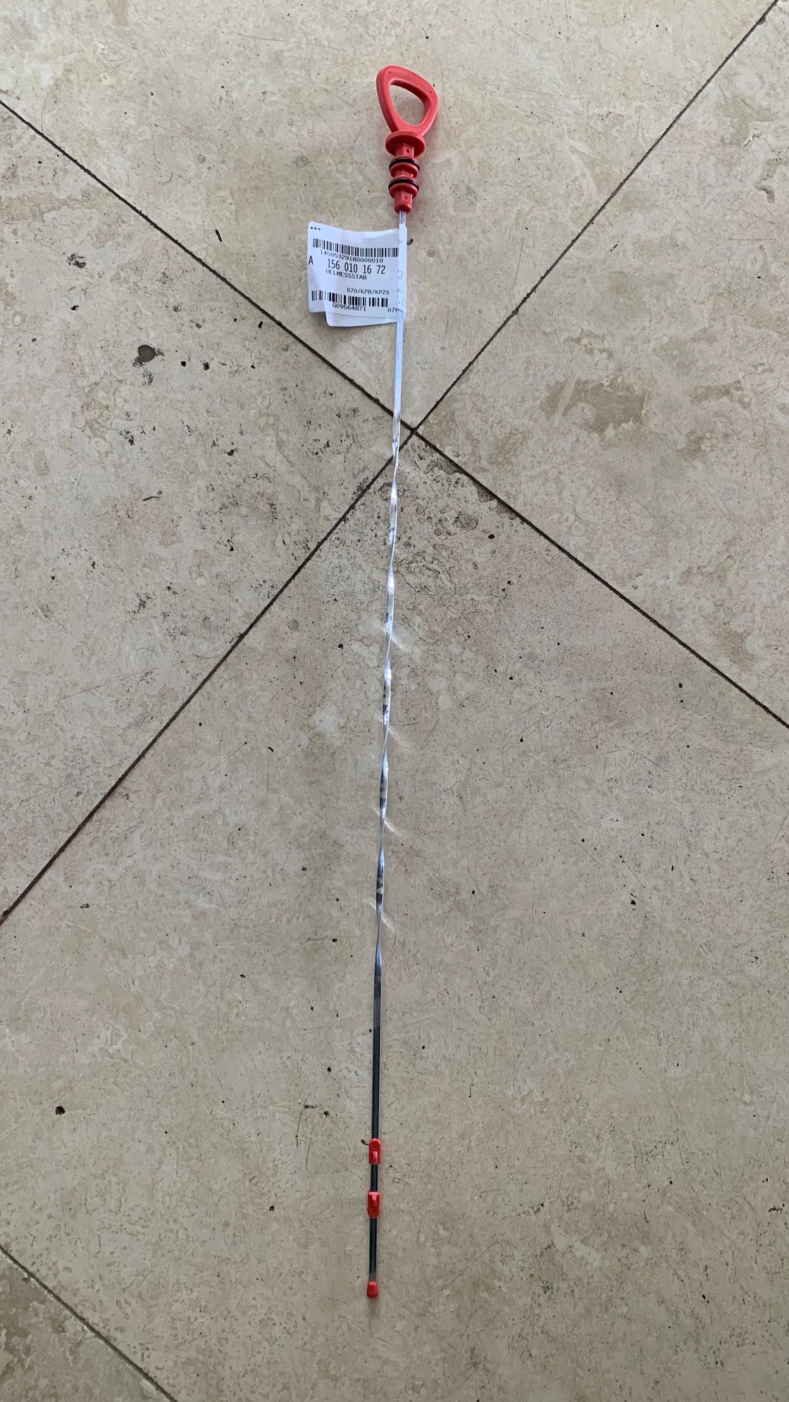

156 010 1672 is the correct part number for the engine oil dipstick that replaces 156 010 1772. I just ordered one today. Has to be ordered from Mercedes in Germany, takes about a week to arrive.

I was out of town but picked it up today. Here’s pictures of it and the part number
