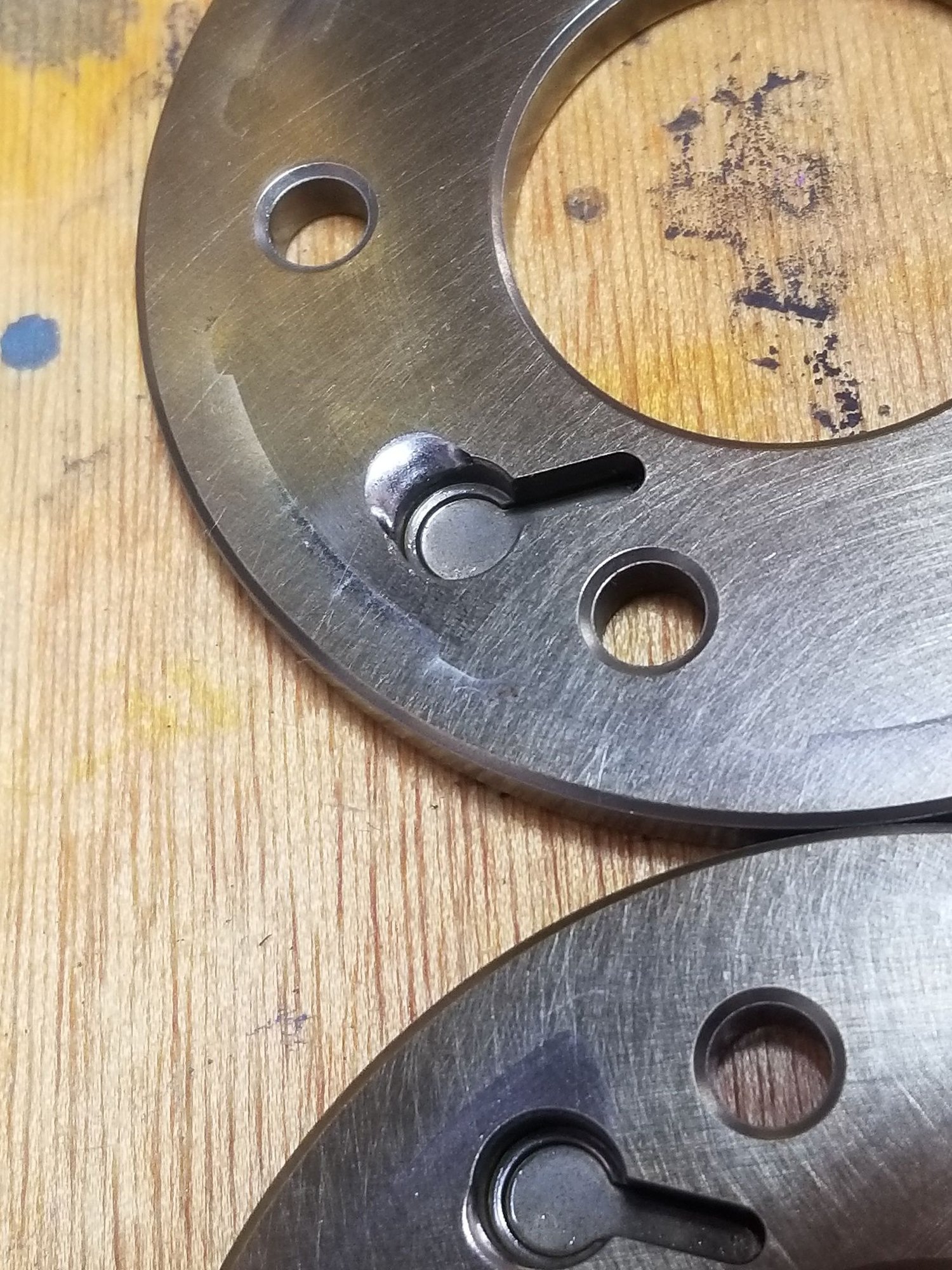

So today I managed to take apart another one of my adjusters. This time the driver side exhaust cam adjuster.
Upon opening up the adjuster and expecting to see a typical used up backplate, instead I find that THE SPRING AND THE PLASTIC PIECE ARE STRAIGHT UP MISSING! I was blown away by this but it also explains why the noise was always coming from the driver side when starting up my C63! I am 99.9% sure that no one has opened up these adjusters before, which means this car came like this FROM THE FACTORY! There has been no records of anyone doing this work before me, and the gaskets and bolts all seem original.
I am not sure if anyone else has seen this or if this has been reported before, but I wonder how widespread this might have been?
Now... by saying that. I have a replacement spring from 63motorsports but does anyone know where I can get the plastic piece that holds the spring in place? Should I just improvise and find something "close enough"?
Here is a picture after opening up the cam adjuster. You can clearly see that the pin has not damaged the backplate as much as it should, and that the upper plate is actually eaten up a lot more than the ones with a plastic piece. The pin slides perfectly into the groove of that plate.

That's really strange. I wondered that when I replaced mine, you get a new spring, but that little plastic part that lives in high heat most of it's life... how does that never get old/brittle and just crack or melt? This was my worst one around 72k miles:
At least you had all your springs in correctly lol
