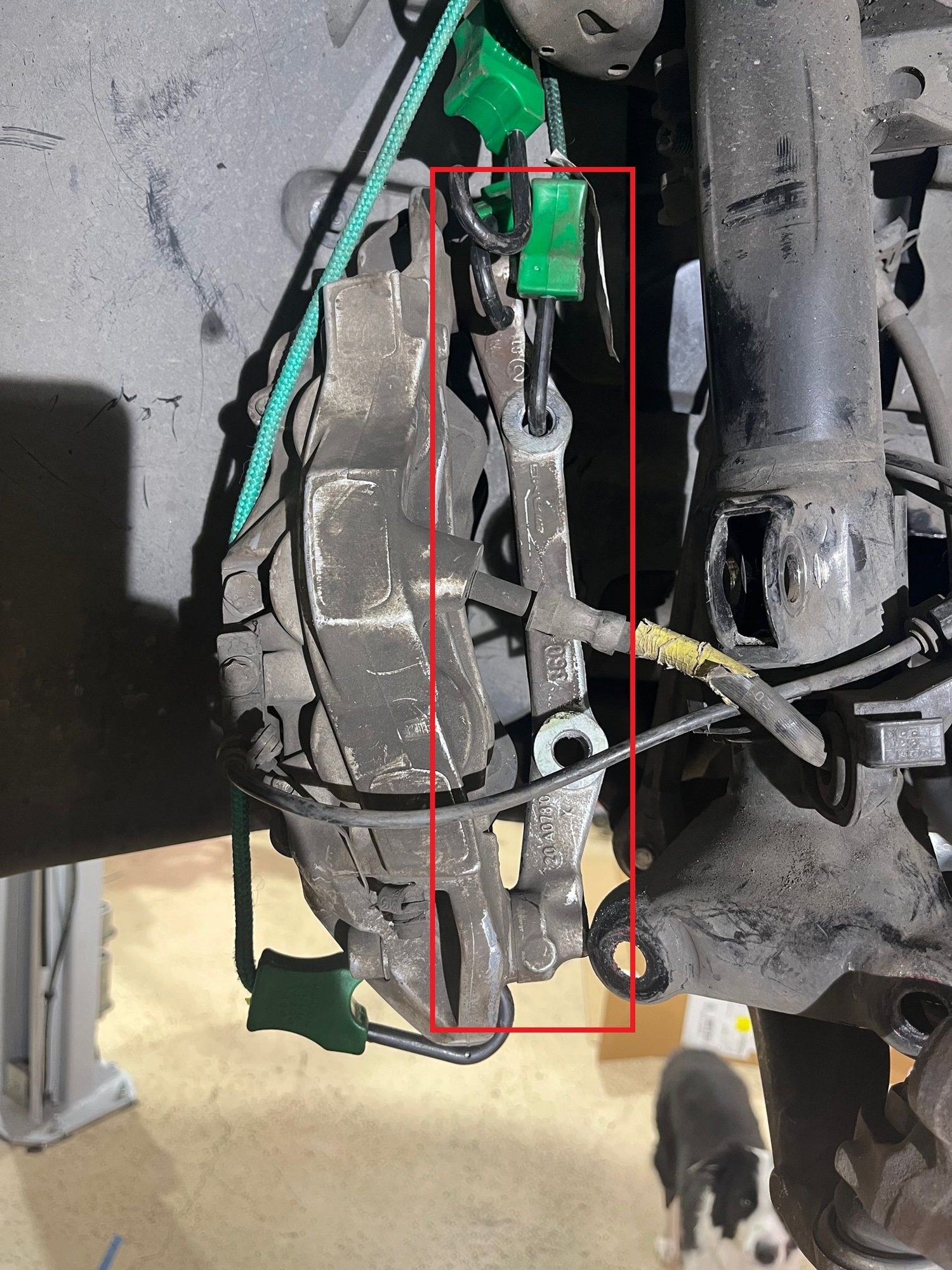

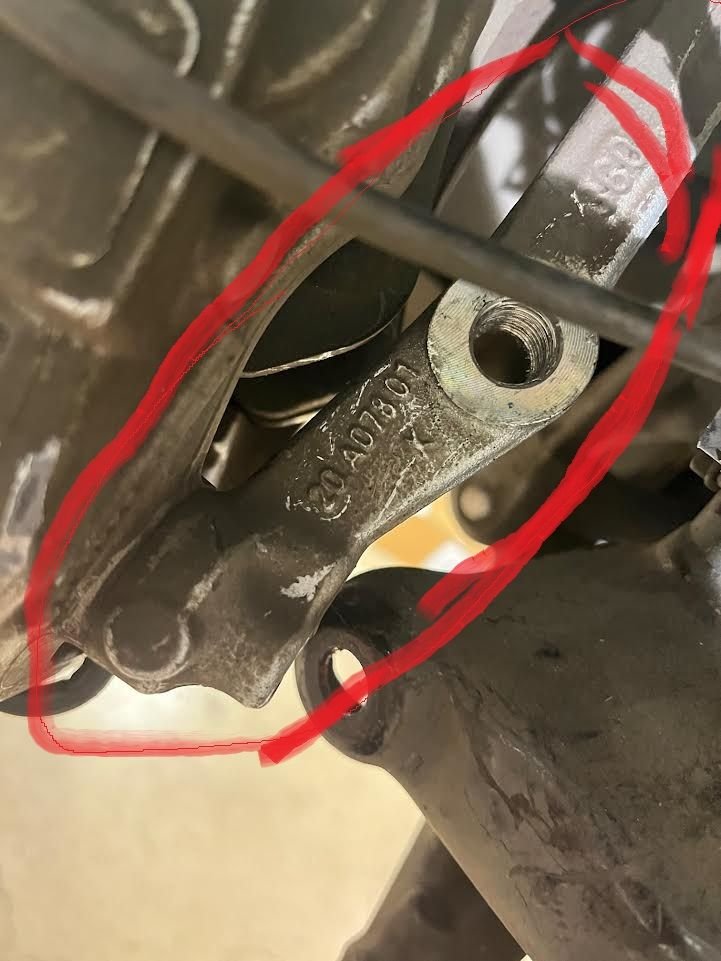

Hey Everyone,
Does anyone know where I can get the Caliper mounting bracket? the threads in mine seem to be all galled up and this is a pretty important safety part. Part number on it is 20A07801 but I cant find this anywhere or on the MB parts finder , any help would be appreciated.

I'm not an expert, but this has been talked about in the forums here a few times over the years.
Unfortunately, you are not going to find them sold alone because they only come with the complete kits. So there no part #.
Reference:
https://mbworld.org/forums/c-class-w...04-models.html
Also, be advised, the bolts for those mounts are 1-use only.
Reference: https://mbworld.org/forums/c63-amg-w...s-knuckle.html
