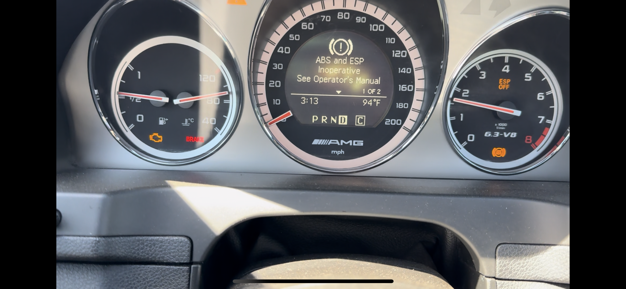

PROBLEM 2008 w204 c63 I have had multiple messages come up about ABS and ESP inoperative along with Cruise control inoperative and the car would lose power steering and shift rough, along with this every light possible will light up on the dash and the speedometer would stop working. I scanned the car and got a whole grocery list of fault codes some examples: 5629, 5130, 5130, 5506, 5542 and more.
Along with this the car does not read
MILEAGE SO DO NO DRIVE TOO MUCH

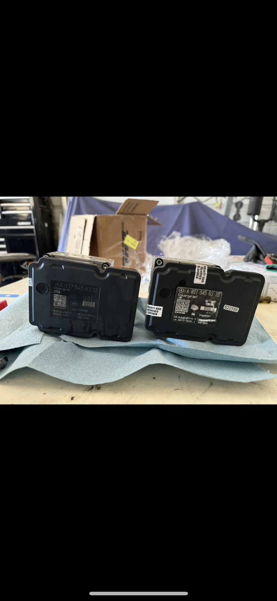

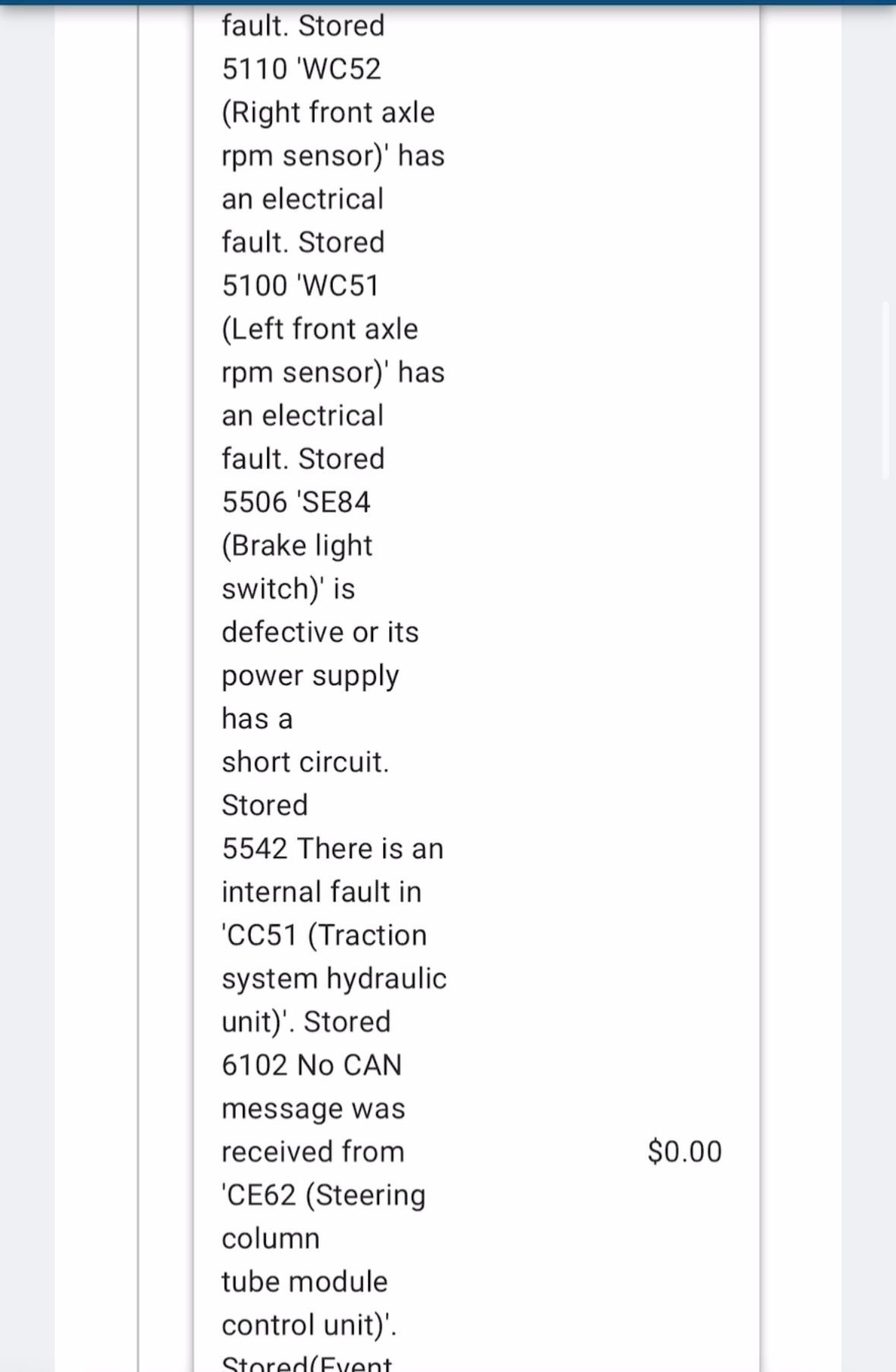

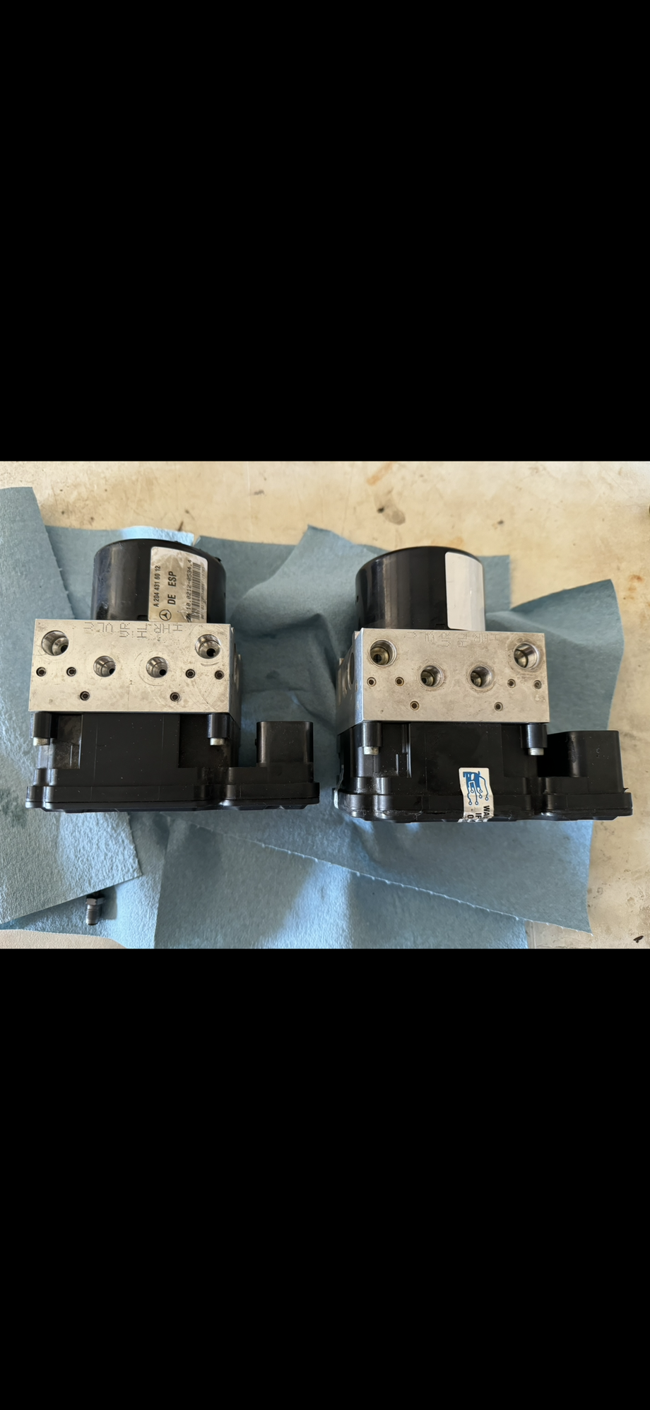

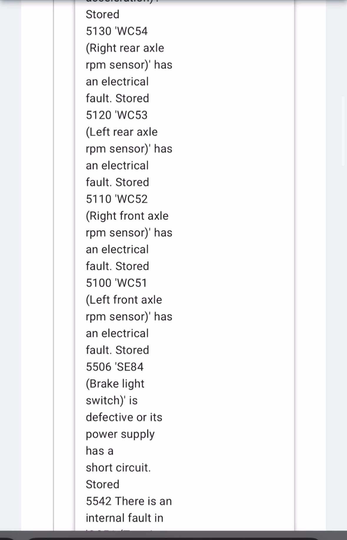

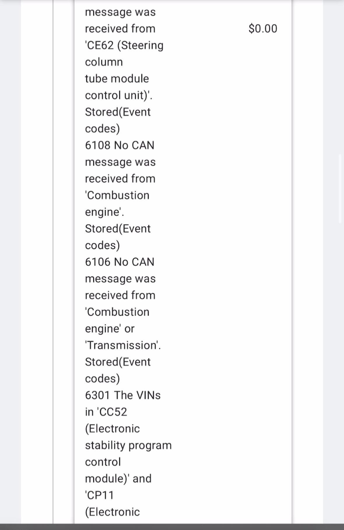

DIAGNOSING This issue would happen about 4 out of 10 drives and when it did happen it could take anywhere from 0-30 miles for the lights to turn on, I looked into forums and everyone with a similar issue would say it was a wheel speed sensor. Many of the forums have no real out come, the original poster would just say they would try a wheels speed sensor and never respond. With this I decided to plug my scanner in and read live data from my wheel speed sensors, all wheel speed sensors worked, but when the ABS UNAVAILABLE problem occurred the scanner would get kicked out and I would not be able to enter the ESP module with the scanner. Anyways I took a wheel speed sensor from my other car to test this and still no luck. With this and other problems like rough shifts and no power steering I decided it would be the ABS module. So I started to search for ABS modules and could not find anything available new or used, so my only option was to send it to a repair shop. I found a company in the UK called ECU TESTING and sent them my module. I am from California, USA so shipping cost me $210 usd and the repair was $370 usd. They had tested it and it came back normal but I still asked them to go ahead and repair all the common failures. From shipping it out it took 5 days to get it back. I installed it and the problem did not go away. This time I went to a well known euro shop to get it diagnosed, they concluded it to be the ABS module. All in all the rapair bill was $3,700 however no new ABS modules were available in the world. So I sent the module back to the UK to get warrantied. ECU TESTING paid for everything and once I got the module back I installed it. After installation it worked for 2 weeks then the problem came back. I decided to buy a used module even though I had read forums that said it could not be done as the modules coded VIN could not be removed. Through out the whole world there was only 2 modules available, so for the third try I ordered a Module all the way from Dubai, after tax it came out to $738 usd. I received the module and installed it. Everything was going good until I started the car and still had the problem.

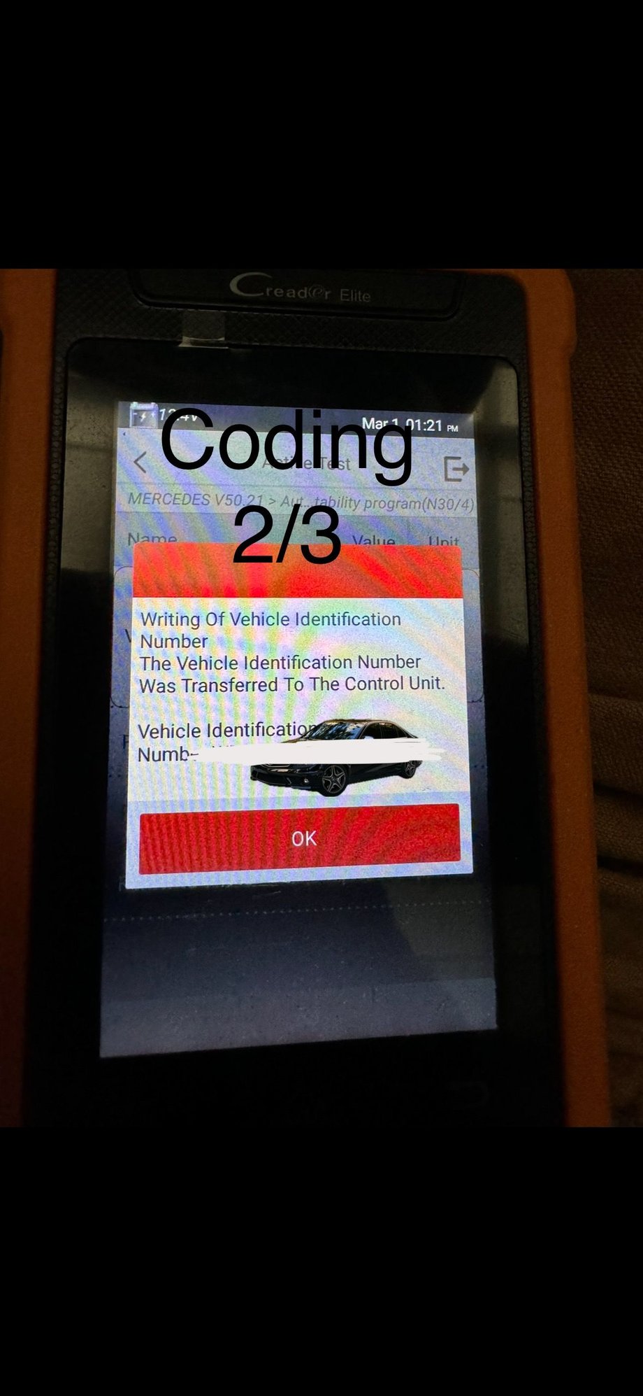

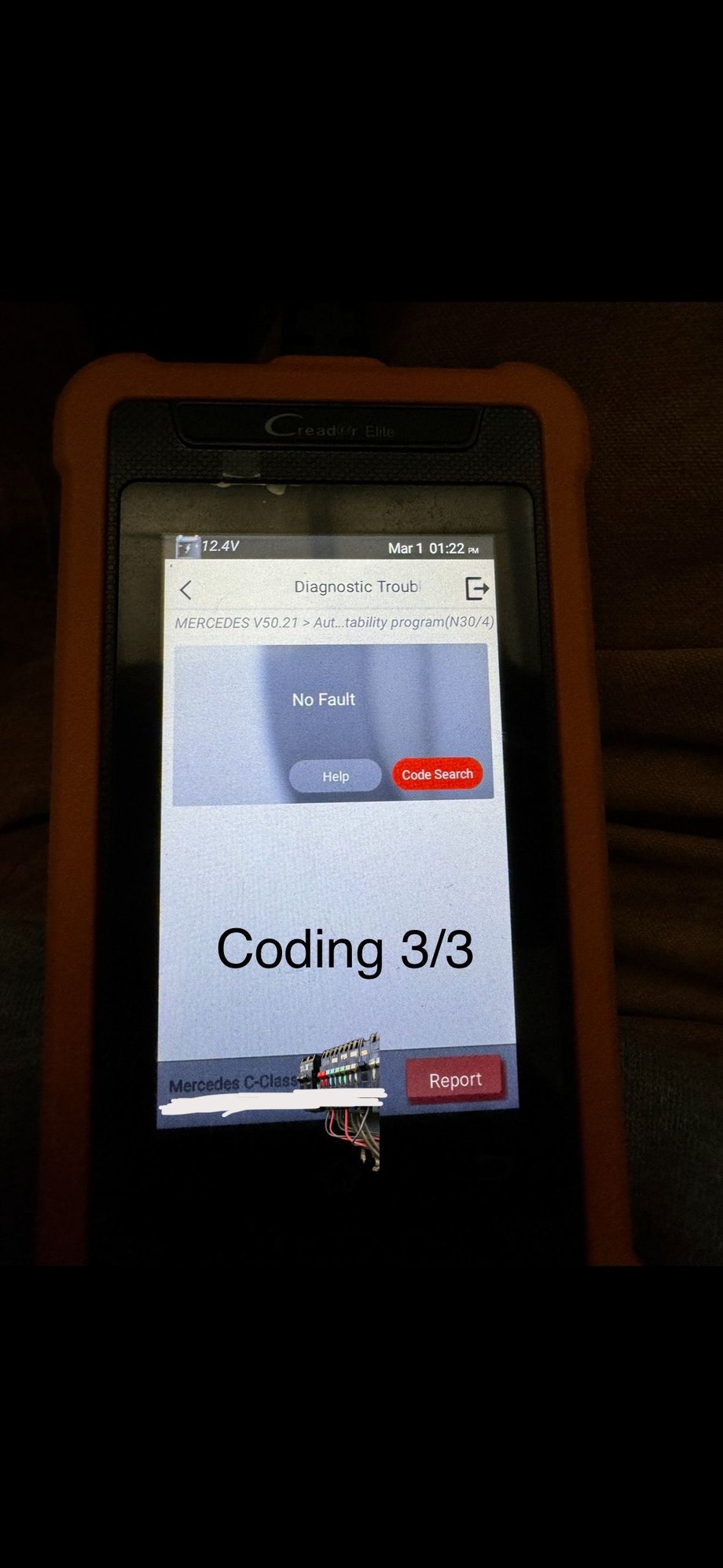

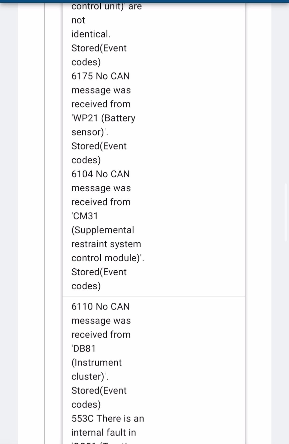

SOLUTION After having installed the used module I scanned the car for codes and found one about the ESP module not having the right VIN. I was able to enter the module with the scan tool and rewrite the VIN, I cleared the codes and turned the car on, after 7 months problem finally solved.
PART# preface lift A 037 545 63 32
THOUGHTS If you have the same issues with the same codes as me I would focus on the ABS module. Even though the repairs on my module done by ECU TESTING did not 100% work I would recommend them as they have very good customer service, pricing, and warranties their work along with giving me a refund after the warranty did not work. If you are thinking of repairing your MODULE I would recommend trying to find a used one as it might be cheaper.

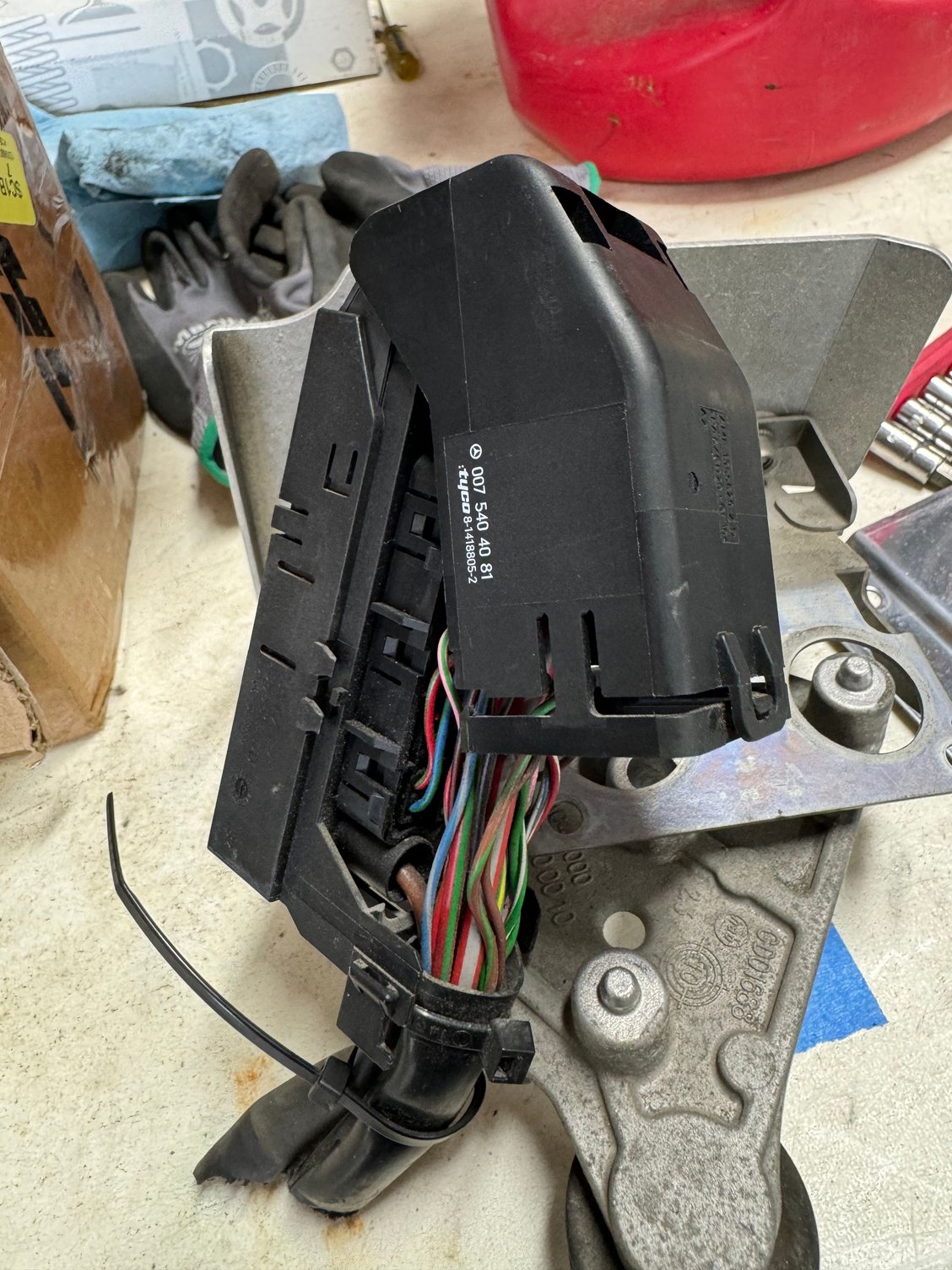

INSTALLATION First things first you have to disconnect the battery.
Remove brake fluid from reservoir. Or fluid will spill everywhere
Remove beauty cover from ABS PLUG

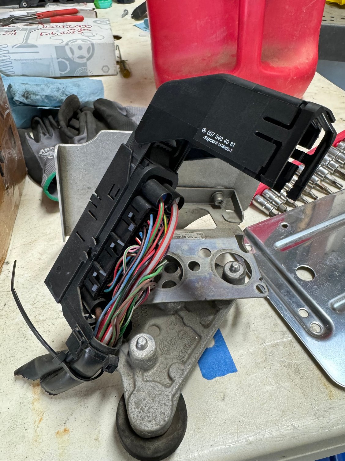

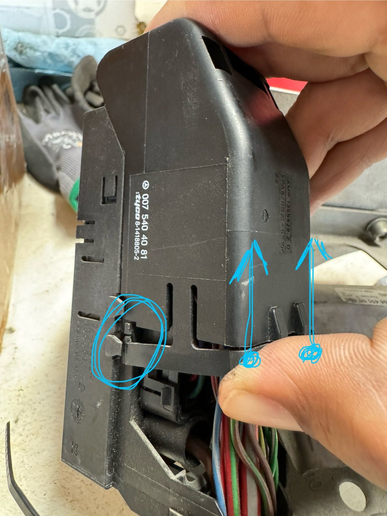

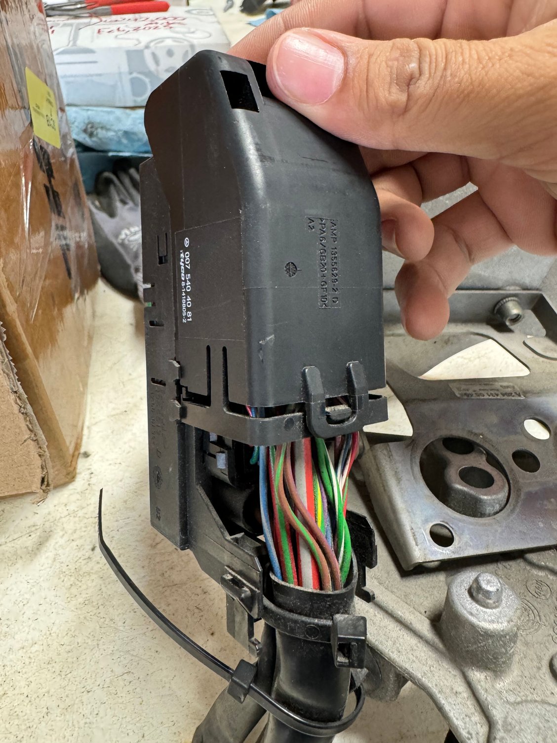

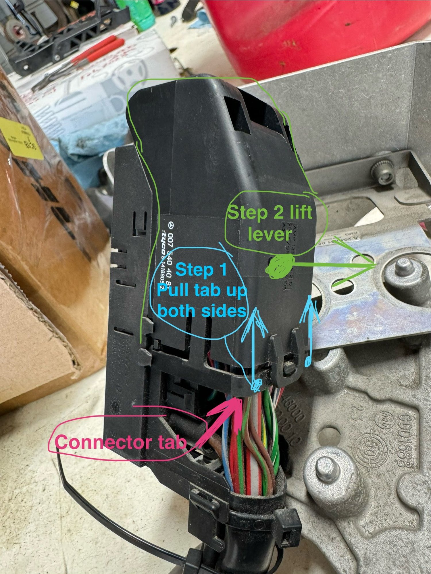

Undo connection to ABS module, this is tricky as it is a special plug that uses a lever to lock it in. push the bottom tab upwards and pull lever up PHOTO AVAILABLE
Remove Driver side wheel and wheel wells.
after removing these there is a Male torx bolt holding the ABS module to the bracket, remove it.

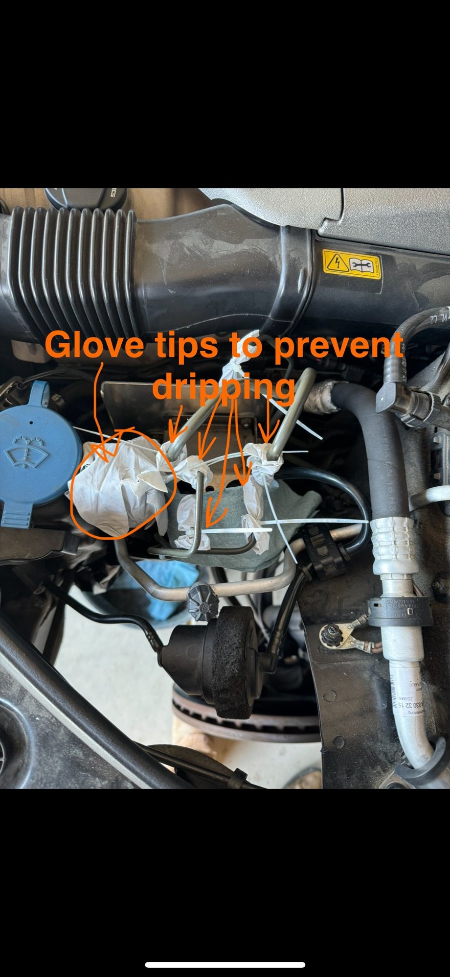

UNDO and set aside brake lines from the module one by one 11mm and 12mm wrench. TO AVOID SPILLS I recommend putting a glove over the connector and a towel in the plug to avoid fluid from ruining connections. Also stuff gaps around the module with rags. When removing brake lines, cover them with a cut off tip of a glove and secure the glove with a zip tie to prevent spillage.
Install new module and reinstall brake lines, fill brake fluid reservoir, install wheel wells and wheel.

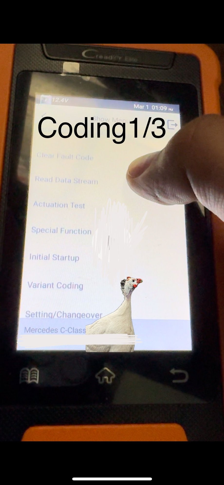

CODING If you do not own a scanner you can take your car to a mechanic for this
SELF CODING some photos available. All scanners are not the same but the general principle should apply. Go to systems, here there should be a list of modules such as ECU, TCU and others. SELECT ESP, from there search through the coding options, for me it was labeled as (Setting/Changeover or Initial Startup). From here the coding screen should show up. You should be able to see the modules current VIN and allow you to write your VIN, write your VIN and select write coding. Now you can clear all engine and module codes and you’re done.
