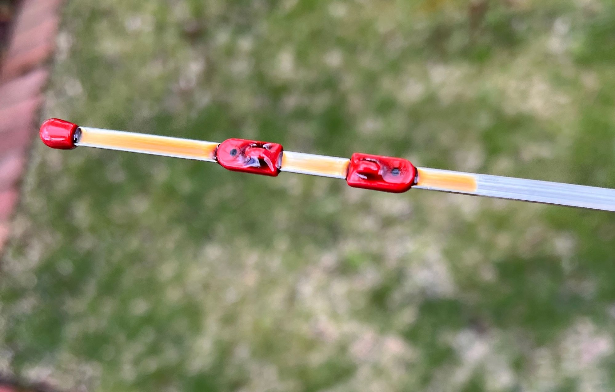

Slightly overfilled oil
I topped up my oil but it looks like I’ve put too much in. Is this a problem? Should I drain some of it? Will it cause any damage with this amount?
Drain some, at what time did you do this measure?
Photo was taken the day after topping up the oil. 5 mins after drviing i.e. the car was warm.

I would recommend draining some oil as well. It is not good to have the crankshaft dipping into the oil and frothing it up. If it is doing that it is not good for the engine or the oil. The engine does not need to be warm. Try to drain out about a quart/liter and see where that leaves the level. Easy enough to add some back if you think the level is too low.

Don’t drive the car like this. I would say it it more than a liter overfilled.
This often happen when you fill the factory spec amount (8,5l) without draining the oil cooler. If you only drain the oil pan, only 7,5 l are needed.
- Engine sitting level at operating temperature
- turn engine off
- wait five minutes
- Wipe dipstick clean and insert it slowly!!! while slightl wiggling the dipstickhead to avoid misreadings due to compressed air in the dipstick tube.
- take reading
I see then agree with other forum members, have some drained.

Get a Vevor fluid extractor or something similiar. It will make removing that 1/2 quart very easy. For $40 it will be nice to have for the future oil changes.

Yes take some out, these cars are picky on oil level and over filling is not good for them.
