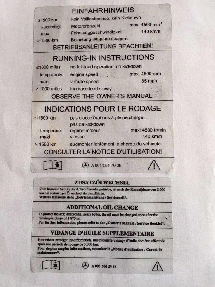

Old Jun 16, 2015 | 10:31 PM
toymerc's Avatar
Joined: May 2015
Posts: 23
AMG C63-S
This was left on my windshield when I picked up my C63S, I also bought PPM which I made sure covered this service.

17 C63 S Coupe
Yes, if you purchase PPM this is included. The technical mileage is at 1,875 but 1,500 works too. LOL
Thanks. I did not see this when I picked up my car! I will use this to show them wonder if they will allow this to be included with the PPM which I am going to purchase.
