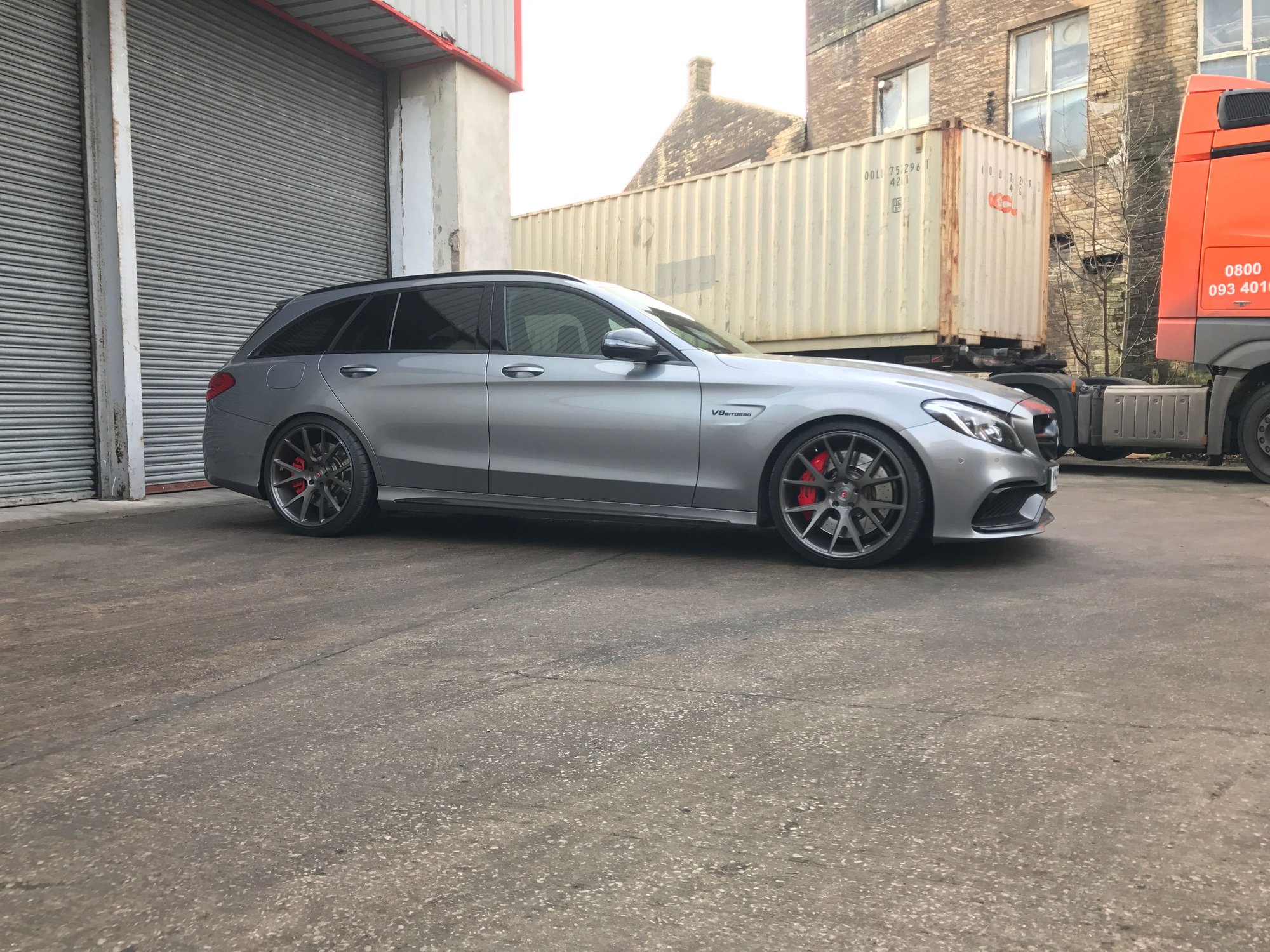

20x9 fronts and 20x10 rears with lowered suspension and no rubbing issues at all

gorgeous what side wall are your tires 30?

Also what offset are you? Looking at some custom and want a bit more well flush

255/30 fronts and 285/30 rears. I'm not 100% sure about the offsets. The rears are perfect but the fronts could probably do with being maybe 10mm wider. KW adjustable springs set at maximum drop on the rear and 2/3 drop on front

I removed my wheels today for a thorough clean and the offsets are engraved on the inner lips.
Front et38
rear et48
