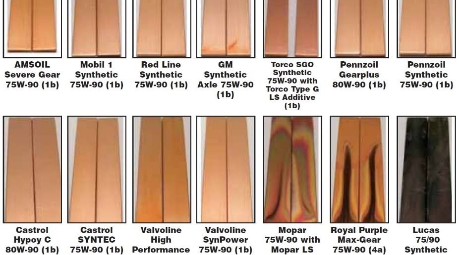

Are people using Mobil 1? Is the spec for 140 or 90? Generally, mixing the two viscs for your climate, power level and driving style is ideal.
Say the capacity is 1.5q, you could use a full quart of one and half of the other. I would try the 90 and top it off with 140.
Mobil 1 is impossible to beat. AMSoil is good, but pretty pointless. Same for Redline.
Stay away from Lucas, for god's sake. Royal Purple too.
