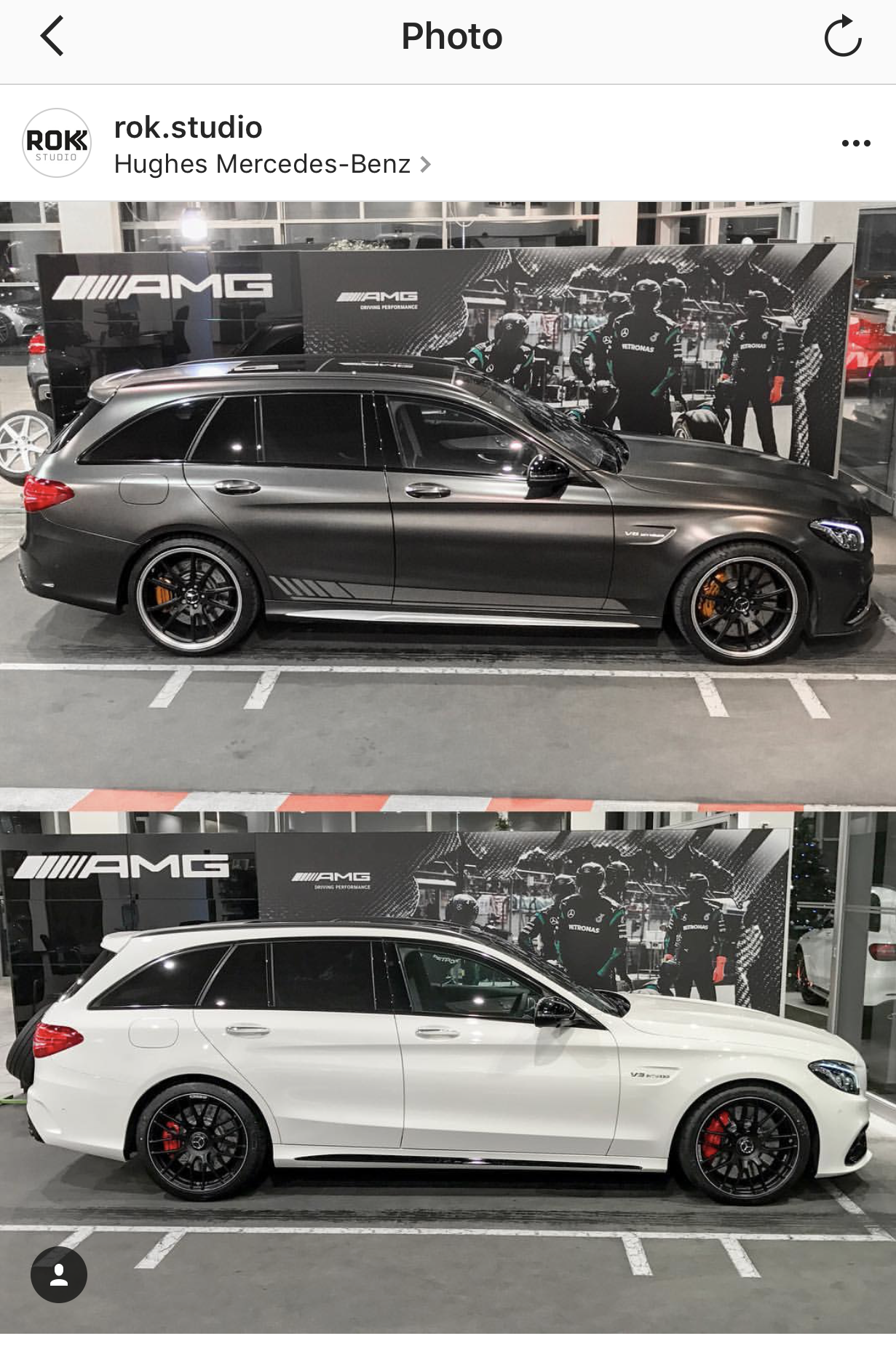

Originally Posted by MarkC63
Have you got any photos or your sedan? I didn't think the coupe rear wheels would fit. The offset is about the same as the sedan, but they are an inch wider. I thought about 15mm more poke was about as wide as you could go. Really interested in your setup.
Hi there, I'm worried about the same problem. saw a guy from Instagram put 19f/20r coupe rim on a c63 estate, I believe those rims have the exact same size, width and offset with the coupe cross spoke rims.
can somebody confirm that the 19/20 coupe rims work on the sedan??
