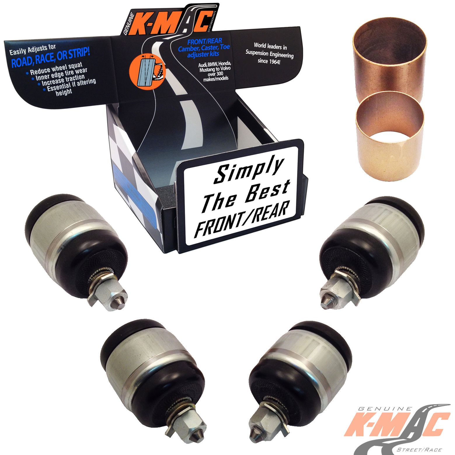

Only adjustment OEM on the rear (or front) is Toe/directional adjustment. No Camber to change tire contact angle.
We saw the need therefore to design, manufacture and reinstate from the early ‘90’s kits that provide “precise” adjustment (on car under load direct on alignment rack). Also replacing the 4 front and 4 rear highest wearing suspension bushings at the same time. Result is no more ongoing trips to dealers or alignment shops or constantly changing tire brands. Fixing it right…. the 1st time!
Precise adjustability for day to day commuting encountering high cambered roads, altered height through lowering, load carrying or suspension sag, fitting wide profile tires, curb knock damage.
Camber adjustment to reduce costly, premature edge tire wear, improve traction and track days – increase front Camber to reduce under steer allowing to go deeper into the corners with improved traction/braking response. Fine tune rear Camber also for maximum traction.
Front Caster to correctly resolve steering pull and improve brake and steering response.
The front bushings are 2 axis/self aligning but without the oil and air voids of OEM. Result is noticeably improved brake and steering response. No modifications to fit – come with instructions and extraction/insertion tubes.
Rear kits include additional Toe adjustment to compensate for the new Camber facility. Comes with bush extraction tool allowing the Camber bushes to be installed on vehicle.
Also manufactured for the rear suspension is a full set of 12 replacement bushings for the 6 multi link arms. Providing significant improvement to rear end stability. Less flex/twitch, increased traction especially when applying power lane changing/overtaking.
W205
Front Camber and Caster
C400/C450/C43/S63 AMG 4matic #503216K $480
C63/S, S63/S65 AMG #503316K $480
Rear Camber (and extra Toe) #502226K $480
Rear multilink arms performance bush kit #502628K $480
Delivery $30 one kit or $50 front and rear (average delivery time is 3 to 4 days). We accept Visa, MasterCard or PayPal.

Can you even try to be relevant? Jeez, doing business with you must be painful.
