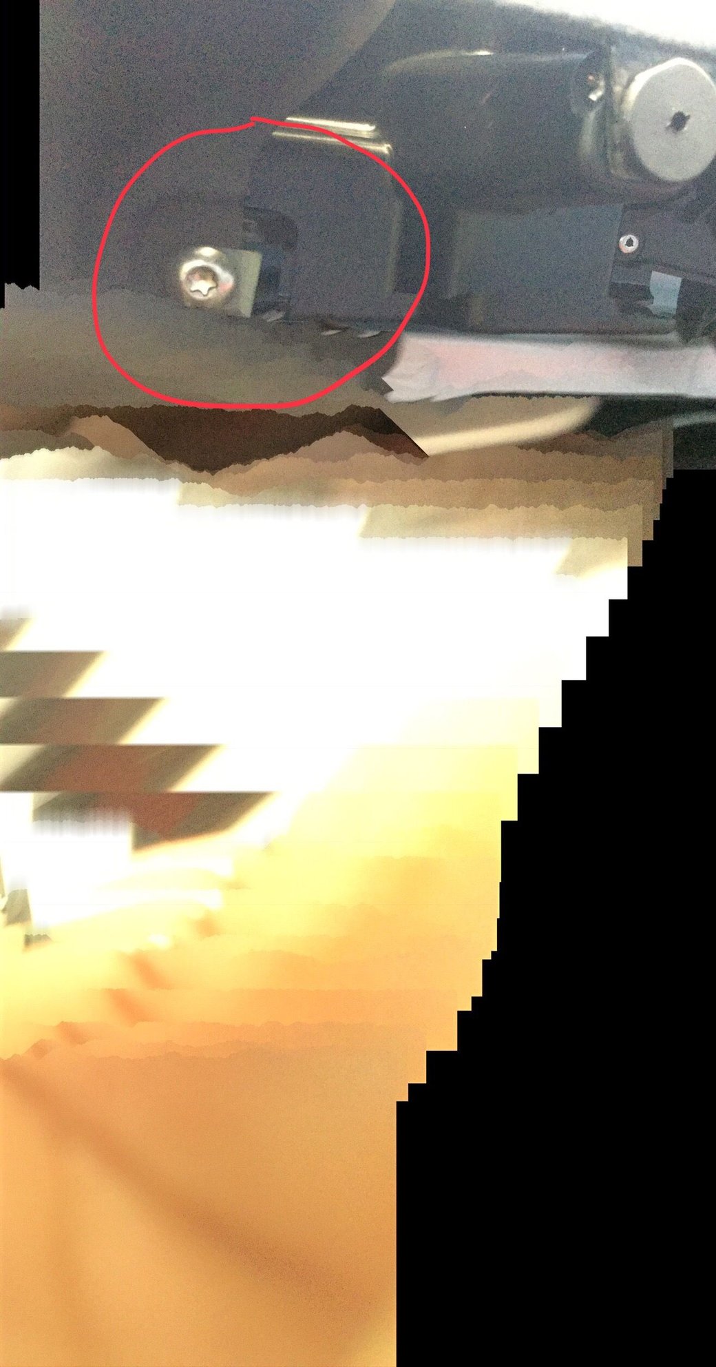

Did you check/tighten the exhaust hex nuts that hold the exhaust tips in place...mine raddled when I failed to tight them after I installed the CF diffuser.

Hey Art,
thanks for reply but I don't this is my problem. I believe my exhaust is deficient as many in the 17 C63s and early model GTS owners also had this issue. There was a bulletin at some point but I can't find it. The only "solution" I've been offered was lubrating the valves which was temporary and possibly cutting power to ECU which had me running out of the dealer real quick!
