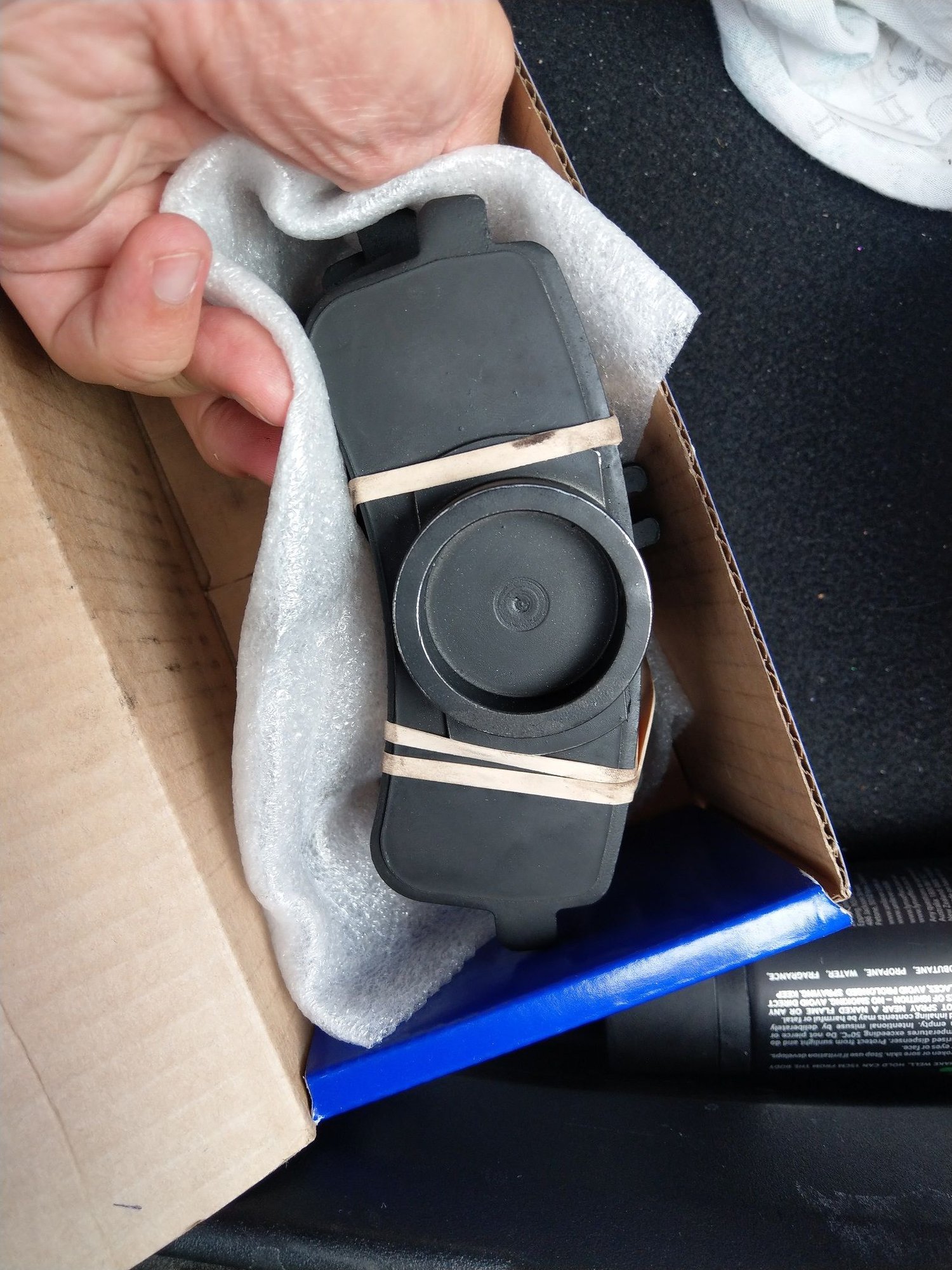

Took them to get them installed and left the car there for the day. Got a call later saying they haven't done it yet since they think it's the wrong brakes and it looks like it won't fit because they didn't want to charge me for not installing brakes if it didn't fit. See attached photos. Are these the correct rear brakes?

Hmmm mine didn't have the circle looking thing.

hmm, THIS website shows there are circles/rings on them, but not a couple others have said no ring.
I've emailed the supplier so waiting to see what they say.
Is this what you have?

mine had the rings if I remember correct and went in ok .We thought the same thing too but they fit

Yes, those are 100% correct.

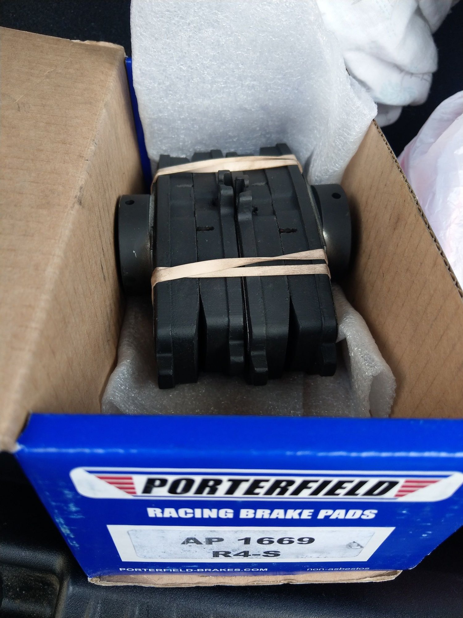

Mine looks like this.

this is what mine looked like also and I only did the rears no rings----the number was 1669 and I ordered directly from Porterfield.
I would call them direct and ask as they are very knowledgeable on phone.

So got them fitted and it does fit. Mechanic said there was space for those rings to fit in but looks like the space wasn't made for those rings to fit? Weird.

Can you please show me where that thread was about the rear RS4 brakes pads with and without the bumped circle extensions welded on the outer pad?
Did they later remove them from later inventory, since Porterfield's current website diagram for that AP1669 RS4 pad doesn't show those circled bump outs.
