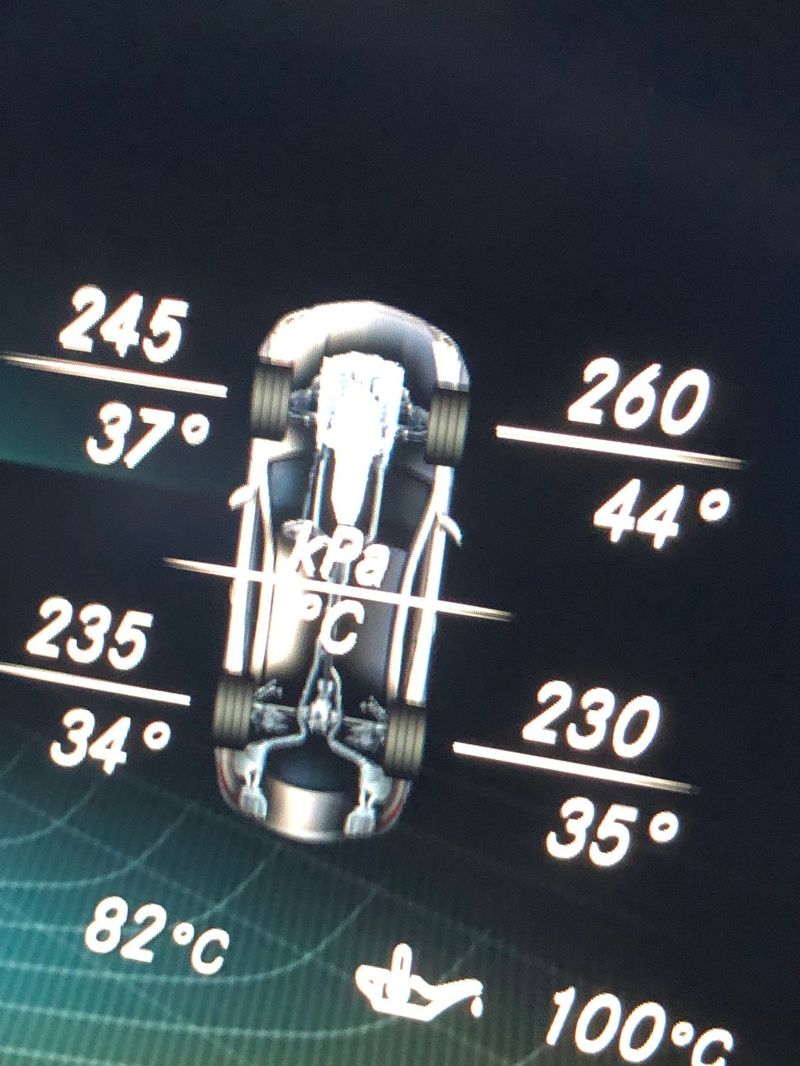

This is after a normal 30-40 minute drive home from work. Any ideas? Hotter front right/driver side.
Old 06-11-2019, 02:41 AM
superswiss's Avatar
Join Date: Nov 2018
Location: San Francisco Bay Area
Posts: 8,058
Received 3,640 Likes on 2,435 Posts
2019 C63CS
Yes that's what we are all seeing on our cars. So far it appears to be normal.
